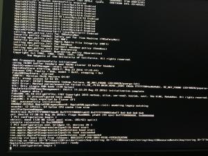

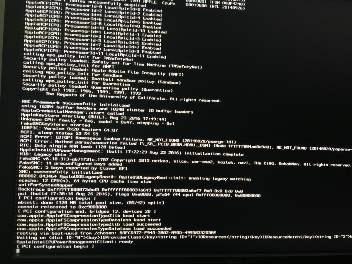

ekwipt Posted September 7, 2016 Share Posted September 7, 2016 (edited) hi Micky1979, I tried to use you patch but it KP my machine, previosly I had PikerAlpha, patches manually entered in config.plist, i deleted, them ran your NVME tool, copied the patch over, restarted, KP. Am i also supposed to copy over the data created by the NVME tool in the config.plist as well as the kext If so, what's the point, should i rather just continue using the manual patches made by Pikeralpha The KP maybe due to the fact i didn't enter the cpuid into the kext plist, I wasn't sure where to enter this, could you please spell this out for me thanks for your work, greta tool i'm sure when i can get it to work TIA Edited September 7, 2016 by Allan Clean Link to comment Share on other sites More sharing options...

Micky1979 Posted September 7, 2016 Author Share Posted September 7, 2016 ok thanks, then it crashes my sytem Patches are the same and I've tested it with the Samsung 950Pro nvme (same as your as per your signature), so I wonder if you did something wrong? be sure you don't have any other patches in Clover for IONVMEFamily be sure you have the original IONVMEFamily.kext in /S/L/E be sure (just in the case) to not have the patched kext still prelinked, i.e. rebuild permissions and kexts and reboot. A ioreg is appreciated to look at your class code, and pict of the kp too (otherwise how can I tell something??) Link to comment Share on other sites More sharing options...

ekwipt Posted September 12, 2016 Share Posted September 12, 2016 Patches are the same and I've tested it with the Samsung 950Pro nvme (same as your as per your signature), so I wonder if you did something wrong? be sure you don't have any other patches in Clover for IONVMEFamily be sure you have the original IONVMEFamily.kext in /S/L/E be sure (just in the case) to not have the patched kext still prelinked, i.e. rebuild permissions and kexts and reboot. A ioreg is appreciated to look at your class code, and pict of the kp too (otherwise how can I tell something??) Thanks Micky1979, no other patches in Clover for IONVMEfamily, i just installed the Sierra Beta 7 so everything would be vanilla, and i rebuilt the permission and kexts usingKext Utility. Not sure if the Crash screen is enough for you sorry Here is my ioreg: ekwipt Mac Pro.zip Link to comment Share on other sites More sharing options...

Micky1979 Posted September 12, 2016 Author Share Posted September 12, 2016 ok... whats the problem then I do have other issues with the hack but when i use the patches directly in kext to patch in clover, i can see my NVMe drive and it is shown as internal Not sure, but it says "PCI Configuration begin", try to add npci=0x2000 (or npci=0x3000) under "Arguments". By chance, can you tryto install patched kext in SLE (repair permission + rebuild cache)? 1 Link to comment Share on other sites More sharing options...
