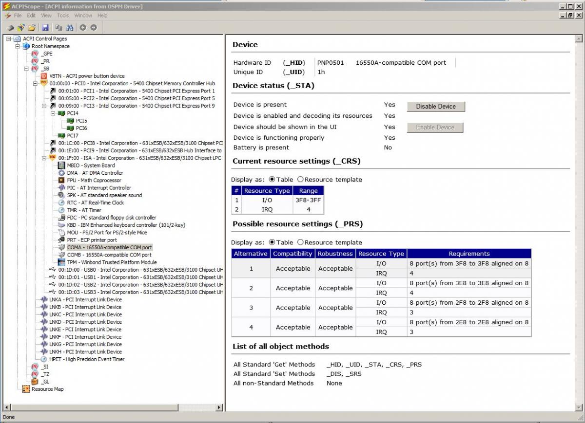

I saw this code in the DSDT, and I want to know my firewire address to change it. Do you know how can I do it?
// shdw - BEG : FRWR Device injection (was not there in original DSDT), as per info @ https://www.root86.com/topic/3193-firewire-asus-m3a79-t/
                Device (FRWR)  // shdw - lspci output : 37:05.0 FireWire (IEEE 1394) [0c00]: Agere Systems FW322/323 [11c1:5811] (rev 70)
                    Name (_ADR, 0x37050000)  // My firewire address reported by 'lspci -n'
                    Name (_GPE, 0x1A)
                    Method (_DSM, 4, NotSerialized)  // _DSM: Device-Specific Method
                        Store (Package (0x06)
                            "built-in",
                            Buffer (One)
                                 0x01
                            "fwhub",
                            Buffer (0x04)
                                0x00, 0x00, 0x00, 0x00
                            "device-id",
                            Buffer (0x04)
                                0x11, 0x58, 0x00, 0x00  // Board device ID is [5811]
                        }, Local0)
                        Return (Local0)

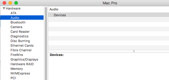

Hey all.  Having issues as well installing 10.12.4 on Z820.  Stuck at steps VII.E/F.  Audio is not being recognized.  USB is funky (USB3 ports detected as USB2 and USB2 ports are no worky).  I'm ok if USB2 ports don't work (I have a spare USB3 hub) but not having full speed USB3 kinda sucks.  LSI-2038 causes immediate reboot on kext help b7 install.  Won't boot on it's own afterwards with several different errors (sometimes a crash in the Astek drivers, othertimes elsewhere).  Booting into Recovery Mode, I can delete AstekFusion*.kext from /S/L/E and then rebuild kextcache.  And that gets me booting again.  Is there something I'm doing obviously wrong in DSDT or config.plist?
Also, wouldn't boot with nvda_drv=1 though I have latest nVidia Web Driver & CUDA Driver installed.  IPIC, TIMR, RTC had different IRQ numbers (2, 0, 8, respectively) but deleted them anyways.  Fix HPET also causes random boot issues and compilation issues.

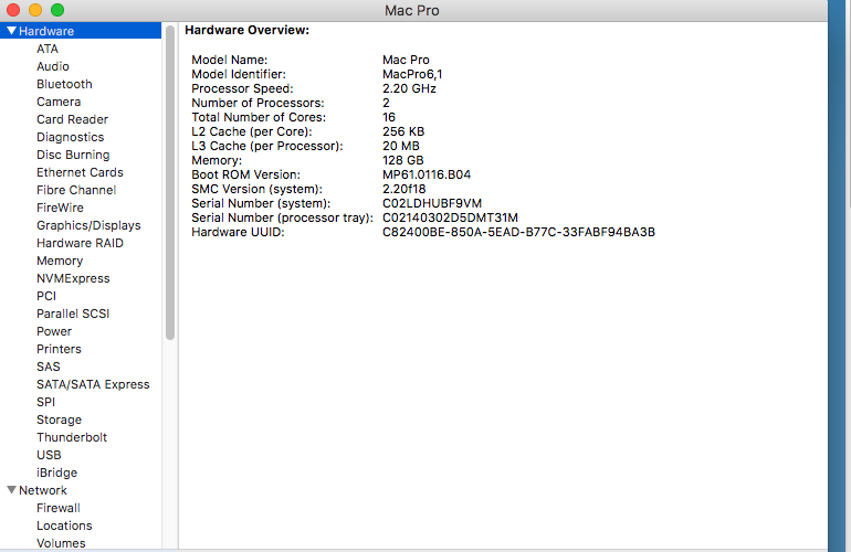

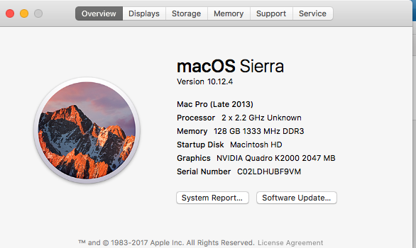

In general, I followed the guide, especially instructions about DSDT/SSDT. I hope it is obvious from the picture that I did it on Sierra, not El Capitan. I don't use raid, only a single Samsung SSD for target install and HDD instead of USB stick.
BIOS version = 2.15.1229
Clover version = 2.4k rev 4077
DSDT/SSDT/config.plist in the attached file
The system is very stable, everything works great (all software I use, for example: LightWave 3D, Cinema 4D, RealFlow, FinalCut Pro, LogicPro X ...). As far as I can see the only glitch is when the system resumes from sleep animations in GUI are a bit laggy - probably this goes to NVidia driver. It would be nice if someone tests my configurations (in the attached file) since I think there might be a room for improvements. What I miss the most, are working USB3 ports. As I can see, only two USB2 ports are working.

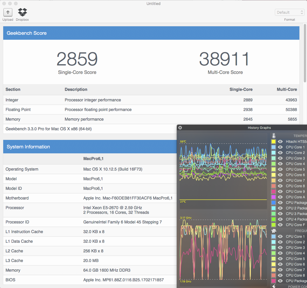

Regarding ssdt.aml, first I created SSDT for my CPU E5-2670v1. Power management seemed to work and power consumption of the system was 140W (Wattmeter is always pluged-in), but Geekbench (Multicore Score around 22k) and my renders were too slow compared to Win7. HWMonitor was showing the lowest frequency of CPU was 2.2 GHz. I was playing with the ssdtPRGen.sh script further and eventually it worked out (not sure though) with E5-2670v2 setting.
ssdtPRGen.sh script parameters that I succeeded:
sh ssdtPRGen.sh -cpus 2 -target 0 -l 32 -c 3
After that, the lowest frequency was correct (1.2 GHz) and full performance was regained (renders as expected, i.e. 3-5% faster than Win7, Geekbench showed almost 39k). That's it.
Tests and reports by other users are more than welcome.
Big thanks to author's tutorial, I wouldn't manage without it.
