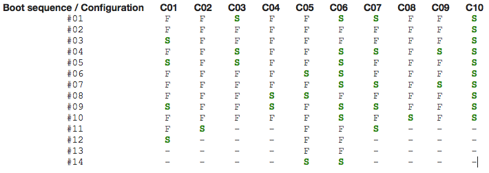

kignon Posted August 28, 2016 Author Share Posted August 28, 2016 (edited) I'm back to do my report Sir! Configuration C01: I went into my UEFI and set up my USB as you ask, I have also set my RAM frequency to 'Auto' then put X.M.P. to Profile 1. I then re-create my SSDT with '-x 1' (for X.M.P. enabled) in addition to my arguments. Configuration C02: From C01, I have removed my SSDT-1.aml file from Clover, it is the Toldea's patch for my wifi card Broadcom 4352. Configuration C03: From C02, I have removed the Clover patch to allow 21 USB ports on xHC drivers instead of the 15 allowed by Apple. Configuration C04: From C03, I set back EHCI Hand-off to disabled as it was in my default UEFI configuration. Configuration C05: From C04, I set back Intel xHCI Mode to Smart Auto as it was in my default UEFI configuration. Configuration C06: From C05, I disable Intel X.M.P. in my UEFI (as it was), and removed all my SSDT files in Clover (so no SSDT or DSDT), I also put back my Clover patch to allow 21 USB ports on xHC. Configuration C07: From C06, I have re-create my SSDT using Piker-Alpha' script and put it back in Clover's patched folder. Configuration C08: From C07, I have removed all my kexts for Bluetooth from Clover (BTFirmwareUploader and AsusBCM20702A0Bluetooth). Configuration C09: From C08, I simply have disabled my onboard Wifi and Bluetooth card in my UEFI. Configuration C10: From C09, I have restored my SSDT-1.aml file, my kexts for Bluetooth and I have activated my onboard Wifi and Bluetooth card on my UEFI. In others words, my configuration is as it was before C01. I have replaced nvda_drv=1 by nv_disable=1. For each settings, I have tried to boot 10 times and I have written if my hackintosh had reset or if the boot sequence succeded. After 10 times, I simply have written the result before I could boot and update my configuration. Boot sequence / Configuration C01 C02 C03 C04 C05 C06 C07 C08 C09 C10 #01 F F S F F S S F F S #02 F F F F F F F F F S #03 S F F F F F F F F S #04 F F S F F S S F S S #05 S F S F F S F F F S #06 F F F F S S F F F S #07 F F F F F S S F S S #08 F F F S S F F F F S #09 S F F S F S S F F S #10 F F F F F S F S F S #11 F S - - F F S - - - #12 S - - - F F - - - - #13 - - - - F F - - - - #14 - - - - S S - - - - F = Fail S = Success I think there is a problem between my graphic card, the NVIDIA Web Driver and OS X El Capitan; any idea ? If the table is not properly displayed, check the attached file. Cordially, [edit]: the table is not properly displayed... [edit]: Found this subject now that I have searched GTX 970 kernel panic: http://www.insanelymac.com/forum/topic/305142-gtx-970-random-kernel-panics-on-boot/the author has solved his problem by connecting his monitor with dvi cable; he was using a VGA one before. I am currently using a DVI to VGA adaptator, it is possible indeed that the problem comes from here. Weird is not it ? Edited August 28, 2016 by kignon Link to comment Share on other sites More sharing options...

Allan Posted August 28, 2016 Share Posted August 28, 2016 Try this: config.plist.zip Use the Configuration C10. If you set 1 for XCPM in SSDT keep using it. In this config.plist I've set X.M.P as 1, do the same in BIOS/UEFI. One doubt, what "mbasd=1" mean? Link to comment Share on other sites More sharing options...

kignon Posted August 28, 2016 Author Share Posted August 28, 2016 So, I have used your config.plist finally and hum... Just to be sure, my configuration C10 is my initial configuration before I tried anything about USB (following your instructions), with nv_disable=1 instead of nvda_drv=1. In others word, I have just disabled my graphic card (I wanted to be sure that I didn't have any problems to boot without it). So I look into your config.plist and recreated a SSDT with XCMP enable, made the change into mine. On six boots, only 2 have failed, it is better, but again, not perfect. Obvisouly, I did it using nvda_drv=1, because with nv_disable=1, I had not any graphic acceleration... I still do not understand too, why fixing USB is "solving" my problem, but I would be curious to hear what you had / have in mind about that. Did you notice that I found a "solution" by replacing the monitor by a one with digital connector (I am still trying of course, but it did seems to work by replacing my Samsung SMB2230 by an Apple Cinema Display); apparently the problem comes from the VGA (D-Sub) connector and does not seem to be present with a digital one (HDMI / DVI-D)? I also recall that I had another monitor when I was on Yosemite, but it was too big, so I sell it and went on a former one (old, but for what I do, it was enough). It is really time to change my monitor... Link to comment Share on other sites More sharing options...
