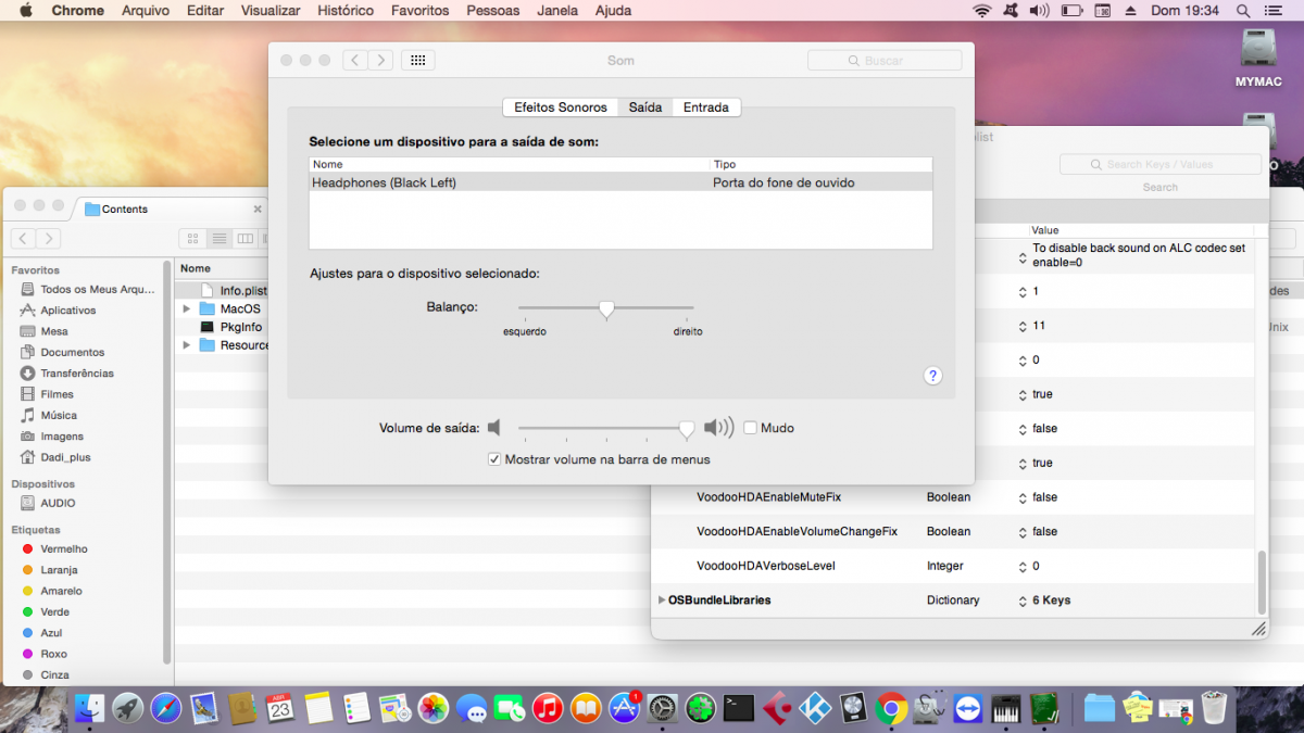

Thanks! Works with Yosemite. I have only one problem. My notebook speaker is working stereo but in my headphones if I use stereo I have a very bad sounds! I need choose between left or right.
Sounds like a short in your headphones.  How do you "choose" between left or right?  By lowering the volume on the other all way down to zero?
Can you record the bad sound by phone an upload here for us?
I can´t because is with my headphones but I saw that I got HEADPHONES (BLACK LEFT) When I plug it in. It shouldn´t be like this right?

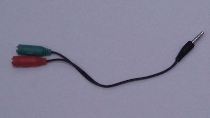

That's common connector for laptops.  Maybe try with splitter
I know is not cable! I already try this.. also 4 different headphones with and without mic.

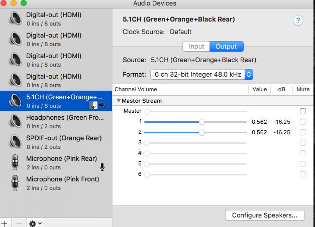

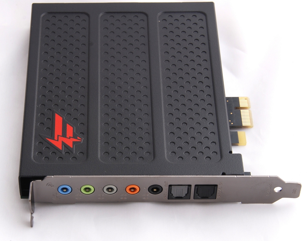

VodooHDA makes (rear) sound output (stereo) work but Microphone, Line-Out, SPDIF (Rear) wont work.
I've been trying to get the PinConfigOverrideVerbs from Windows regedit and the codec dumps from linux but this card (Emu20k2, SB0880) doesnt have any codecs on linux even though microphone works perfectly fine there and windows doesnt have a PinConfig entry in the registry for this card.
I'm at a loss... what else can I do to make at least the mic/lineout to work?

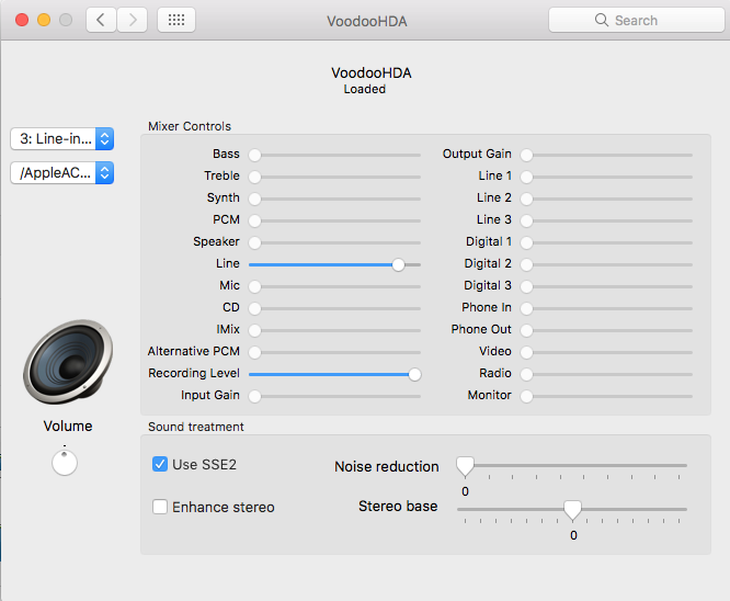

Run the prefpane, select the Mic Input you want to use
- RecLev is the main volume for audio input, so set it to something usable.
- Microphone/Monitor/Line-In are secondary volumes for audio input - so set the one you're using to something useful and mute the others.
- If you have iMix, set it to 100%
- Mute other volumes on the Mic Input.
- Make sure you're using latest 2.9.0d10.
If you still have problems, upload getdump.
I have some changes that make the System Volume Control for Mics change the RecLev, but haven't committed it yet.
I am on the latest 2.9.0d10 and I'm using the prefpane from this thread as the one from sourceforge wouldnt work.
This is what my Line-In (Blue Rear) looks like
I tried different volume settings for Rec, Line and bottom left volume but it made no difference.
In windows I had to select "microphone" in my driver instead of "line-in" as it is a combo port I believe?
edit: yup - It's called "FlexiJack" in windows and I have to click "microphone" instead of "line-in" to be able to use the mic on that port.

And how the IO of the card looks like:

solved, remove the old VoodooHDA.prefPane from Library/PreferencePanes and install the new by clicking on it.
Works but I have only two option to adjust: PCM and iMix. I cannot adjust bass or speaker value.
Audio chip is IDT92HD99BXX.

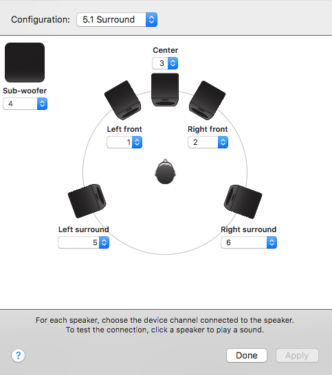

Greetings Slice,
I’m excited! This is the closet I’ve been to fully functional onboard Realtek ALC1150 audio. The front headphone port works great without noise, however when I try the analog “5.1CH (Green+Orange+Black Rear) and SPDIF optical digital-out port, I only get Left/ Right/ Sub. My center/ surround speakers are not working. I've tested my 5.1 receiver with other audio sources and it is functioning properly. I used Kext beast to install your “VoodooHDA.kext-2.9.0d10” file to S/ L/ E and I manually moved the “prePane-289” to L/ PreferencePanes. Your help would be greatly appreciated. Thanks.
Analog 5.1CH/ SPDIF Optical digital-out
1. Left
2. Right
3. Sub
No center or Surrounds channels 4-6 have no audio.
I added the following to Clover Config Text Mode.
<key>NodesToPatch</key>
<array>
<dict>
<key>Codec</key>
<integer>0</integer>
<key>Config</key>
<string>0x100001</string>
<key>Node</key>
<integer>16</integer>
</dict>
<dict>
<key>Codec</key>
<key>Config</key>
<key>Node</key>
<integer>14</integer>
</dict>
<dict>
<key>Codec</key>
<key>Config</key>
<key>Node</key>
<integer>5</integer>
</dict>
</array>
Gigabyte GA-X99P-SLI (BIOS f23) - Intel Core i7-5820K 6-Cores - GIGABYTE GeForce GTX 970 - Vengeance LPX DDR4 DRAM 2400MHz - Sierra 10.12.5
1. Why did you add NodesToPatch to Clover config? These must be in VoodooHDA/Contents/Info.plist
2. What is config 0x100001? This is wrong node config.
Make getdump to see what nodes present and what needed to patch.
