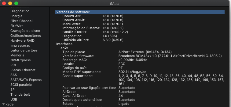

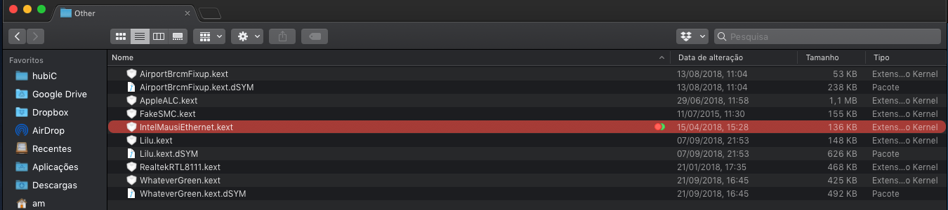

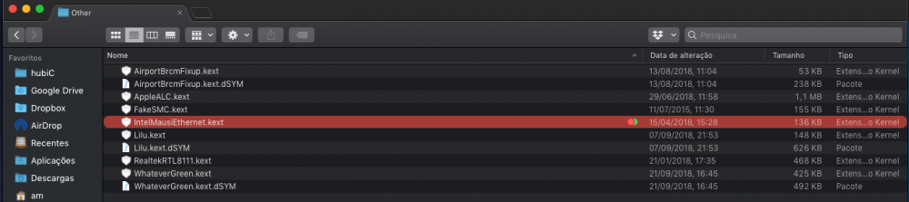

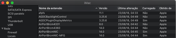

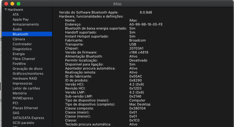

MorenoAv Posted October 3, 2018 Share Posted October 3, 2018 (edited) Hi guys, @fariel23, I have that same wifi/bluetooth combo, and its working as it should, as you can see in the photos attached to this post... The only kext that I use is the AirportBrcmFixup, after I switched to WhateverGreen, nothing more te card work without any kexts, but I used Sierra, High Sierra, and now I use Mojave, and the card continues to work consistently... https://www.amazon.es/dp/B00MBP25UK/ref=pe_3310721_189395781_TE_dp_1 Edited October 3, 2018 by MorenoAv 1 Link to comment Share on other sites More sharing options...
