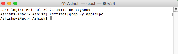

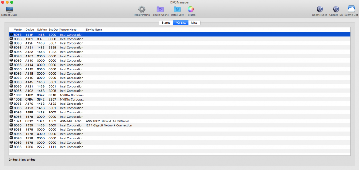

hashish.k Posted July 30, 2016 Share Posted July 30, 2016 I have been working to get the power management working on my hack for sometime without success. The lowest speed that my computer idles is 1.4 Ghz. I have SSDT generated from ssdtprgen in my ACPI/patched folder. I am using SMBIOS for iMAC 17,1. It seems the problem is AppleLPC.kext is not loading when the OSX starts. I searched the forums but could not find an easy answer on how to load it. I am not comfortable modifying DSDT so the best way for me would be to create an injector kext. The problems I am encountering are I don’t know the device ID of my LPC device. I tried DPCI manager but its not listed there. Don’t know where it would be in the DSDT I tried “fakeLPC=true” on the clover config.plist but my computer does not boot after that. I was wondering if someone could help me make an injector kext. I found another thread with an injector kext but it has 9 series motherboard on the info.plist. http://www.insanelymac.com/forum/topic/309205-applelpckext-not-loading/?hl=%2Bapplelpc&do=findComment&comment=2185351 can I use this kext and replace the device ID of LPC device of my motherboard or additional modifications are needed? I am attaching my config.plist, DSDT.aml If you need anything else please let me know. TIA Link to comment Share on other sites More sharing options...
Allan Posted July 30, 2016 Share Posted July 30, 2016 Download DPCIManager, go to PCIList, take a screenshot and post here. Link to comment Share on other sites More sharing options...

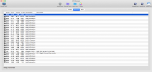

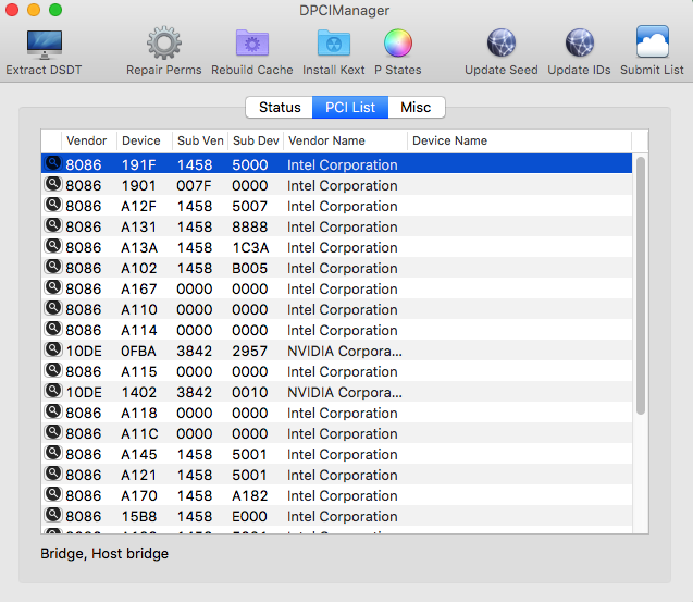

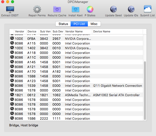

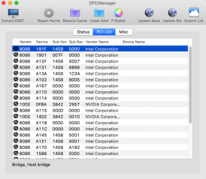

hashish.k Posted July 30, 2016 Author Share Posted July 30, 2016 Hi Allan, Thanks for a quick reply. I read your post on OSX86.net Please find the screen shots attached. 1 Link to comment Share on other sites More sharing options...
Allan Posted July 30, 2016 Share Posted July 30, 2016 Hmmm, can you stretch the app window? I need more information, sorry Link to comment Share on other sites More sharing options...
hashish.k Posted July 30, 2016 Author Share Posted July 30, 2016 I am not sure why DPCI manager is not showing the names of the devices. This screen shot puts all the devices on a single page. Link to comment Share on other sites More sharing options...
Allan Posted July 30, 2016 Share Posted July 30, 2016 Ok, no problem. Send me your config.plist + DSDT (original) and the patched. Link to comment Share on other sites More sharing options...

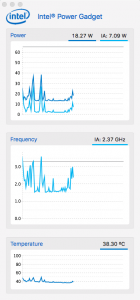

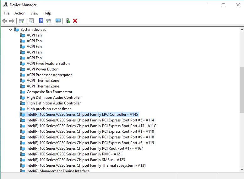

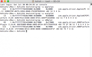

hashish.k Posted July 30, 2016 Author Share Posted July 30, 2016 I was finally able to get the LPC device ID from the windows device manager, properties. mine was a145. I used the injector kext and changed the value to a145 and the AppleLPC loads. However, no change in the baseline frequency. Still idles around 1.4 to 1.5 Ghz. May be the intel power gadget is not showing accurate frequencies. console does show that XCPM is enable. Anyway thanks for your help Allan. Link to comment Share on other sites More sharing options...
