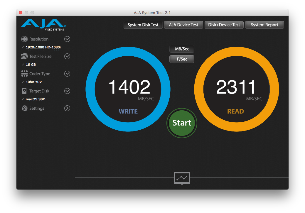

Hi all, i installed OCZ Toshiba RD400A Series 512GB today. Tested it in m.2 slot and in PCIe slot. Works as boot drive without problems.
Im using kext generated by Micky's NVMeP 2.5. I leave IONVMeFamily.kext in S/L/E.
Speed is quite good. Before i try Intel 750 Series and cant go more than 800MB/sec.
Tested on 10.12.1 (16B2657).
EDIT: My plan was to buy new Samsung 960 Pro or Samsung SM961, but its impossible find them in stock in Europe.

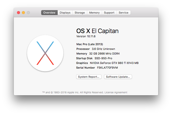

I mounted an X99-A-II with a 6850K and a Samsumg 950Pro.(For a friend)
I installed the kext in S / L / E and in EFI / CLOVER / KEXTS / 10.12
But no patches in the congig.plist.
The Samsumg 950 Pro is recognized at startup and in Sierra.
No untimely restart.
Edit
It is not possible to boot on the samsung 950Pro
It boot (clover) on an SSD but the Os is on the Samsung950Pro
Edited by Fljagd
