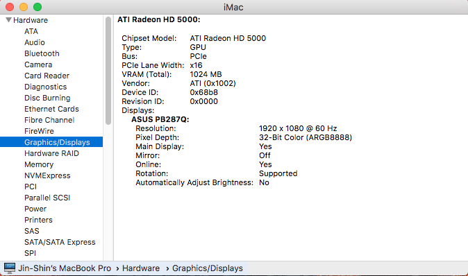

hello jsl i see on your signature you have the same motherboard as i do and suffer from colour problem and i dont so can it be the graphics card or just the fact i had to put iMAC 14.2 and it went away
can you try using a smbios signature that as a ATI in it? and see if it works

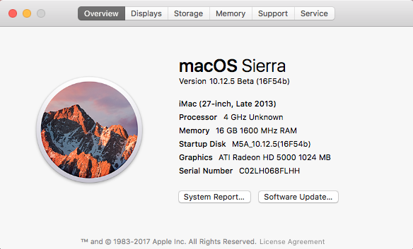

There are 3 AMD/ATI 5770 cards in my two Intel and one AMD FX-6300 hackintoshs.
All were using iMac 14.2 smbios and only FX-6300 hackintosh had the color flickering issue which need fixation by SwitchResX.
After update to 10.12.5(16F54b) it also need colors=32 in my boot.org.chameleon.Boot.plist to prevent this colors flickering again in addition to previous fix by SwitchResX.
In 10.12.4 or 10.12.5 beta 1 only using SwitchResX  is enough to fix it.
So my judgement is that colors flickering issue was caused by newer OS after 10.12.4 which may occur in some AMD or Intel hackintoshs only.

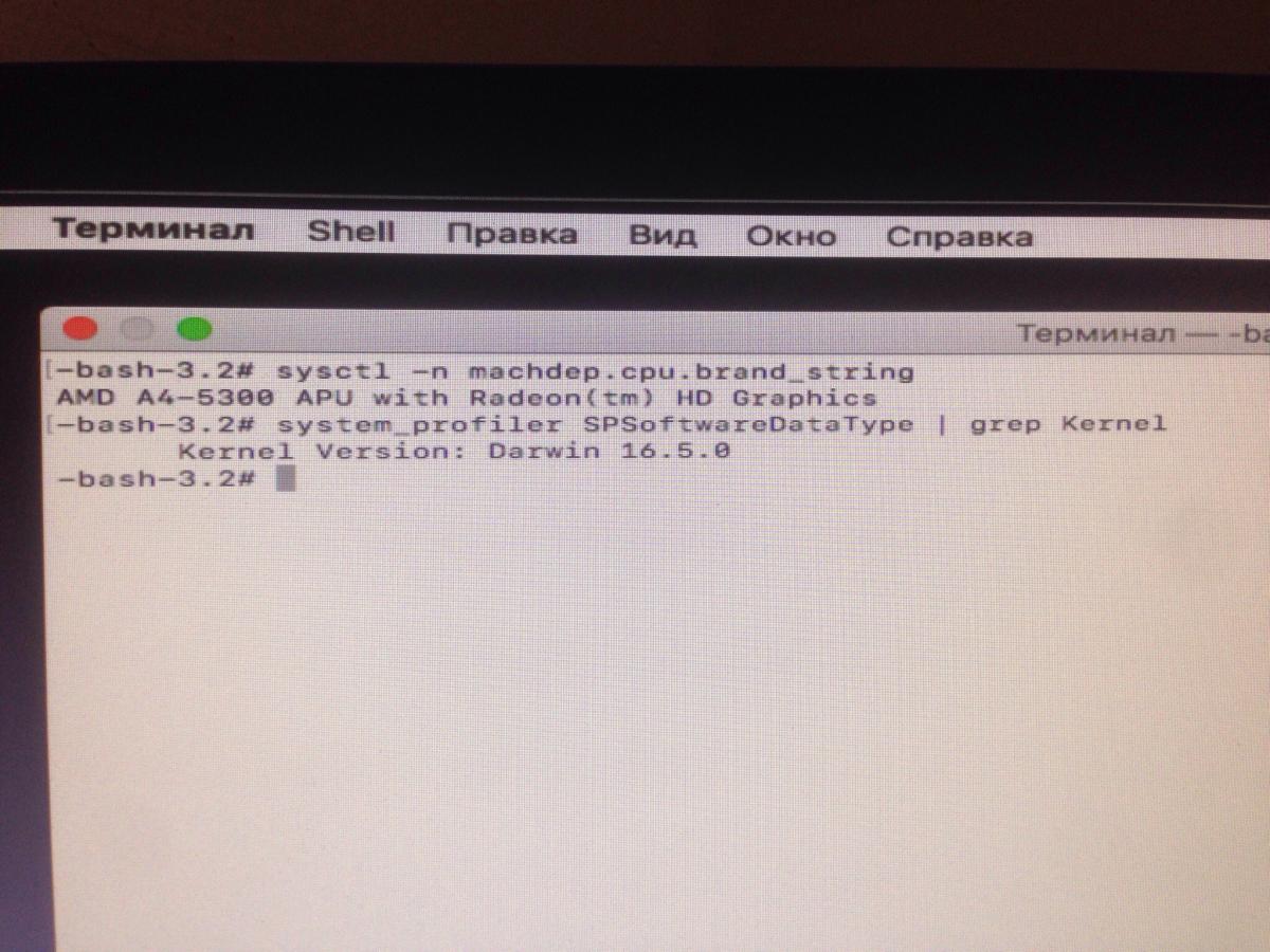

Вот запуск установщика 10.12.4 с клевером на apu и ванильный интеловским ядром !
This installer 10.12.4 on apu with clover efi & vanilla intel kernel !
So you booted a Sierra Installer on an AMD APU  with a Vanilla kernel and Clover ? did you spoof your CPU in Clover ?
Wanna share how u did it ?
Did i miss something ?
