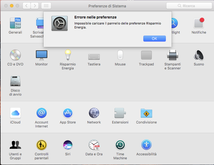

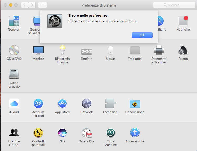

in 10.12.2 some preferences do not open, network type - saving energy, but this was to be expected
who installed the 10.12.2 has problems with these preferences ???

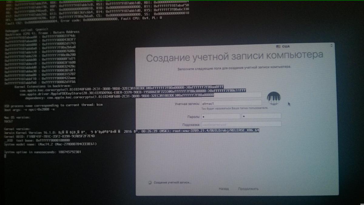

I get a kernel panic on the create an account after installing. Many people are also reporting this panic. I also upgraded from my 10.12 the panic still occurs. My cpu is FX-6300.
It seems related to /System/Library/Extensions/corecrypto.kext error.
I did not have such a problem in my FX-6300 hackintosh.
Also your graphics display still showed icon glitchy which was not normal at 10.12.x

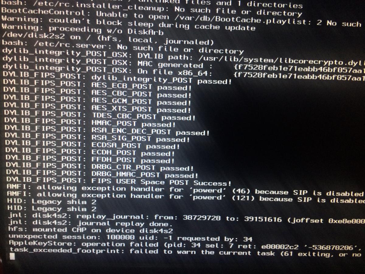

after update to 10.12.2 i received this error using the bronya   kernel:
applekeystore operation fail.
the kernel load but the graphics no. i use a lot of the boot option and dot work.  in theses both enoch and clover  the graphics don't up
I have the same error message during booting, but no issues after login desktop soon later.
The kernel is the 10.12 and 10.12.1
the kernel must be tested in that, it makes you install but it has many problems:
some preferences are not opened,
the network does not work, Siri does not work, Preview closes if they attempt to edit photos
this is the report of the 10.12.2:
sysctl-log.txt

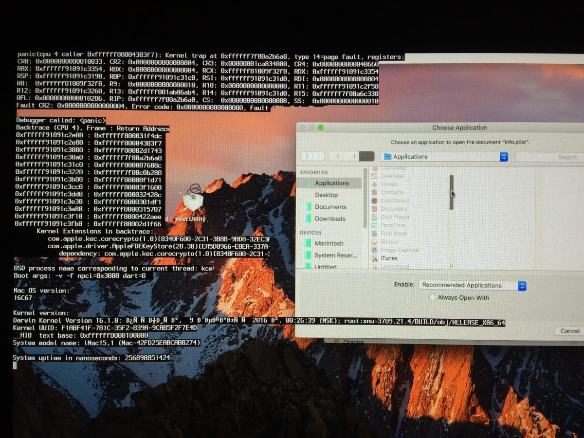

We should work together on a solution for older CPUs!. I have used all possibilities so far to implement all CPU instructions in to kernel unfortunately all attempts were in vain. I have used all previous opcodes including others opcodes with sse4a, sse4.1 and sse4.2 ....unfortunately again and again with the same panic message. It makes very little sense that everyone tries to cook their own soup in their kitchen. Since otherwise we will not succeed before the end of the year.
  • Like 4
Spakk, Apple say that 10.12 needs sse4.1 but all the intel supported cpus also support native ssse3, old amd don't.netkas said on this topic that the corecrypto KP was part of the ssse3 instructions and that the emu is not supporting kernel modules so ssse3 is still needed for some kexts.I don't know how openemu really works but it seems that in this case you have to find a way to use double emulation ssse3 to sse3 and sse4.1 to sse3 or sse4a.If the emu is not supporting kernel modules,you will need patched kexts or a new emulator.
Any idea about the corecrypto panic on older CPUs? SSSE3 instruction according to Netkas.

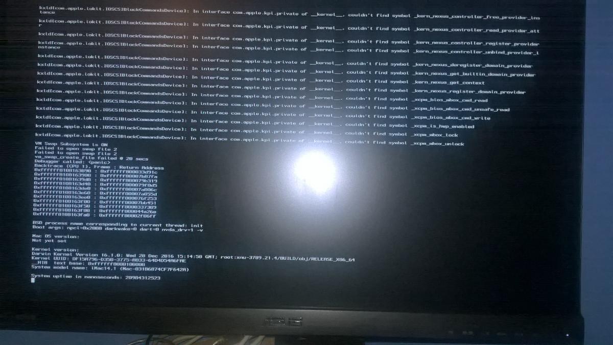

FX 6100 put clean 10.12.2. Kernel bronya 10.12.1 what problem can be?
flew all the first time.and then there is plugging.that such a global change?
CPUs? SSSE3  never a problem with it I didn't have
No working.

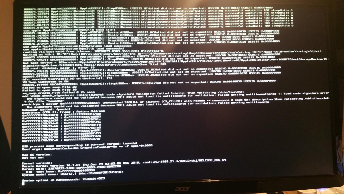

Two start-attempt installation!
Pictures attached!

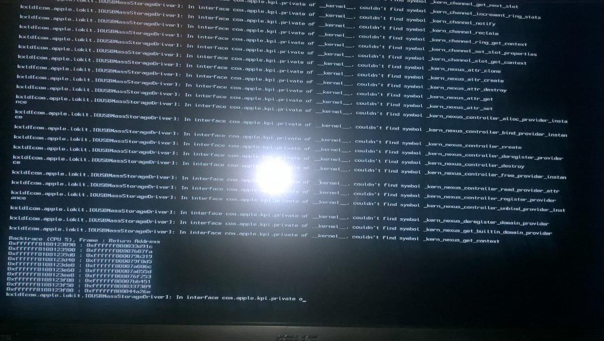

Hi ! Try kernel on FX , because i compiled kernel only on old's cpu's Phenom II ! Works or don't work' on FX ! I need this know , because i no have FX cpu, because my cpu FX 8150 crashed!
Boot process stops as shown on the picture.
