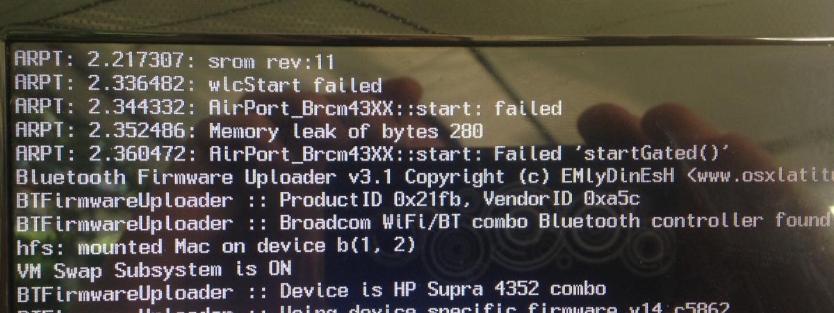

Hi!
I've installed Sierra on my laptop. The only problem I have is a problem with Wi-Fi (Broadcom BCM94352HMB). In El Capitan I've used FakeID option in Clover. In Sierra FakeID is functional, kexts are loaded, but system sees no hardware. During boot I've seen following messages:
Have you any ideas why it's not working?
Thanks in advance.

I'm getting the same error multiple times when I boot.  Immediately after that, I get a kernel panic but I don't think the wifi problem is necessarily related to the kp.

Same here. I remember wifi is working diring installation window. What's the difference between 10.12 installation environment and 10.12 system?
Have you made a fresh installation or update from el capitan?
Gesendet von meinem iPhone mit Tapatalk
I tried both. First time upgrade from 10.11. Then I thought it probably due to upgrade bug. Then I erase whole disk and do fresh installation. But wifi do not work under both times .

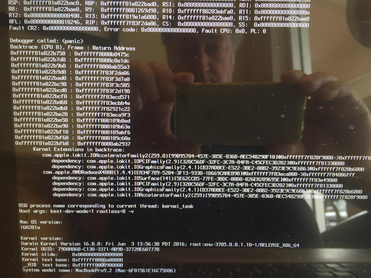

I am getting a KP from IOAcceleratorFamily2.kext.  When I remove the kext from S/L/E, I can boot to Sierra but I don't get QE/CI.  I am using the Intel HD4000 GPU.  My AMD Radeon 7850M GPU is disabled in the BIOS.  The HD4000 kexts do not load.  Any ideas?
EDIT:  On a hunch, I put IOAcceleratorFamily2.kext back in S/L/E and removed the AMDRadeonX4000.kext.  That worked!  I was able to boot to Sierra with full graphics acceleration.  I'm not sure why I am getting that KP and the thought of having to remove that kext for every installation, while not very onerous, is a drag for someone that wants to be able to run a Vanilla version of Sierra.
Now, I need to get wifi and sound working.  [sound works by installing DisableAppleHDA.kext and VoodooHDA.kext in S/L/E.  However, PTHVolume will not load in Sierra.  PTHVolume is a 32-bit app and Sierra will not support it so I need to find a new app to control a multi-output audio device from the menu bar.]
