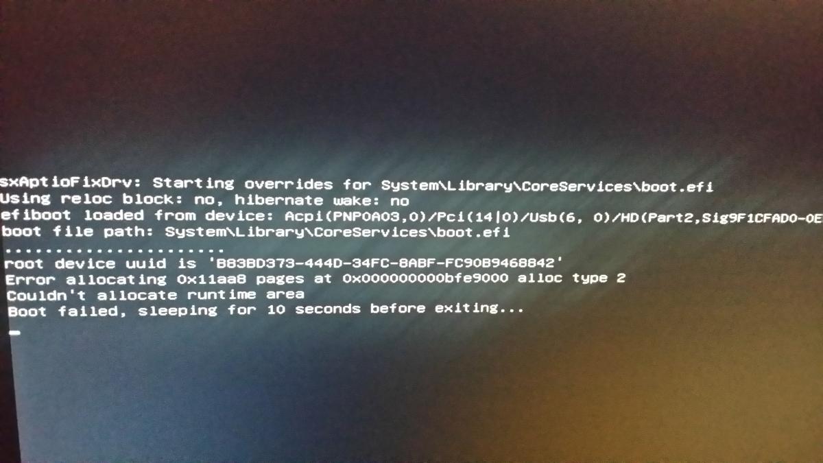

skareemr Posted April 8, 2016 Share Posted April 8, 2016 Hello everyone, This is my first post in insanelymac forums I am facing problem in installing MAC OS X Yosemite on my PC. This is the error I am getting when I boot from USB drive as shown in this image: Please, help me to overcome this problem. ------------------------------- My PC specifications are: Current Operating System Windows 7 Professional 64-bit SP1 CPU Intel Core i7 5820K @ 3.30GHz Haswell-E/EP 22nm Technology RAM 64.0 GB Motherboard MSI X99S GAMING 9 ACK (MS-7882) Graphics 2047MB NVIDIA GeForce GTX 980 Ti (MSI) 2047MB NVIDIA GeForce GTX 980 Ti (MSI) 2047MB NVIDIA GeForce GTX 980 Ti (MSI) ForceWare version: 364.72 SLI Disabled Storage 2 TB Seagate ST2000DM001-1ER164 ATA Device (SATA) 1 TB Crucial CT1000BX100SSD1 ATA Device (SSD) Optical Drives PIONEER BD-RW BDR-209M ATA Device Audio Realtek High Definition Audio ------------------------------ I don't have Apple PC available to me ... So, I used a copy of OS X Yosemite on VMware Workstation to be able to prepare a bootable USB drive with OS X Yosemite on it. This is what I am using: [url="http://www.insanelymac.com/forum/topic/279450-why-insanelymac-does-not-support-tonymacx86/"]#####[/url] 6.1.1 [url="http://www.insanelymac.com/forum/topic/279450-why-insanelymac-does-not-support-tonymacx86/"]#####[/url] Yosemite Edition 7.5.0 OS X Yosemite v10.10.1.6.5 in Applications folder Step 1 - I used Disk Utility to format my 8 GB USB Drive as per the instructions ( Partition Layout = 1 Partition / Format = Mac OS Extended (Journaled) - Name = USB) Step 2 - I used [url="http://www.insanelymac.com/forum/topic/279450-why-insanelymac-does-not-support-tonymacx86/"]#####[/url] 6.1.1 to create the bootable USB drive (I used UEFI for Bootloader configuration). Step 3 - I copied the whole [url="http://www.insanelymac.com/forum/topic/279450-why-insanelymac-does-not-support-tonymacx86/"]#####[/url] - Yosemite Edition folder into the USB drive. Step 4 - I restarted my PC and boot from the USB. I get the error as described above. Please help! As I am new to this Website and after posting my help request, I realized that tonymacx68 is not supported by insanelymac.com ... Then let us forget about tonymacx68 tools .... My request is still the same: Please, help me to install MAC OS X Yosemite on my PC. Ok I am shifing to Pandora's Box. I will use Pandora's Box to create bootable USB drive. I will let you know if I will be able to install MAC OS X Yosemite ... or ... I get any error while installing. Quote Link to comment Share on other sites More sharing options...
Allan Posted April 8, 2016 Share Posted April 8, 2016 Hello @skareemr, how are you? And welcome to InsanelyMac Look, you have a (very) good hardware, but these tools ***beast, are not supported here. Please, read carefully why we don't give/use ***beast tools: VERY IMPORTANT: PLEASE READ! (ABOUT TONYMACX86 AND iATKOS M / Y) Why InsanelyMac does not support tonymacx86 If you want our help, you can follow our guides: Tutorials (The Genius Bar) Making a 10.10/10.11 USB Installer /w Clover (UEFI and Legacy) the correct way! Haswell-E mach_kernel patch (5960X, 5830K and 5820K) 10.10 - 10.10.1 Yosemite 1 Quote Link to comment Share on other sites More sharing options...

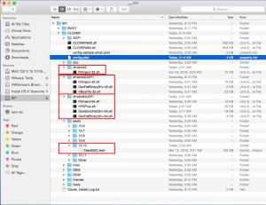

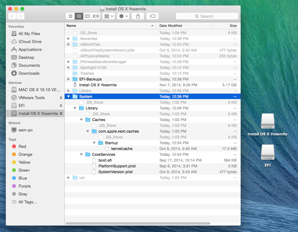

skareemr Posted April 8, 2016 Author Share Posted April 8, 2016 Hello everyone, This what I have right now: EFI Partition Install OS X Yosemite Partition According to this >>>> Haswell-E mach_kernel patch (5960X, 5830K and 5820K) 10.10 - 10.10.1 Yosemite I should have /System/Library/Kernels/kernel and /System/Library/Extensions/ in Install OS X Yosemite Partition. However, and as you can see in the image above, in Install OS X Yosemite partition the two folders /System/Library/Kernels/kernel and /System/Library/Extensions/ are missing!!! What is my mistake? And how to solve this? Thank you guys for your efforts to help me in all this. Quote Link to comment Share on other sites More sharing options...
Dwarfy Posted April 8, 2016 Share Posted April 8, 2016 I don't think you need to patch kernel with latest clover. Besides you can always do it with clover KernelHaswellE patch. Correct me if I am wrong, anyone. 1 Quote Link to comment Share on other sites More sharing options...
Duran Keeley Posted April 8, 2016 Share Posted April 8, 2016 You should download the latest installer for Yosemite from your VM. If you have the latest Yosemite installer it's not needed to patch the kernel, 10.10.2 and newer, Apple added native support for Haswell-E. 1 Quote Link to comment Share on other sites More sharing options...

skareemr Posted April 9, 2016 Author Share Posted April 9, 2016 Hello everyone, Sorry for the delay ... I was struggling all night to over come this problem of not being able to reach the installing stage of MAC OS X Yosemite, due to the error of "Couldn't allocate runtime area". Now I am able to boot and reach the installing stage. However ... the headache is horrible .... I need deep rest and sleep now. I will come back here to tell you how I did it, step by step. I think there is still a lot to be done. So wait for my next post today. Quote Link to comment Share on other sites More sharing options...

skareemr Posted April 9, 2016 Author Share Posted April 9, 2016 Hello everyone, Things are getting very exciting !!!! -------------------------- 1- The theory of having more than 1 PCI card will make the booting not possible is WRONG!!! Now I have 3 MSI NVIDIA GeForce GTX 980 Ti all mounted to 3 PCI slots and all 3 are connected in 3-Way SLI and still, I am able to boot from the USB and reach the installation stage. 2- The recommended BIOS Settings: CFG to Disabled and VT-d to Disabled are also NOT TRUE!!! I am able to boot from the USB and reach the installation stage with both of these 2 setting enabled. 3- I did not disable ASMedia. However, I am able to boot from the USB and reach the installation stage. --------------------------- I am not saying that I have full clean booting. For sure I can see some errors while booting because I used the flag -v. and I would love to discuss these errors with you guys. So .... I decided to stop the full installation ... I prefer to do more reading and discussion about preparing things correctly. I am willing to share with you many screen shot of all preparations and settings I used. Quote Link to comment Share on other sites More sharing options...
Dwarfy Posted April 9, 2016 Share Posted April 9, 2016 1. The PCI cards are working because of the test2.efi SLI is Software based, it only works in Windows and possibly other OSs I don't know of, but it does not work in OS X. However, your cards can work as triple GFX for you. 2 and 3. The settings are just for reassurance. Quote Link to comment Share on other sites More sharing options...

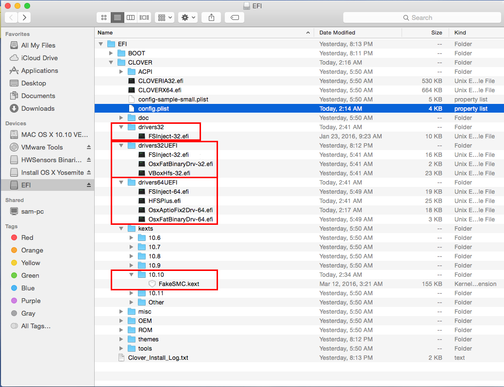

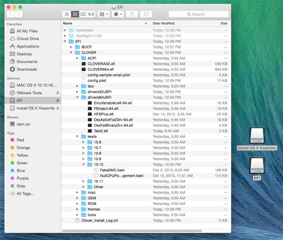

skareemr Posted April 9, 2016 Author Share Posted April 9, 2016 Hello DwarfVador, This is EFI partition of the USB I am using for booting: As you can see I did not use test2.efi ... Also, In kexts > 10.10 I have only FakeSMC.kext What you think? Quote Link to comment Share on other sites More sharing options...
Dwarfy Posted April 9, 2016 Share Posted April 9, 2016 Looks good. Though that does not mean that your configuration applies to everyone. So saying that things are somewhat not true, is wrong to say. I will quote Download-Fritz for what Aptiofix is. "AptioFix relocates memory and AptioFix2 does not. And PCIe only matters because of option ROMs, some new FWs load them fragmented and low. So, Aptiofix/boot.efi can't grab enough continuous memory < 4GB." It depends from hardware to hardware, either way. Quote Link to comment Share on other sites More sharing options...

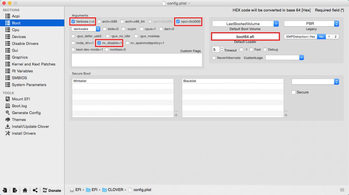

skareemr Posted April 9, 2016 Author Share Posted April 9, 2016 Well, Before I was not able to boot ... So I used "Clover Configurator.app" to make changes to the "config.plist" located in EFI > CLOVER ... Take a look on this: You see the flags I am using? What I did is changing boot.efi to boot64.efi ... After all, if we search in the entire EFI partition, there is not file called boot.efi. Once I change it to boot64.efi, things started to work. Quote Link to comment Share on other sites More sharing options...
Dwarfy Posted April 9, 2016 Share Posted April 9, 2016 Well, Before I was not able to boot ... So I used "Clover Configurator.app" to make changes to the "config.plist" located in EFI > CLOVER ... Take a look on this: MAC06.jpg You see the flags I am using? What I did is changing boot.efi to boot64.efi ... After all, if we search in the entire EFI partition, there is not file called boot.efi. Once I change it to boot64.efi, things started to work. I think boot.efi was said generally to explain. Makes sense... Quote Link to comment Share on other sites More sharing options...
