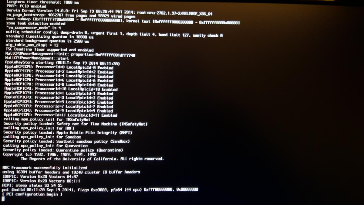

Good point. I tried to clear it up a bit, but still no luck. Can't boot without -f and npci=0x2000. in verbose mode i get:
