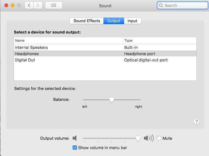

MacPeet Posted April 6, 2018 Share Posted April 6, 2018 @MegaCookie You have not reported on the inputs. Internal mic works? External Mic (LineIn) works? Your codec_dump is very clear. Speaker on 27-13-3. We have already tried: 27-13-3 and 27-38-37 (codecDump says EAPD: 2) HP: 20-12-2 (codecDump says EAPD: 2) Mic int .: 8-35-18 Mic ext. (LineIn): 9-34-24 SPDIF: 30-6 Try this (here Speaker and HP in ManualMode): trial3_ALC1220_for_Clevo_P950HR_LayoutID13.zip Link to comment Share on other sites More sharing options...
MegaCookie Posted April 6, 2018 Share Posted April 6, 2018 (edited) 2 hours ago, MacPeet said: @MegaCookie You have not reported on the inputs. Internal mic works? External Mic (LineIn) works? Your codec_dump is very clear. Speaker on 27-13-3. We have already tried: 27-13-3 and 27-38-37 (codecDump says EAPD: 2) HP: 20-12-2 (codecDump says EAPD: 2) Mic int .: 8-35-18 Mic ext. (LineIn): 9-34-24 SPDIF: 30-6 Try this (here Speaker and HP in ManualMode): trial3_ALC1220_for_Clevo_P950HR_LayoutID13.zip Thanks! The internal speakers are finally working when the audio output is set to 'Headphone'. Audio with headphones is also working when the audio device is set to: 'Headphone', is that what you mean with 'Speaker and HP in ManualMode'? The internal microphone works fine as well, but I cannot test an external microphone as I don't have one. BTW: should EAPD now covered in AppleALC as well, or do I need another kext for that? The audio doesn't work after 'sleep' with your AppleALC.kext. Edited April 6, 2018 by MegaCookie EAPD question Link to comment Share on other sites More sharing options...
MacPeet Posted April 7, 2018 Share Posted April 7, 2018 (edited) Please show me pictures of system settings / sound. Speaker work when HP is set? The first two attempts are configured in SwitchMode. In System Preferences / Sound only one output is visible. Example: Speaker is visible - now that HP is plugged in, then the display automatically switches to HP. If HP is removed, the speakers are displayed again. Trial 3 is ManualMode. Both outputs are visible in System Settings / Sound / Output. The selection is done manually. EAPD is set in the PinConfig. Sleep is a completely different story. Try ResetHDA in the Clover or EAPDFix.kext or try again the CodecCommander.kext for audio after Sleep. EAPDFix.kext and CodecCommander.kext (info.plist) should contain the correct nodes. HDMI must be regulated in the DSDT. (HDAU and hda gfx entries). This is not a matter of AppleALC. Edited April 7, 2018 by MacPeet Link to comment Share on other sites More sharing options...

MegaCookie Posted April 9, 2018 Share Posted April 9, 2018 On 4/7/2018 at 8:05 AM, MacPeet said: Please show me pictures of system settings / sound. Speaker work when HP is set? The first two attempts are configured in SwitchMode. In System Preferences / Sound only one output is visible. Example: Speaker is visible - now that HP is plugged in, then the display automatically switches to HP. If HP is removed, the speakers are displayed again. Trial 3 is ManualMode. Both outputs are visible in System Settings / Sound / Output. The selection is done manually. EAPD is set in the PinConfig. Sleep is a completely different story. Try ResetHDA in the Clover or EAPDFix.kext or try again the CodecCommander.kext for audio after Sleep. EAPDFix.kext and CodecCommander.kext (info.plist) should contain the correct nodes. HDMI must be regulated in the DSDT. (HDAU and hda gfx entries). This is not a matter of AppleALC. With these settings the speakers and headphones are working: So yes you are right that I got two different outputs using the manual mode, however the 'Internal Speakers' setting is not working. I have to set it to Headphones even when I'm using the integrated speakers. Switching to 'Internal speakers' simply does result in not working audio. Link to comment Share on other sites More sharing options...

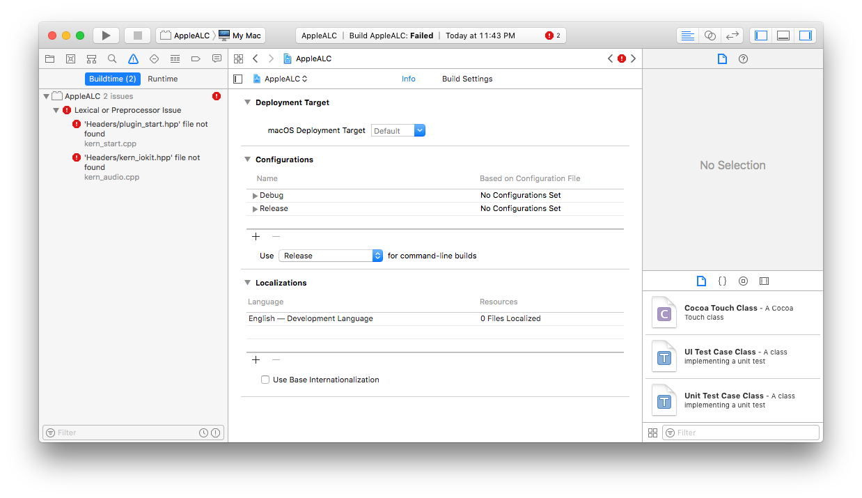

toleda Posted April 10, 2018 Share Posted April 10, 2018 Xcode 9.2, build problem. Suggestions? Link to comment Share on other sites More sharing options...
MacPeet Posted April 10, 2018 Share Posted April 10, 2018 (edited) @MegaCookie very strange try this: file deleted, not relevant anymore Edited April 11, 2018 by MacPeet Link to comment Share on other sites More sharing options...
vit9696 Posted April 10, 2018 Author Share Posted April 10, 2018 5 hours ago, toleda said: Xcode 9.2, build problem. Suggestions? These files are present in Lilu debug kext (in its SDK). Check whether anything could have gone wrong during its extraction. Link to comment Share on other sites More sharing options...
toleda Posted April 10, 2018 Share Posted April 10, 2018 4 hours ago, vit9696 said: These files are present in Lilu debug kext Success, thanks. Link to comment Share on other sites More sharing options...
MegaCookie Posted April 10, 2018 Share Posted April 10, 2018 9 hours ago, MacPeet said: @MegaCookie very strange try this: trial4_ALC1220_for_Clevo_P950HR_LayoutID13.zip @MacPeet Yes it's very strange. With this trial it didn't change anything noticeable. I can live with it though, audio and microphone are actually working fine. Switching between Headphones and Speakers also kinda works, I just have to leave it to 'Headphones'. Link to comment Share on other sites More sharing options...
MacPeet Posted April 11, 2018 Share Posted April 11, 2018 (edited) @MegaCookie Not good enough for the release. Still a few attempts. 5 and 6 ManualMode, 7 SwitchMode Edit: 5 and 6 deleted, not relevant anymore trial7_ALC1220_for_Clevo_P950HR_LayoutID13.zip Edited April 22, 2018 by MacPeet Link to comment Share on other sites More sharing options...

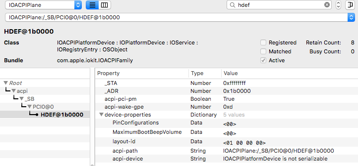

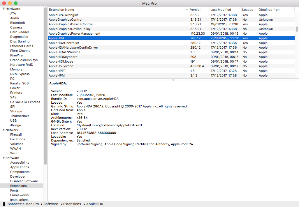

Shaneee Posted April 11, 2018 Share Posted April 11, 2018 Ok back again with a different board and now AppleHDA is being loaded on boot. AppleALC and Lilu are injected and loaded. I've tried layout 1, 2, 5, 7 and 11 but still no audio. Codec is ALC1220. HDEF is showing from Clover patch from AZAL. Here's my IOReg output, Shaneee’s Mac Pro.zip Link to comment Share on other sites More sharing options...

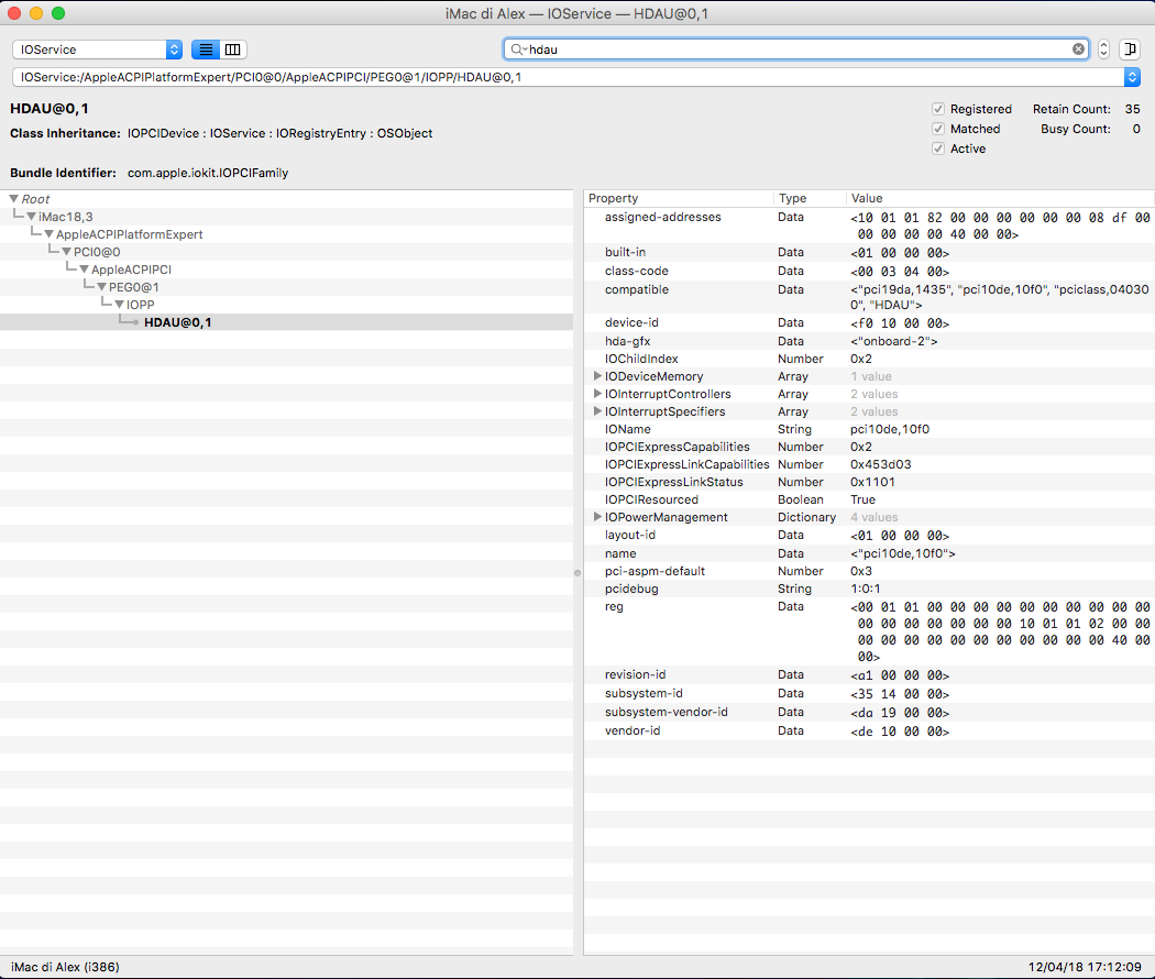

xelanaiznac Posted April 12, 2018 Share Posted April 12, 2018 (edited) hi guys. is someone here with 10.13.4 and pascal 1070? if so, have you hdmi audio working? it's base on gp104, here you are the hdau if needed Edited April 12, 2018 by xelanaiznac added picture Link to comment Share on other sites More sharing options...
xelanaiznac Posted April 12, 2018 Share Posted April 12, 2018 ok guys, patching clover with my hdau and now it's working. if you want you can add it to next applealc release. thank you! <dict><key>Comment</key> <string>pascal 1070 hdmi audio</string> <key>Disabled</key> <false/> <key>Find</key> <data> 3hALDg== </data> <key>InfoPlistPatch</key> <false/> <key>Name</key> <string>com.apple.driver.AppleHDAController</string> <key>Replace</key> <data> 3hDwEA== </data> Link to comment Share on other sites More sharing options...
