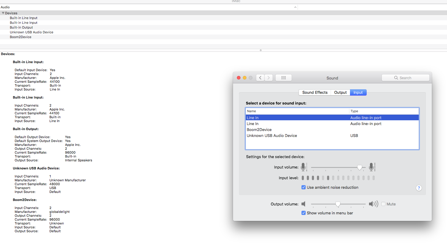

junoir Posted March 23, 2018 Share Posted March 23, 2018 (edited) Ok I can confirm that the blue Line In port in the back is working(used a 3,5mm cable connected to my phone playing music, which gets picked up properly in Audacity and the VU meter in the settings). The front mic port, for whatever reason doesn't pick up any sounds at all. Any ideas what's wrong? Although, to be fair, microphone/line-in is not a priority for me. If I happen to need to do some recordings, I would use a USB mic anyway. So it would be nice to have all the inputs working just in case some other user with the same codec would need it sometime in the future... Edited March 23, 2018 by junoir Link to comment Share on other sites More sharing options...

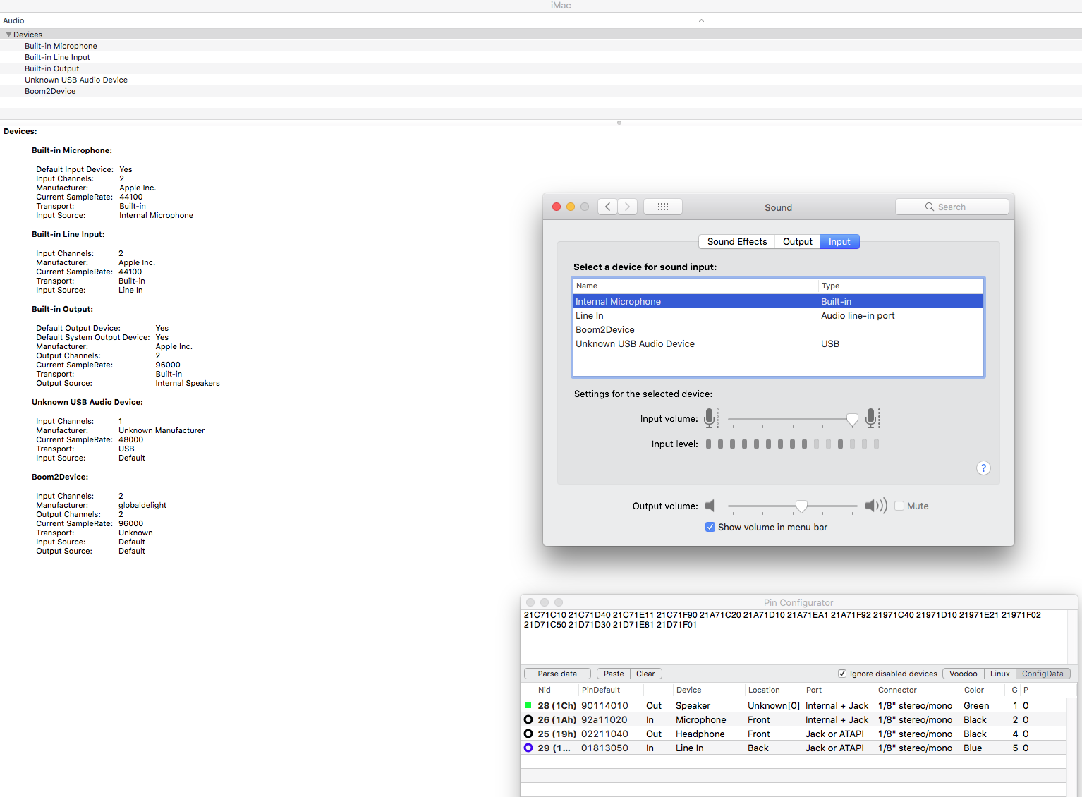

junoir Posted March 24, 2018 Share Posted March 24, 2018 (edited) Ok, I can confirm that front input is detected as line-in and music being played from my phone is being picked up now. Attached screenshot as to how it looks like in System Profiles and System Preferences(notice the VU meter). Is there any difference between the input being configured as line-in or as microphone? Edited March 24, 2018 by junoir 1 Link to comment Share on other sites More sharing options...

MacPeet Posted March 25, 2018 Share Posted March 25, 2018 @jin2k9 There is no rear mic in your dump. try this with 11 and 13: Trial_AppleALC.kext.zip front Mic now as LineIn and LineIn back blue (Input's are manual configured) @junoir Is there any difference between the input being configured as line-in or as microphone? Not necessarily. When it works, everything is fine. The inputs are often difficult under OSX. In the last trial AppleALC also your LayoutID 11 is renewed. Last attempt before sending for the release. Link to comment Share on other sites More sharing options...

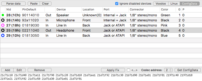

junoir Posted March 25, 2018 Share Posted March 25, 2018 Manual mode (layout id 11) works as expected, both line-ins showing. In SwitchMode I've made a change and configured the front mic as a microphone instead of line-in and set the port as internal+jack, and surprise, surprise, OSX sees it as an internal microphone now(see attached screenshot). Only thing missing now(for the sake of perfection) is the pink microphone input in the back at node 27, which I've tried adding the same way but it doesn't get detected. Regardless, I would consider this done 1 Link to comment Share on other sites More sharing options...
MacPeet Posted March 25, 2018 Share Posted March 25, 2018 (edited) @junoir great job I had cleared the 27 for first attempts, since there are only two input nodes (20 and 21). try this with 13: Trial_AppleALC.kext.zip Front Mic as internal, Back Mic as LineIn. Both in SwitchMode with input node 20. Platforms13.xml.zip Nodes: frontMic black 26 - 20 backMic pink as LineIn 27 - 20 LineIn back blue 29 - 21 21c71c10 21c71d40 21c71e11 21c71f90 21a71c20 21a71d10 21a71ea1 21a71f92 21b71c30 21b71d90 21b71e81 21b71f01 21971c40 21971d10 21971e21 21971f02 21d71c50 21d71d30 21d71e81 21d71f01 Edited March 25, 2018 by MacPeet Link to comment Share on other sites More sharing options...
