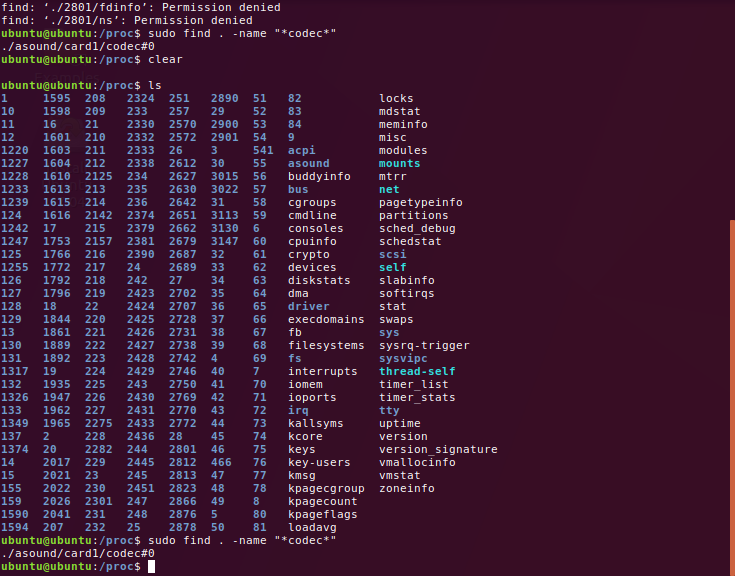

illfatedIM Posted May 14, 2017 Share Posted May 14, 2017 Is there anyone that could help me with a Creative X-Fi Titanium Pro PCIE (Emu20k2 - SB0880)? I've been trying to get anywhere for days but all I got is headaches. I tried dumping my codecs in linux but this card doesnt have any codecs in /proc/asound/. (Although everything works perfectly fine in Linux, even the mic) Even in the windows registry I couldn't find PinConfigOrerride for this card. VoodooHDA gives me Rear Analog Out - but everything else doesnt work. Now I'm using AppleALC + Lilu but I don't have any device available at all. Is there anyone that got a similiar creative card to work? All I really need is SPDIF Grey - Microphone/Lineout Rear - Analog Out Rear. Link to comment Share on other sites More sharing options...

illfatedIM Posted May 17, 2017 Share Posted May 17, 2017 All pretty simple. I've combined various guides and resources, found the missing scripts from a few Russian guides and translated everything into English. I've created a GitHub project for it here --> https://github.com/F0x1c/AppleALC_Instructions Thank you this is definitely worth the bookmark. However this tutorial fails for me like the others I've read already at Step 1. My card doesn't seem to have any codecs in linux even though everything is working perfectly fine there. Maybe I'm looking at the wrong place? card1 is my nvidia hdmi output Link to comment Share on other sites More sharing options...
MacPeet Posted May 17, 2017 Share Posted May 17, 2017 try this with Linux: cd ~/Desktop && mkdir CodecDump && for c in /proc/asound/card*/codec#*; do f="${c/\/*card/card}"; cat "$c" > CodecDump/${f//\//-}.txt; done && zip -r CodecDump.zip CodecDump Link to comment Share on other sites More sharing options...
illfatedIM Posted May 17, 2017 Share Posted May 17, 2017 try this with Linux: cd ~/Desktop && mkdir CodecDump && for c in /proc/asound/card*/codec#*; do f="${c/\/*card/card}"; cat "$c" > CodecDump/${f//\//-}.txt; done && zip -r CodecDump.zip CodecDump it only copied the codec from card1 (nvidia hdmi) 09: PCI 600.0: 0403 Audio device [Created at pci.378] Unique ID: vTuk.pLVyrDoIUU2 Parent ID: 96M4.DbhaNTHmnH9 SysFS ID: /devices/pci0000:00/0000:00:1c.6/0000:06:00.0 SysFS BusID: 0000:06:00.0 Hardware Class: sound Model: "Creative EMU20k2 [Sound Blaster X-Fi Titanium Series]" Vendor: pci 0x1102 "Creative Labs" Device: pci 0x000b "EMU20k2 [Sound Blaster X-Fi Titanium Series]" SubVendor: pci 0x1102 "Creative Labs" SubDevice: pci 0x0043 Revision: 0x04 Driver: "snd_ctxfi" Driver Modules: "snd_ctxfi" Memory Range: 0xf4200000-0xf420ffff (rw,non-prefetchable) Memory Range: 0xf4000000-0xf41fffff (rw,non-prefetchable) Memory Range: 0xf0000000-0xf3ffffff (rw,non-prefetchable) IRQ: 18 (546 events) Module Alias: "pci:v00001102d0000000Bsv00001102sd00000043bc04sc03i00" Driver Info #0: Driver Status: snd_ctxfi is active Driver Activation Cmd: "modprobe snd_ctxfi" Config Status: cfg=new, avail=yes, need=no, active=unknown Attached to: #13 (PCI bridge) thats the only "useful" thing I found with hwinfo CodecDump.zip Link to comment Share on other sites More sharing options...
Foxic Posted May 17, 2017 Share Posted May 17, 2017 what's the contents of /proc/? ls /proc/ Link to comment Share on other sites More sharing options...
joevt Posted May 17, 2017 Share Posted May 17, 2017 These are the commands I use for checking stuff in Ubuntu linux: # change directory to a folder on an ntfs drive that is readable in macOS: cd /media/joevt/Games/debugfs/Nvidia # make a new directory for the current audio and video you want information about: mkdir NvidiaDVI cd NvidiaDVI # get the sound info sudo find /proc/asound -type f -exec echo {} \; -exec cat {} \; &> 'asound.txt' # get some other info - for intel graphics, will include DPCD (DisplayPort Configuration Data) sudo find /sys/kernel/debug -path *dri* -type f -exec echo {} \; -exec cat {} \; &> 'All.txt' # get hdaudio info (not useful?) sudo find /sys/kernel/debug -path *hdaudio* -type f -not -name access -not -name registers -not -name range -exec echo {} \; -exec cat {} \; &> 'hdaudio.txt' # get video modes xrandr > 'xrandr.txt' # alsa is the sound driver in linux - alsa-info will get all the sound information alsa-info.sh --output 'alsa-info.txt' Maybe you can get some useful information using High Definition Audio (HD Audio) tool in Windows?https://msdn.microsoft.com/en-us/library/windows/hardware/dn613936(v=vs.85).aspx Link to comment Share on other sites More sharing options...
illfatedIM Posted May 17, 2017 Share Posted May 17, 2017 what's the contents of /proc/? ls /proc/ Thanks Joe I'll check the tool out and try the alsa-info edit: the windows tool cant find any audio device and here is what alsa-tools says: http://www.alsa-project.org/db/?f=4b28764e814d1cd2cf860b7ad30b5ce3f5289404 (it has 18.000 lines) Link to comment Share on other sites More sharing options...
joevt Posted May 17, 2017 Share Posted May 17, 2017 Thanks Joe I'll check the tool out and try the alsa-info edit: the windows tool cant find any audio device and here is what alsa-tools says: http://www.alsa-project.org/db/?f=4b28764e814d1cd2cf860b7ad30b5ce3f5289404 Looks like Ubuntu is not using an HDA driver for the X-Fi. You could try disabling the snd_ctxfi module in Ubuntu, to see if it will load an HDA driver instead. Then see if it is able to output audio. I don't know if Ubuntu will give any more useful info than VoodooHDA already did for you ( http://www.insanelymac.com/forum/topic/314406-voodoohda-290/page-14?do=findComment&comment=2423790). Maybe the graphing options of the guide could be modified to use the nodes listing provided by VoodooHDA's getdump. Or you could graph it manually. I think the snd_ctxfi driver is open source, so that might help solve some issues if you want to do some programming. VoodooHDA is also open source, so maybe you can fix Sound Blaster X-Fi support by modifying that. Link to comment Share on other sites More sharing options...
illfatedIM Posted May 18, 2017 Share Posted May 18, 2017 Looks like Ubuntu is not using an HDA driver for the X-Fi. You could try disabling the snd_ctxfi module in Ubuntu, to see if it will load an HDA driver instead. Then see if it is able to output audio. I don't know if Ubuntu will give any more useful info than VoodooHDA already did for you ( http://www.insanelymac.com/forum/topic/314406-voodoohda-290/page-14?do=findComment&comment=2423790). Maybe the graphing options of the guide could be modified to use the nodes listing provided by VoodooHDA's getdump. Or you could graph it manually. I think the snd_ctxfi driver is open source, so that might help solve some issues if you want to do some programming. VoodooHDA is also open source, so maybe you can fix Sound Blaster X-Fi support by modifying that. On module blacklisting Linux doesn't have any sound anymore. I've looked a bit through the sourcecode of the ctxfi driver but as a noob I'm not really sure what to look for but this seems like something (?):https://hastebin.com/ziseqeyufa.cs I attached the ctxfi folder from the linux kernel source if anyone wants to look through it. Interesting files seem to be: - ct20k2reg.h Registers - ctdaio.c This file contains the implementation of Digital Audio Input Output resource management object. - ctmixer.c This file contains the implementation of alsa mixer device functions. - ctmixer.h This file contains the definition of the mixer device functions. ctxfi.zip Link to comment Share on other sites More sharing options...
