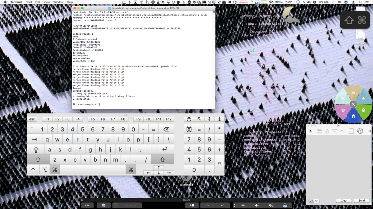

anddi Posted December 19, 2016 Share Posted December 19, 2016 Hello everyone, first time poster here. Seems I have hit a wall troubleshooting my fresh hackintosh installation. I cant get it to recognize any input/output audio devices. I'm running macOS Sierra 10.12.2 on my Spectre XT Pro 13-B000 Ultrabook. This laptop has IDT codec IDT92HD99BXX which should be supported as stated in here. I tried patching my AppleHDA earlier, but that didnt work either, so I restored the original AppleHDA.kext. I was told to use layout-id 3 for this codec in the wiki. This is my config.plist: <key>Audio</key> <dict> <key>Inject</key> <string>3</string> </dict> I also ran "sudo kextstat" and confirmed AppleALC is loaded before AppleHDA. AppleALC.kext is in /EFI/CLOVER/kexts/Other. I have rebooted several times, no dice. Any idea how to troubleshoot this issue further? EDIT: I used Mirone's AppleHDAPatcher to create a patched AppleHDA.kext for IDT92HD99BXX, and now I have working audio. I had to apply HPET & IRQ fix to my DSDT. AppleALC still isnt working, hoping someone has input on this (used vanilla AppleHDA when I tried ofc).. Maybe you could merge your recources, if AppleALC resources for IDT92HD99BXX are outdated? Link to comment Share on other sites More sharing options...
