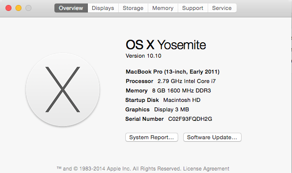

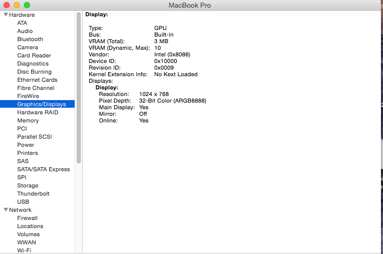

skrub Posted February 29, 2016 Share Posted February 29, 2016 (edited) Alright so I got Niresh's build of OS X Yosemite 10.10 installed on my laptop. Everything seems to work and I don't need safe mode to boot into the graphical environment. However, the mouse is extremely laggy, I have no QE/CI, and my resolution is locked to 1024x768 when I have a 1366x768 screen.System report claims I have 3mb VRAM when I know I should have more than that. No kexts were loaded. When I boot into verbose everything seems to work, but the last few lines before the login screen appears are:DSMOS has arrived[iOBluetoothHCIController][staticBluetoothTransportShowsUp] -- Received Bluetooth Controller register service notification -- 0xd800[iOBluetoothHCIController][start] -- completed[iOBluetoothHCIController::setConfigState] calling registerService**** [iOBluetoothHCIController][ProcessBluetoothTransportShowsUpActionWL] -- Connected to the transport successfully -- 0x2580 -- 0xc800 -- 0xd800 ****SNB Framebuffer did not show up, unloadSNB Framebuffer did not show up, unloadI have read different posts on this site and others, new kexts, deleting kexts, and even DSDT edits don't work. I've uploaded images of my Hardware Overview, OS X version and Graphics information below, along with a zip containing my entire kernel log and my system DSDT, only patched with this:Link removed - Please read our Rules.(MaciASL wouldn't let me save it with the errors) Please help. Files.zip Edited February 29, 2016 by Allan Tony's links removed. Link to comment Share on other sites More sharing options...

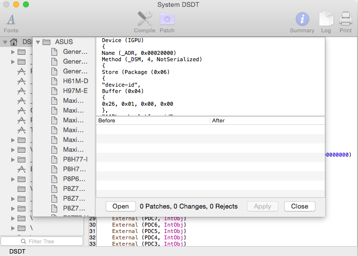

skrub Posted March 1, 2016 Author Share Posted March 1, 2016 MaciASL can't seem to read any of the DSDT patches. Link to comment Share on other sites More sharing options...
Allan Posted March 1, 2016 Share Posted March 1, 2016 RehabMan's repos can solve your problems: http://raw.github.com/RehabMan/Laptop-DSDT-Patch/master Link to comment Share on other sites More sharing options...

Allan Posted March 1, 2016 Share Posted March 1, 2016 Is not for you access, but add in MaciASL: DSDT/SSDT: Edit using MacIASL Link to comment Share on other sites More sharing options...
skrub Posted March 1, 2016 Author Share Posted March 1, 2016 So the error no longer appears at boot, but I still have 1024x768 resolution and no QE/CI. My graphics are now identified as "Display" and still with 3mb RAM as shown in the screenshots. Link to comment Share on other sites More sharing options...

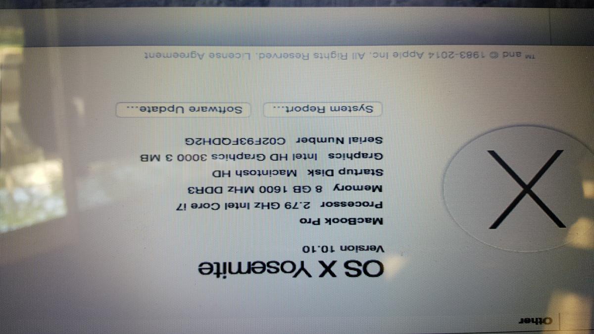

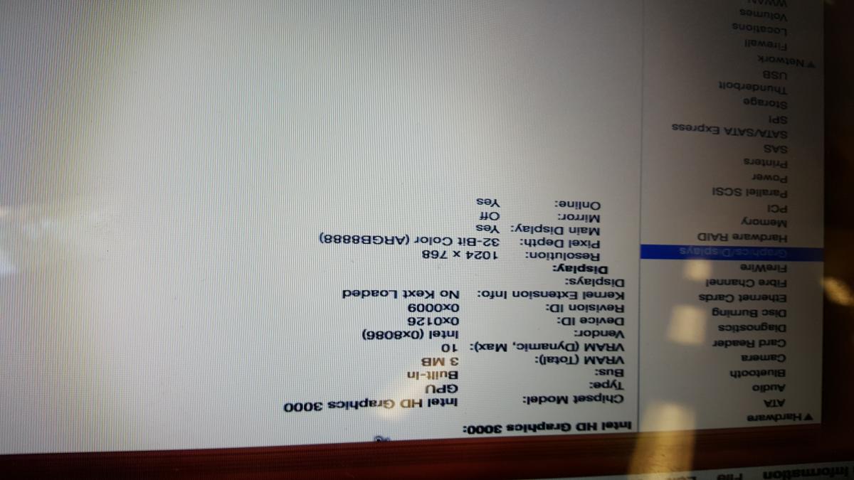

skrub Posted March 2, 2016 Author Share Posted March 2, 2016 Thanks, my installation is now reporting battery information. It turns out that System Information will only identify my HD3000 when I use GraphicsEnabler=Yes instead of IGPEnabler, (I'm using Chameleon, Clover stops booting halfway and there's no kernel panic or information that seems to help) So any IGP related DSDT edits may not work. They will probably have to use the GFX0 device name. 1 Link to comment Share on other sites More sharing options...
Allan Posted March 2, 2016 Share Posted March 2, 2016 Delete the GraphicsEnabler=Yes boot-flag, and try using only my DSDT. Did you tried use GraphicsEnabler=NO too? Link to comment Share on other sites More sharing options...
skrub Posted March 2, 2016 Author Share Posted March 2, 2016 Using GraphicsEnabler=No does the same thing IGPEnabler=Yes does, my GPU is identified as "Display" and I have 3mb VRAM. Deleting the GraphicsEnabler=Yes boot-flag and using your DSDT still gives me the SNB Framebuffer did not show up, unload. I've tried several boot-flags, including -f and nothing works. It seems however that Yosemite will ONLY identify my HD3000 using GraphicsEnabler=Yes, anything else and it shows up as "Display" in System Information. Link to comment Share on other sites More sharing options...
