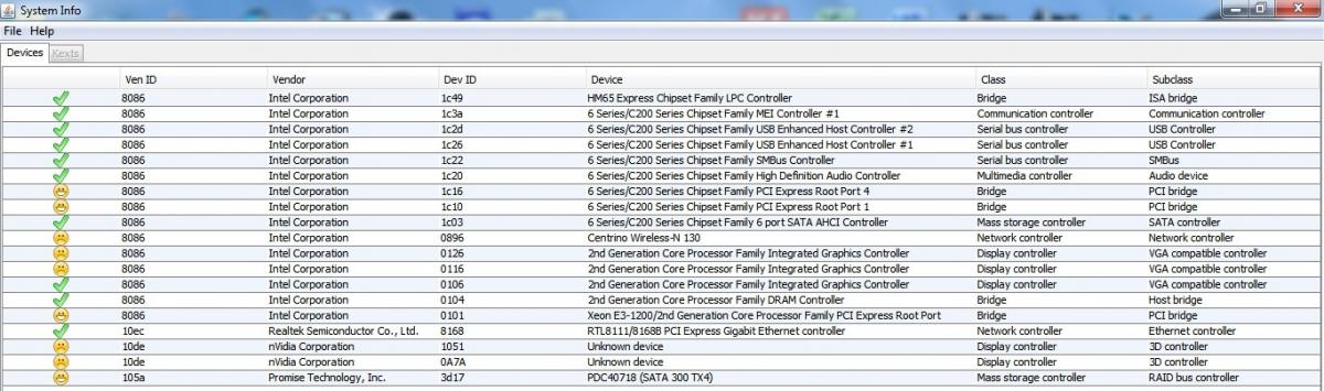

1. Nvidia 520mx 1GB DDR3 (detected and gets showed up as you can see here but 0 vga memory and info missing) , after reboot it dissapears from device list , if turned off device and used windows and boot windows for 2 times ( boot , turn off , boot ) it goes back on , stays on for windows but if i open osx again same loop i need to go through again , i cant disable the nvidia from my bios , no option to do so
http://www.insanelym...-2?do=findComment&comment=2218297
