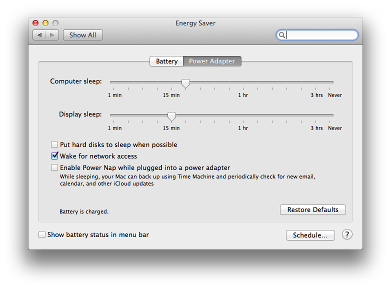

Allan Posted February 21, 2016 Share Posted February 21, 2016 You need apply USB patches in your DSDT. Also removing these methods can helps too: Method (_PRW, 0, NotSerialized) // _PRW: Power Resources for Wake { Return (GPRW (0x0D, 0x04)) } Uncheck this option - If you use: Link to comment Share on other sites More sharing options...
Ashanx Posted February 21, 2016 Author Share Posted February 21, 2016 You need apply USB patches in your DSDT. Also removing these methods can helps too: Method (_PRW, 0, NotSerialized) // _PRW: Power Resources for Wake { Return (GPRW (0x0D, 0x04)) } Uncheck this option - If you use: Screen Shot 2016-02-20 at 11.38.48 PM.png Thank you, I went ahead and added that to my dsdt and then also took uncheck allow wifi to wake. Still does not work, wakes up immediately Link to comment Share on other sites More sharing options...
