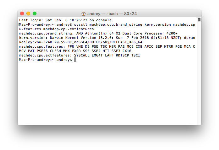

Dropbox and X-mirage apps are not launched, crash.
Process:               X-Mirage [581]
Path:                  /Applications/X-Mirage.app/Contents/MacOS/X-Mirage
Identifier:            com.xidasoft.X-Mirage
Version:               2.01.10 (2.01.10)
Code Type:             X86 (Native)
Parent Process:        ??? [1]
Responsible:           X-Mirage [581]
User ID:               501
Date/Time:             2016-02-06 18:28:32.889 +0200
OS Version:            Mac OS X 10.11.3 (15D21)
Report Version:        11
Anonymous UUID:        D95CE574-CA73-6E36-F9D7-22324E9971C6
Time Awake Since Boot: 200 seconds
System Integrity Protection: disabled
Crashed Thread:        0  Dispatch queue: com.apple.main-thread
Exception Type:        EXC_BAD_INSTRUCTION (SIGILL)
Exception Codes:       0x0000000000000001, 0x0000000000000000
Exception Note:        EXC_CORPSE_NOTIFY

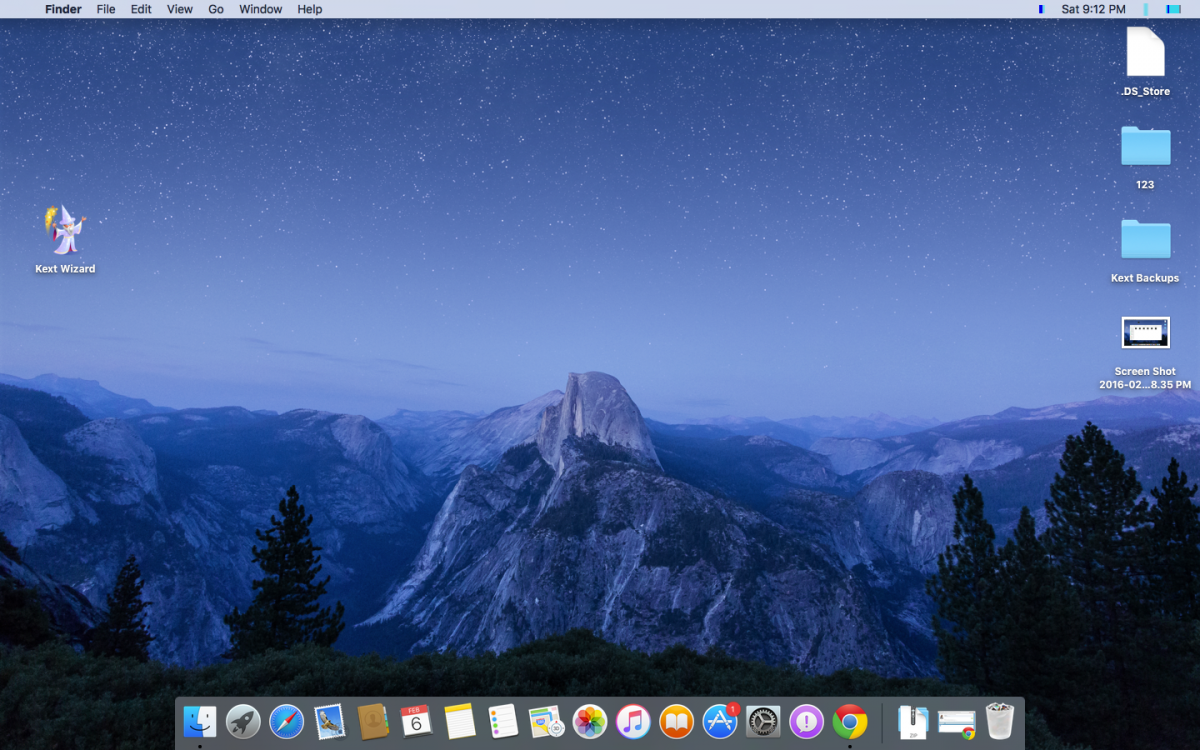

Same bug :( but with blue icons and the system is slower overall
Yeah would imagine it would be slower without SSSE3, SSE4.1 & SSE4.2
Just to confirm that they are disabled, please try this in the terminal
sysctl hw.optional.supplementalsse3
sysctl hw.optional.sse4_1
sysctl hw.optional.sse4_2
sysctl machdep.cpu.brand_string kern.version machdep.cpu.features machdep.cpu.extfeatures
If this shows up "unknown oid" please let me know if it was for all the sysctl hw.optional
SSE3 is the only one I enabled

Duran what did you change to turn the green icons blue?
Removed SSE4.1 & SSE4.2 completely (well commented them out instead of remove but same effect)

I have already made without SSSE3, did  crashes the system / crashes the apps, which is an incorrect way, duran + shaneee

Tested all three, none worked :(
Here's a screenshot of spakk's noSSE
