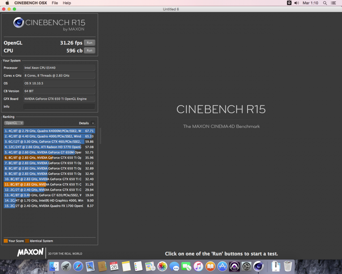

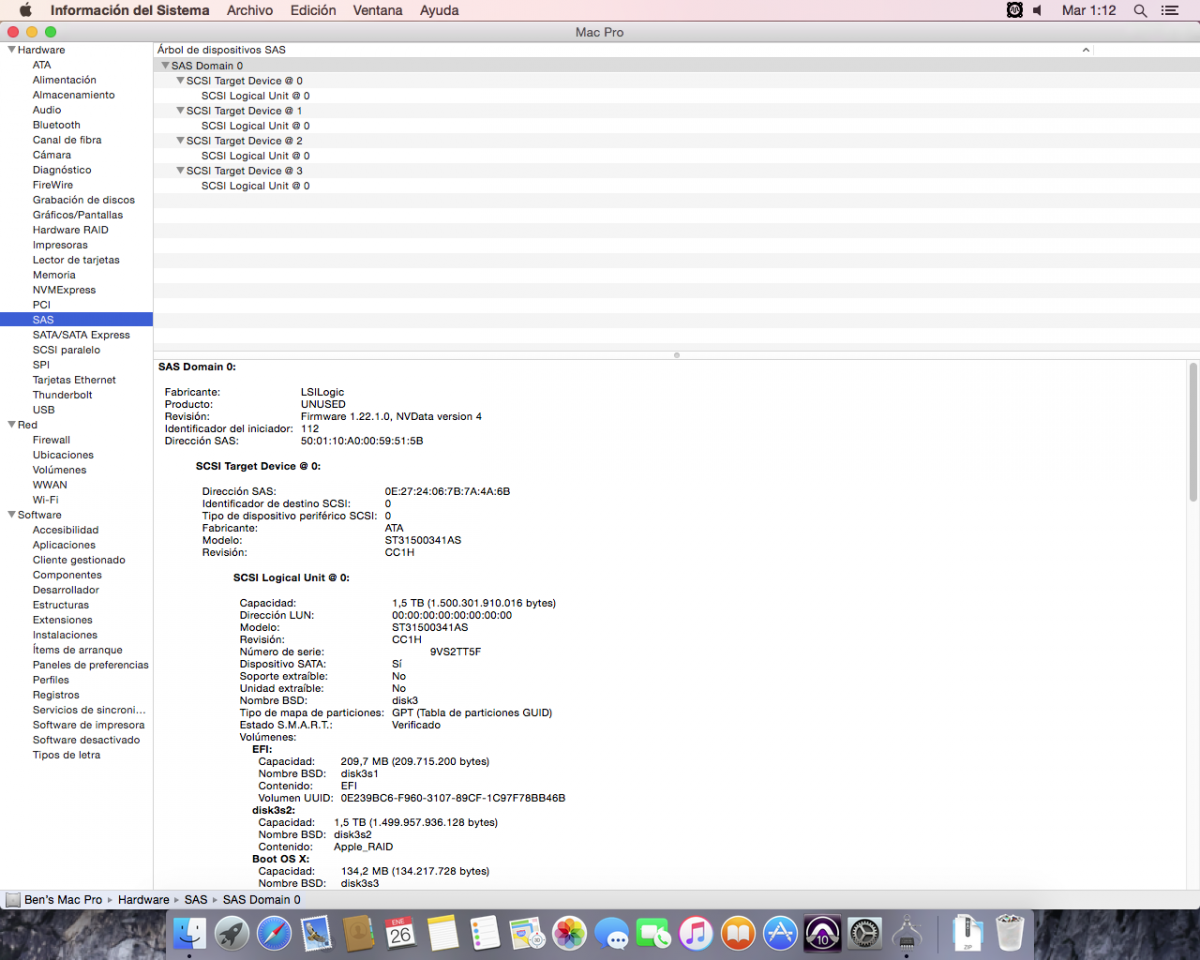

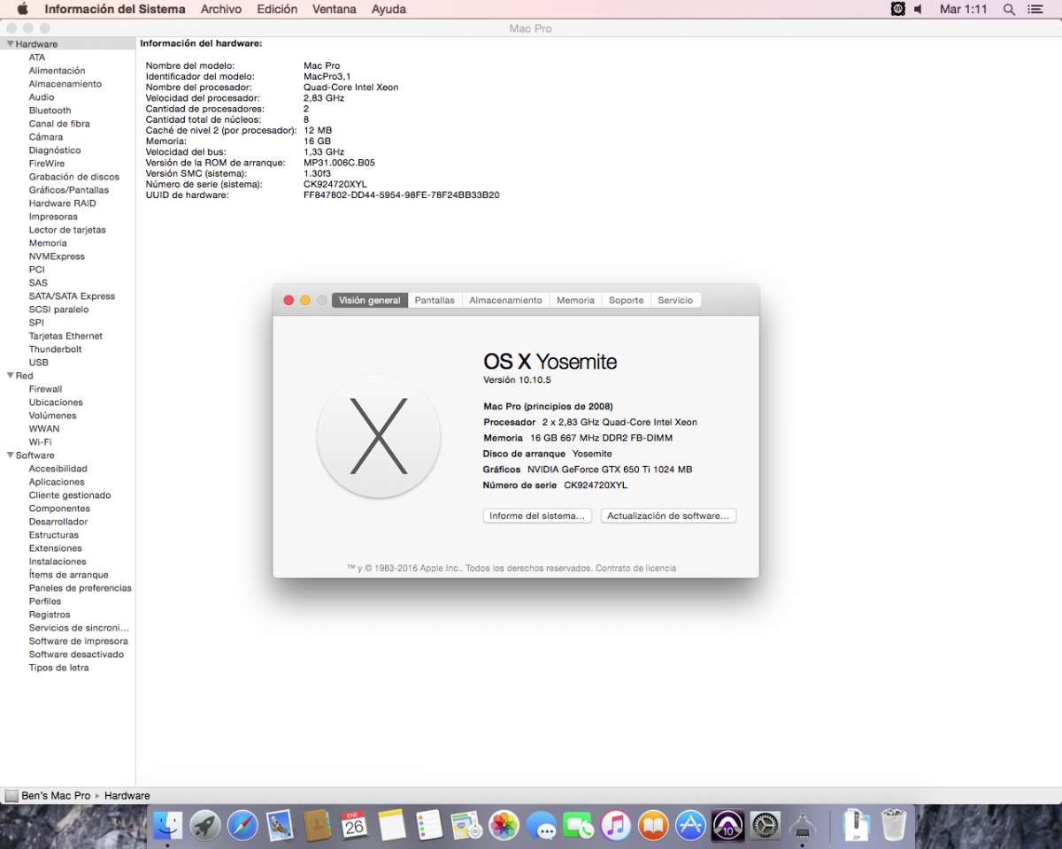

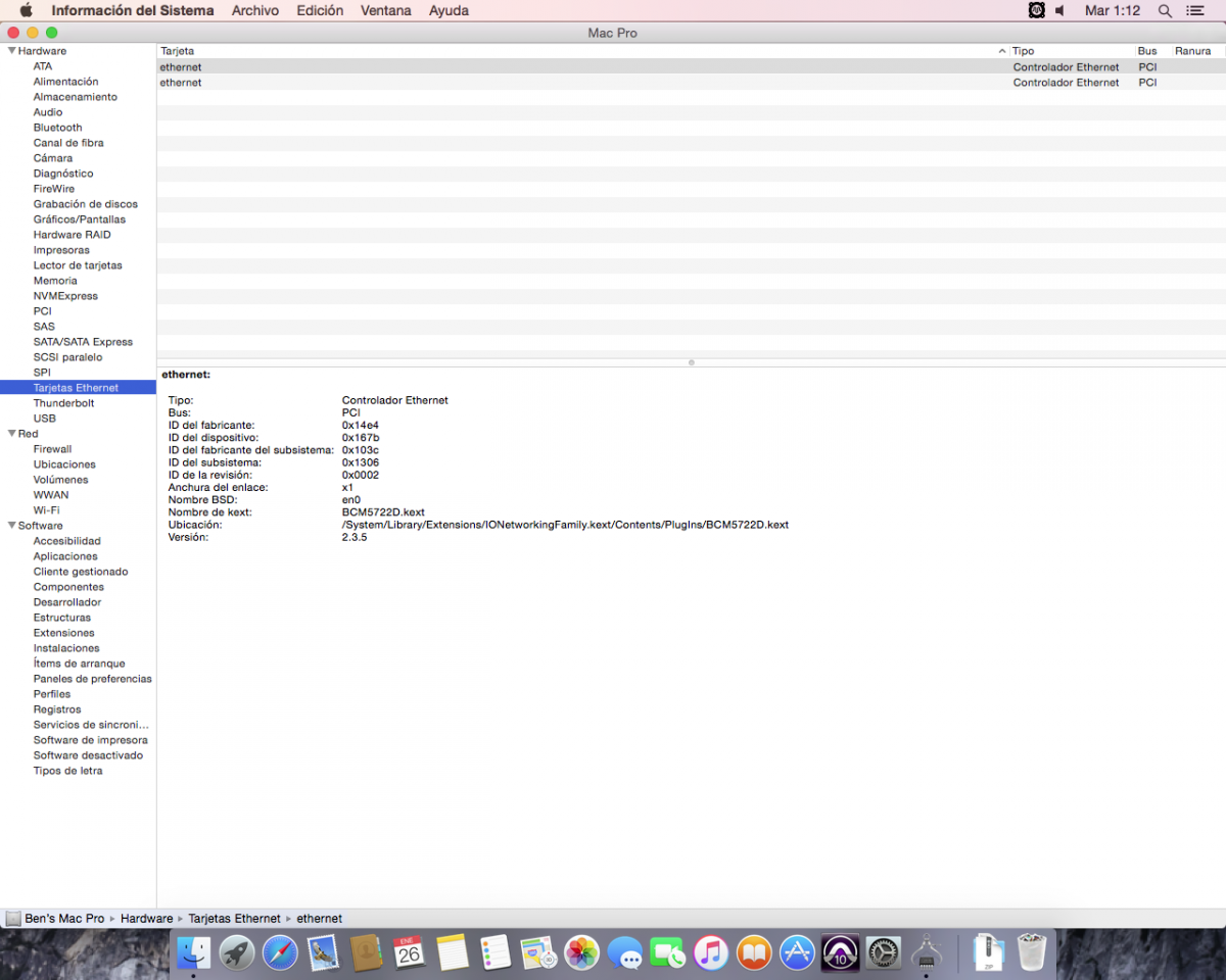

After a long fight with my old, but big machine, I finally managed to work correctly Yosemite 10.10.5 in my XW8600 workstation.
Again the problem was IOPCIFamily and ACPIPlatform, but overwriting the Yosemite IOPCIFamily binary with the old one from my other post (Mavericks 10.9.2 on HP XW8600 - Complete Desktops - InsanelyMac Forum), I could rebuild the cache and detect all devices.
The balance of damage is:

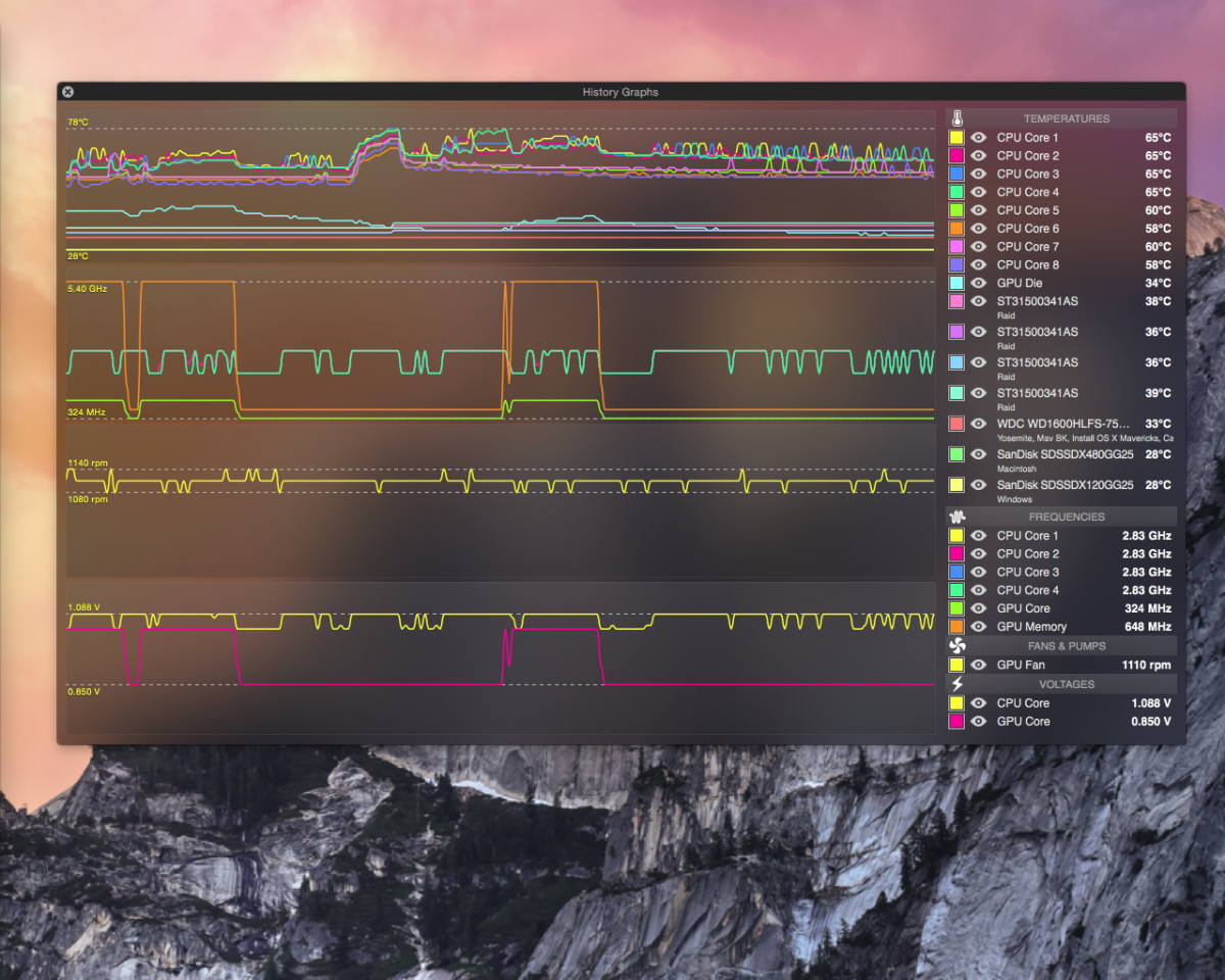

The processors are running a bit more warm than in Mavericks.
Firewire did not want to work with the old IOPCIFamily, so I had to rescue IOFirewireFamily from 10.9.5.
I lost AppleHDA functionality, so I'm using vooodoohda.
Still can not sleep. (Same as in Mavericks)
The rest is fully functional as I had at Mavericks.
I am quite happy because even though lately I have not much time to play with my hackintosh, I finally got a fairly stable installation.

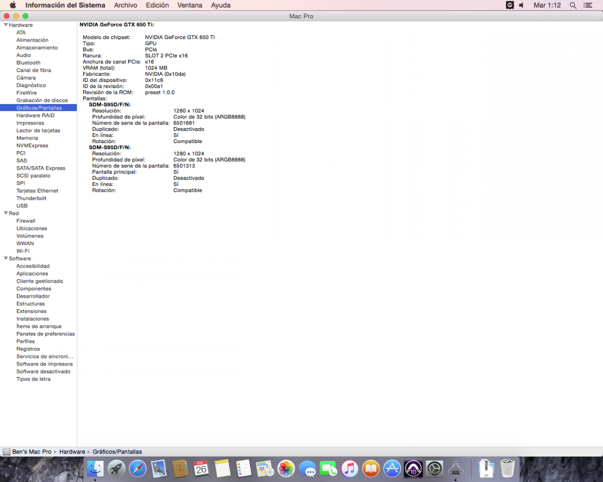

The good thing was, that I found that is running AGPM (without mod plist) whenever using only two monitors. It breaks when I connect the third.
I upload the kexts I've used.

HI Benjudas I see your first post
I dont know if you have bios option FSB Optimisation = ON
But for my DELL Precision 690
2X  Intel® Xeon® Processor X5355 (8M Cache, 2.66 GHz
​Before the change My first CPU 1 and 2  is at 61 to 65 and some time 71 with a big app running
I just find a good solution today Enable in bios FSB Optimisation = ON
And I  put a Fan to the low back of the Computer to squeeze out the hot air.
Now my result  :D
