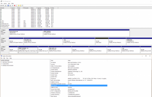

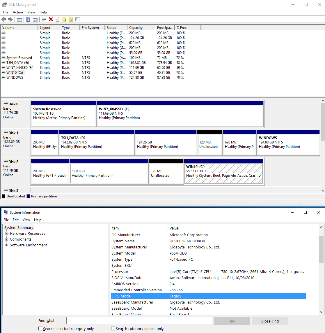

Out of curiosity, does Windows Disk Management show any active partition for your GPT disk?  Does system info show that you are booting in UEFI mode or legacy mode?
Eg1 Windows 10 booting in legacy mode from a hybrid MBR/GPT hard disk (disk 2) with Active Windows Partition

Eg2 Windows10 booting in UEFI mode from a Protective MBR/GPT hard disk (disk 2) with No Active Partition
