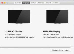

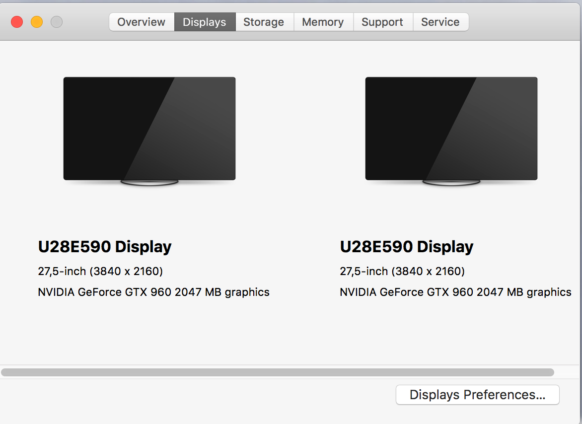

santi.ramirezv Posted February 5, 2016 Share Posted February 5, 2016 I think the black screen is already fixed! Problems with the software persist. With all of them. I have 32GB RAM, GTX960, Intel i7 4790k. There should be video running without dropframes at all with that hardware. Don't you think? hehe Thanks dude! Link to comment Share on other sites More sharing options...
