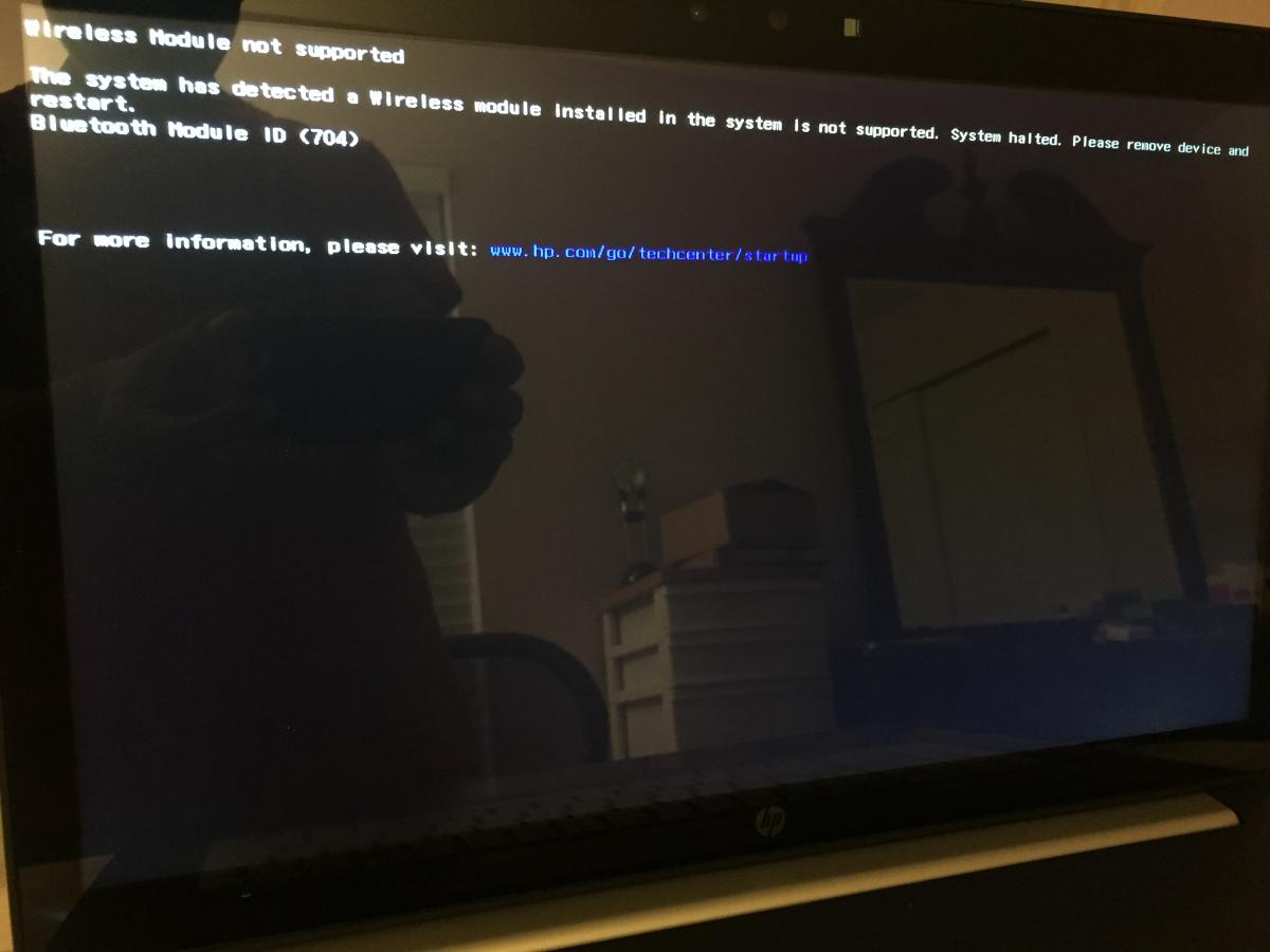

wen1 Posted June 10, 2016 Share Posted June 10, 2016 its here. i think its same as yours.. check it pls its here. i think its same as yours.. check it pls Thanks for posting this. I compared the bios files, they are identical. I am assuming you do not get any errors/warnings during boot up. Wonder why mine is not allowing me to get to even clover screen with the wireless card installed Edit: Reattaching the error I get. Wireless module not supported. System halted 1 Link to comment Share on other sites More sharing options...
Refresh-IT Posted June 10, 2016 Share Posted June 10, 2016 Thanks for posting this. I compared the bios files, they are identical. I am assuming you do not get any errors/warnings during boot up. Wonder why mine is not allowing me to get to even clover screen with the wireless card installed Edit: Reattaching the error I get. Wireless module not supported. System halted I have too this error message. if i push wireless module socket at boot, pc starts up normally. Not working normally. Ok? Link to comment Share on other sites More sharing options...
wen1 Posted June 10, 2016 Share Posted June 10, 2016 I have too this error message. if i push wireless module socket at boot, pc starts up normally. Not working normally. Ok? Got it now. Sorry did not realize that's what you meant when you first said it. When you push on the module, it is probably not detecting it properly and hence lets it go past the error. I wonder if there is pin that we can cut out on the card to get past this message. I have seen similar mods done before. Link to comment Share on other sites More sharing options...
Refresh-IT Posted June 10, 2016 Share Posted June 10, 2016 Got it now. Sorry did not realize that's what you meant when you first said it. When you push on the module, it is probably not detecting it properly and hence lets it go past the error. I wonder if there is pin that we can cut out on the card to get past this message. I have seen similar mods done before. Maybe pin 3 (+3.3v for bluetooth) im not sure. I think cuting the way then solder a button. But warranty is important for me. And pin ways microscopic. Is it possible for you? Thanks Link to comment Share on other sites More sharing options...

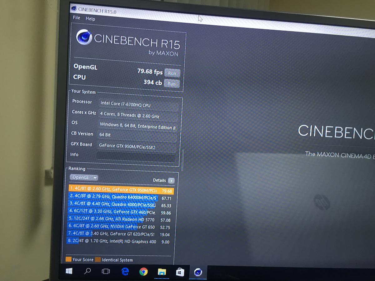

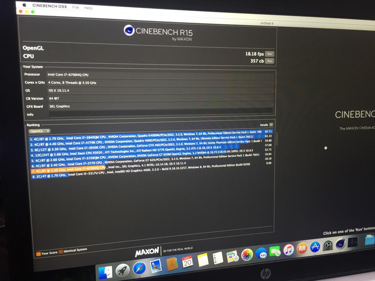

Refresh-IT Posted June 20, 2016 Share Posted June 20, 2016 Here of benchmarks Link to comment Share on other sites More sharing options...

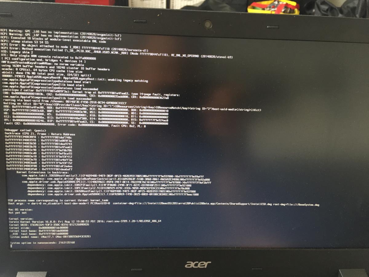

xerano Posted August 20, 2016 Share Posted August 20, 2016 its some time ago since ive tried to install mac osx on my Acer Skylake Notebook maybe someone can help me to refresh my mind Ive created a Clover 3716 USB Stick with latest Sierra Public Beta in my EFI Folder i have created under Kexts a 10.12 Folder and inserted 3 kexts: AHCI_3rd_party_SATA.kext USBInjectAll.kext FakeSMC.kext my Config.plist <?xml version="1.0" encoding="UTF-8"?> <!DOCTYPE plist PUBLIC "-//Apple//DTD PLIST 1.0//EN" "http://www.apple.com/DTDs/PropertyList-1.0.dtd"> <plist version="1.0"> <dict> <key>ACPI</key> <dict> <key>DSDT</key> <dict> <key>Debug</key> <false/> <key>DropOEM_DSM</key> <false/> <key>Fixes</key> <dict> <key>AddDTGP_0001</key> <true/> <key>FixHDA_8000</key> <true/> <key>FixHPET_0010</key> <true/> </dict> <key>Name</key> <string>DSDT.aml</string> <key>ReuseFFFF</key> <false/> </dict> <key>DropTables</key> <array> <dict> <key>Signature</key> <string>DMAR</string> </dict> <dict> <key>Signature</key> <string>SSDT</string> <key>TableId</key> <string>Cpu0Ist</string> </dict> <dict> <key>Signature</key> <string>SSDT</string> <key>TableId</key> <string>CpuPm</string> </dict> </array> <key>HaltEnabler</key> <true/> <key>SSDT</key> <dict> <key>DropOem</key> <false/> <key>EnableC6</key> <true/> <key>Generate</key> <true/> </dict> </dict> <key>Boot</key> <dict> <key>Arguments</key> <string>-v dart=0 nv_disable=1 kext-dev-mode=1 PCIRootUID=0</string> <key>Debug</key> <false/> <key>DefaultVolume</key> <string>LastBootedVolume</string> <key>Legacy</key> <string>PBR</string> <key>Secure</key> <false/> <key>Timeout</key> <integer>3</integer> <key>XMPDetection</key> <false/> </dict> <key>CPU</key> <dict> <key>UseARTFrequency</key> <false/> </dict> <key>Devices</key> <dict> <key>FakeID</key> <dict> <key>ATI</key> <string>0x0</string> <key>IMEI</key> <string>0x0</string> <key>IntelGFX</key> <string>0x0</string> <key>LAN</key> <string>0x0</string> <key>NVidia</key> <string>0x0</string> <key>SATA</key> <string>0x0</string> <key>WIFI</key> <string>0x0</string> <key>XHCI</key> <string>0x0</string> </dict> <key>USB</key> <dict> <key>AddClockID</key> <true/> <key>FixOwnership</key> <true/> <key>Inject</key> <true/> </dict> </dict> <key>DisableDrivers</key> <array> <string>Nothing</string> </array> <key>GUI</key> <dict> <key>Hide</key> <array> <string>\EFI\BOOT\BOOTX64.EFI</string> </array> <key>Language</key> <string>en:0</string> <key>Mouse</key> <dict> <key>DoubleClick</key> <integer>500</integer> <key>Enabled</key> <true/> <key>Mirror</key> <false/> <key>Speed</key> <integer>8</integer> </dict> <key>Scan</key> <dict> <key>Entries</key> <true/> <key>Legacy</key> <string>First</string> <key>Linux</key> <false/> <key>Tool</key> <true/> </dict> <key>ScreenResolution</key> <string>1920x1080</string> <key>Theme</key> <string>bootcamp</string> </dict> <key>Graphics</key> <dict> <key>DualLink</key> <integer>1</integer> <key>Inject</key> <dict> <key>ATI</key> <false/> <key>Intel</key> <true/> <key>NVidia</key> <false/> </dict> <key>NvidiaSingle</key> <false/> <key>ig-platform-id</key> <string>0x191B0000</string> </dict> <key>KernelAndKextPatches</key> <dict> <key>AppleRTC</key> <true/> <key>AsusAICPUPM</key> <false/> <key>Debug</key> <false/> <key>KernelCpu</key> <false/> <key>KernelHaswellE</key> <false/> <key>KernelLapic</key> <false/> <key>KernelPm</key> <true/> <key>KextsToPatch</key> <array> <dict> <key>Disabled</key> <false/> <key>Find</key> <data> wegQD7bw </data> <key>Name</key> <string>AppleAPIC</string> <key>Replace</key> <data> vhEAAACQ </data> </dict> <dict> <key>Comment</key> <string>External icons patch</string> <key>Disabled</key> <false/> <key>Find</key> <data> RXh0ZXJuYWw= </data> <key>Name</key> <string>AppleAHCIPort</string> <key>Replace</key> <data> SW50ZXJuYWw= </data> </dict> </array> </dict> <key>RtVariables</key> <dict> <key>BooterConfig</key> <string>0x28</string> <key>CsrActiveConfig</key> <string>0x67</string> </dict> <key>SMBIOS</key> <dict> <key>BiosReleaseDate</key> <string>09/22/2015</string> <key>BiosVendor</key> <string>Apple Inc.</string> <key>BiosVersion</key> <string>IM171.88Z.0105.B00.1509221819</string> <key>Board-ID</key> <string>Mac-DB15BD556843C820</string> <key>BoardManufacturer</key> <string>Apple Inc.</string> <key>BoardType</key> <integer>10</integer> <key>BoardVersion</key> <string>iMac17,1</string> <key>ChassisAssetTag</key> <string></string> <key>ChassisManufacturer</key> <string>Apple Inc.</string> <key>ChassisType</key> <string>13</string> <key>Family</key> <string>iMac</string> <key>LocationInChassis</key> <string>Part Component</string> <key>Manufacturer</key> <string>Apple Inc.</string> <key>ProductName</key> <string>iMac17,1</string> <key>SerialNumber</key> <string>XXXXXXXXXX</string> <key>Trust</key> <false/> <key>Version</key> <string>1.0</string> </dict> <key>SystemParameters</key> <dict> <key>InjectKexts</key> <string>Yes</string> <key>InjectSystemID</key> <true/> </dict> </dict> </plist> Thanks in Advance for help Link to comment Share on other sites More sharing options...
