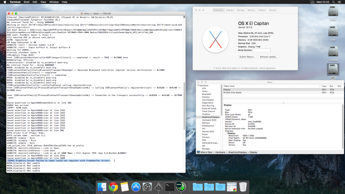

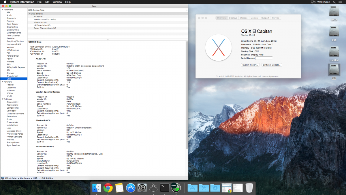

Mikoman Posted December 23, 2015 Share Posted December 23, 2015 Hi guys, i have finally managed to bypass the usb and waiting for root device issues and boot/install 10.11.2 on my hp envy. I found a working cfg but i was not able to open it in clover configurator so i ported all the data to a new file. Apart from this cfg i used the rehab's usbinjectall. But as i checked it now the installed osx is working even without it.I have working all 4 USB3.0 ports. I used ApplePS2Controller.kext to enable touchpad(not sure how to fix it in clover). Keyboard and web cam look like USB devices. So also working. What is not working is Wifi and it never will (AC-7265), LAN RTL8168 even if its green using rehab's driver and manual settings (dhcp not working) the packets are just not going out. So i am using my USB>LAN adapter for the moment. Also what bothers me most is the video acceleration for integrated intel HD 530. I tried some fake ids but without luck so far. ID is 191b:8086. I found some info on pike's site that this particular hd 530 is not in the list of supported skylake hd's but i pray for some fakeid workaround in the future. Looks like the issue with framebuffer as this is the error msg [IGPU] Graphics driver failed to load: could not register with Framebuffer driver! Here is the config <?xml version="1.0" encoding="UTF-8"?> <!DOCTYPE plist PUBLIC "-//Apple//DTD PLIST 1.0//EN" "http://www.apple.com/DTDs/PropertyList-1.0.dtd"> <plist version="1.0"> <dict> <key>ACPI</key> <dict> <key>DSDT</key> <dict> <key>Debug</key> <false/> <key>DropOEM_DSM</key> <false/> <key>Fixes</key> <dict> <key>AddDTGP_0001</key> <true/> <key>FixHDA_8000</key> <true/> <key>FixHPET_0010</key> <true/> </dict> <key>Name</key> <string>DSDT.aml</string> <key>ReuseFFFF</key> <false/> </dict> <key>DropTables</key> <array> <dict> <key>Signature</key> <string>SSDT</string> <key>TableId</key> <string>CpuPm</string> </dict> <dict> <key>Signature</key> <string>SSDT</string> <key>TableId</key> <string>Cpu0Ist</string> </dict> <dict> <key>Signature</key> <string>DMAR</string> </dict> </array> <key>HaltEnabler</key> <true/> <key>SSDT</key> <dict> <key>DropOem</key> <false/> <key>EnableC6</key> <true/> <key>Generate</key> <true/> </dict> </dict> <key>Boot</key> <dict> <key>Arguments</key> <string>-v dart=0 nv_disable=1 kext-dev-mode=1 PCIRootUID=0</string> <key>Debug</key> <false/> <key>DefaultVolume</key> <string>INSTALLER</string> <key>Legacy</key> <string>PBR</string> <key>Secure</key> <false/> <key>Timeout</key> <integer>3</integer> <key>XMPDetection</key> <false/> </dict> <key>Devices</key> <dict> <key>FakeID</key> <dict> <key>ATI</key> <string>0x0</string> <key>IMEI</key> <string>0x0</string> <key>IntelGFX</key> <string>0x0</string> <key>LAN</key> <string>0x0</string> <key>NVidia</key> <string>0x0</string> <key>SATA</key> <string>0x0</string> <key>WIFI</key> <string>0x0</string> <key>XHCI</key> <string>0x0</string> </dict> <key>USB</key> <dict> <key>AddClockID</key> <true/> <key>FixOwnership</key> <true/> <key>Inject</key> <true/> </dict> </dict> <key>DisableDrivers</key> <array> <string>Nothing</string> </array> <key>GUI</key> <dict> <key>Hide</key> <array> <string>\EFI\BOOT\BOOTX64.EFI</string> </array> <key>Language</key> <string>en:0</string> <key>Mouse</key> <dict> <key>DoubleClick</key> <integer>500</integer> <key>Enabled</key> <true/> <key>Mirror</key> <false/> <key>Speed</key> <integer>8</integer> </dict> <key>Scan</key> <dict> <key>Entries</key> <true/> <key>Legacy</key> <string>First</string> <key>Tool</key> <true/> </dict> <key>ScreenResolution</key> <string>1920x1080</string> <key>Theme</key> <string>bootcamp</string> </dict> <key>Graphics</key> <dict> <key>DualLink</key> <integer>1</integer> <key>Inject</key> <dict> <key>ATI</key> <false/> <key>Intel</key> <false/> <key>NVidia</key> <false/> </dict> <key>NvidiaSingle</key> <false/> </dict> <key>KernelAndKextPatches</key> <dict> <key>AppleRTC</key> <true/> <key>AsusAICPUPM</key> <false/> <key>Debug</key> <false/> <key>KernelCpu</key> <false/> <key>KernelHaswellE</key> <false/> <key>KernelLapic</key> <true/> <key>KernelPm</key> <true/> <key>KextsToPatch</key> <array> <dict> <key>Find</key> <data> wegQD7bw </data> <key>Name</key> <string>AppleAPIC</string> <key>Replace</key> <data> vhEAAACQ </data> </dict> <dict> <key>Comment</key> <string>External icons patch</string> <key>Find</key> <data> RXh0ZXJuYWw= </data> <key>Name</key> <string>AppleAHCIPort</string> <key>Replace</key> <data> SW50ZXJuYWw= </data> </dict> </array> </dict> <key>RtVariables</key> <dict> <key>BooterConfig</key> <string>0x28</string> <key>CsrActiveConfig</key> <string>0x67</string> </dict> <key>SMBIOS</key> <dict> <key>BiosReleaseDate</key> <string>09/22/2015</string> <key>BiosVendor</key> <string>Apple Inc.</string> <key>BiosVersion</key> <string>IM171.88Z.0105.B00.1509221819</string> <key>Board-ID</key> <string>Mac-DB15BD556843C820</string> <key>BoardManufacturer</key> <string>Apple Inc.</string> <key>BoardType</key> <integer>10</integer> <key>BoardVersion</key> <string>iMac17,1</string> <key>ChassisAssetTag</key> <string></string> <key>ChassisManufacturer</key> <string>Apple Inc.</string> <key>ChassisType</key> <string>13</string> <key>Family</key> <string>iMac</string> <key>LocationInChassis</key> <string>Part Component</string> <key>Manufacturer</key> <string>Apple Inc.</string> <key>ProductName</key> <string>iMac17,1</string> <key>SerialNumber</key> <string>XXXXXXXXXX</string> <key>Trust</key> <false/> <key>Version</key> <string>1.0</string> </dict> <key>SystemParameters</key> <dict> <key>InjectKexts</key> <string>Yes</string> <key>InjectSystemID</key> <true/> </dict> </dict> </plist> feel free to try the cfg and i am also open to do any tests and to receive any advice PS: merry xmass to everyone Link to comment Share on other sites More sharing options...
aduket Posted December 27, 2015 Share Posted December 27, 2015 This is great ! Can you please update your hackintosh's status and also elaborate a bit more your steps to make this configuration working ? I think this is the first 6700hq based laptop, running hackintosh. Please continue updating, good luck !Intel hd 530 seems to be working for this fellow. Did you try this ? :>" Graphics cards (AMD or NVIDIA) boot to black screen unless safe mode or nv_disable=1 is used. Intel HD 530 graphics is working to boot to desktop with latest Clover v3292 using no ig-platform-id inject or SMBIOS. "And can you also write your laptop's configuration ?Ok I think, this is your laptop, right:http://www.notebookcheck.net/HP-Envy-17-n107ng-Notebook-Review.155893.0.htmlis your chipset also hm170 ? And your ram, is it ddr3l or just ddr3? Link to comment Share on other sites More sharing options...
Mikoman Posted December 27, 2015 Author Share Posted December 27, 2015 Hi, My laptop is HP ENVY 17 n-103nc DDR3L 8gb installed. Chipset is Intel HM170. Basically all what i did is created a install USB with universal installer v7. Updated to latest clover 3320 and copied the config.plist over. The config file have APIC patch from piker using string replacement and also i had to enable KernelLAPIC patch. Without this i was getting kernel panic. As i mentioned i used rehab's usbinjectall kext but not sure if this is even required because now it is booting without it and no problems at all. All usb are working as 3.0 I am using imac17 smbios. I will try different ones maybe it will help. The guy on that post says the hd 530 is working. But the question is if he has full acceleration or not. I posted on piker's forum. He has the same cpu (desktop version) with same HD 530. Maybe he will figure something out. Link to comment Share on other sites More sharing options...

Mikoman Posted January 2, 2016 Author Share Posted January 2, 2016 Xerano try to set KernelLapic to false. Otherwise i don't see anything wrong. What's your clover version? You have Inject Intel set to false in that config, definitely won't work like that. Set it to true and also inject an ig-platform-id. I'd start with 0x191B0000 which matches your native device and is contained in the framebuffer. I have graphics acceleration working on my Surface Pro 4, but there are loads of artifacts. I imagine it's because the skylake framebuffer is incomplete at this point. Yeah i know, i am using it. I was trying lots of configs and must have pasted the one without it. Anyways i also tried pike's framebuffer patch https://pikeralpha.wordpress.com/2015/11/18/home-sweet-home/ to get QE/CI but without luck. Different platform id's make no difference. I am still getting the framebuffer error. Update to 10.11.3 beta also did not solve anything. But i think they were not focusing to fix framebuffer so far. Only what is left is to wait and hope. Link to comment Share on other sites More sharing options...

Mikoman Posted January 9, 2016 Author Share Posted January 9, 2016 So far no luck. But i think i need to get more deep into it. But as pike mentioned in his post ------ 0000 1219 0103 0303 0000 0004 0000 20020000 5001 0000 0060 6C05 0000 6C05 00000000 0000 0000 0000 FF00 0000 0100 00004000 0000 0105 0900 0004 0000 0705 00000204 0A00 0004 0000 0705 0000 0306 0A000004 0000 0705 0000 0601 0000 0000 08000200 0000 0400 0000 80DF 1710 0000 00007805 0000 D205 0000 4006 0000 0000 00000000 0000 0000 0000 Or a slightly modified one, but I use this: 0300 1219 0001 0101 0000 0002 0000 30010000 0000 0000 0060 9914 0000 9914 00000000 0000 0000 0000 FF00 0800 0002 00004000 0000 FF05 0000 0100 0000 4000 0000FF04 0000 0100 0000 4000 0000 FF00 00000100 0000 4000 0000 0000 0000 0000 00000000 0000 0000 0000 0000 0000 0000 00000000 0000 0000 0000 0000 0000 0000 00000000 0000 0000 0000 --------- the second framebuffer data is not modified just on places he marked. As you can see they are totally different data. So i am a bit confused. Anyways i fixed one thing, one also important thing. LAN. Using rehabs latest rtl8111 driver (12/30/2015) the LAN now works. So no more external USB adapter. So far its pretty stable. DHCP also works. Link to comment Share on other sites More sharing options...
