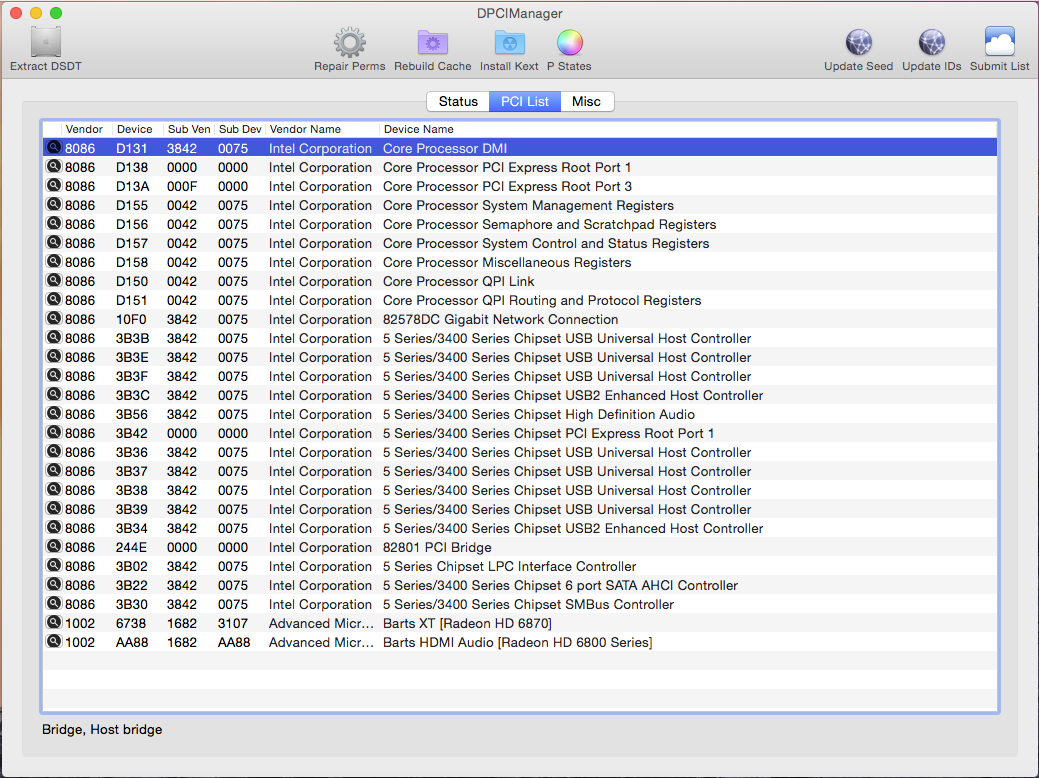

pathosmusic Posted December 8, 2015 Author Share Posted December 8, 2015 I am not so familiar with DSDT editing... but my chip reads in DPCIManager (when it is working) as intel 82578dc Link to comment Share on other sites More sharing options...
