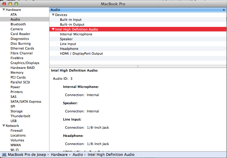

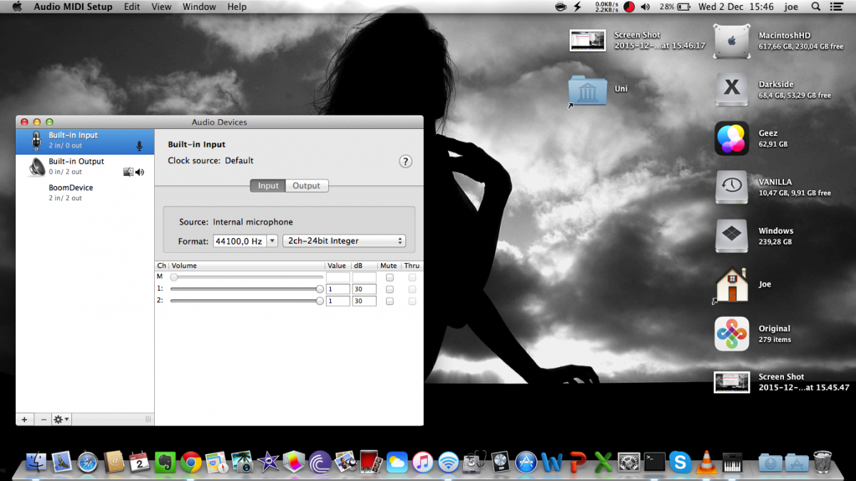

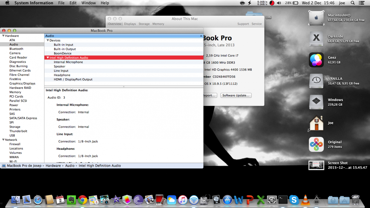

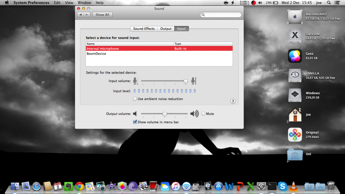

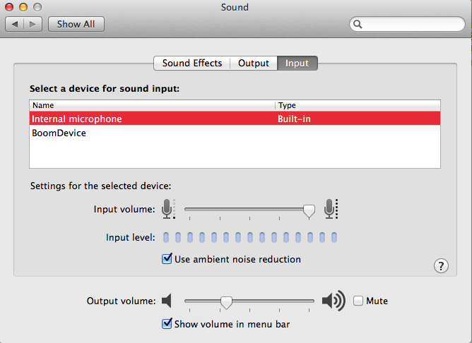

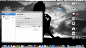

kosakgroove Posted December 2, 2015 Share Posted December 2, 2015 I dont know what it is, but my Internal laptop Mic is detected thanks to the patched AppleHDA, and OSX reports it as working, but no matter how loud, the input seems to be 0..Internal speakers and microphone/Headphone jack all work wonderfully. I use audio layout 3 Any help would be appreciated...Realtek ALC233Asus X550LDVIntel core i7Mac OSX 10.9.5(sound has always worked with patched AppleHDA, in many OSX versions, but the mic never has, and it would be so awesome if it did)Thanks a lot! Attaching pictures of system info, sound pref, and midi setup Link to comment Share on other sites More sharing options...

kosakgroove Posted December 2, 2015 Author Share Posted December 2, 2015 Check if in S/L/E are not any HDAEnabler, DummyHDA, or any option about audio in config.plist, e.g: Screen Shot 2015-12-02 at 4.50.25 PM.png If there is something like that, remove, and use just the patched AppleHDA. Repair the disk permissions, and run this commands: sudo touch /System/Library/Extensions sudo nvram -c Hi my friend! Tried all of what you said to no avail... Everything remains the same... Is this a problem with my mic?? Becauseit is detected, but the master volume in midi setup is 0 Link to comment Share on other sites More sharing options...

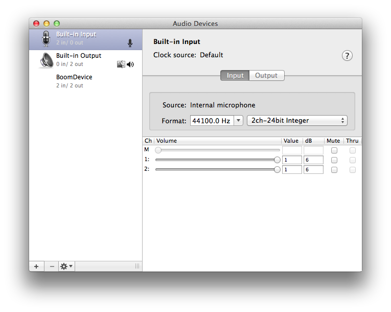

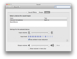

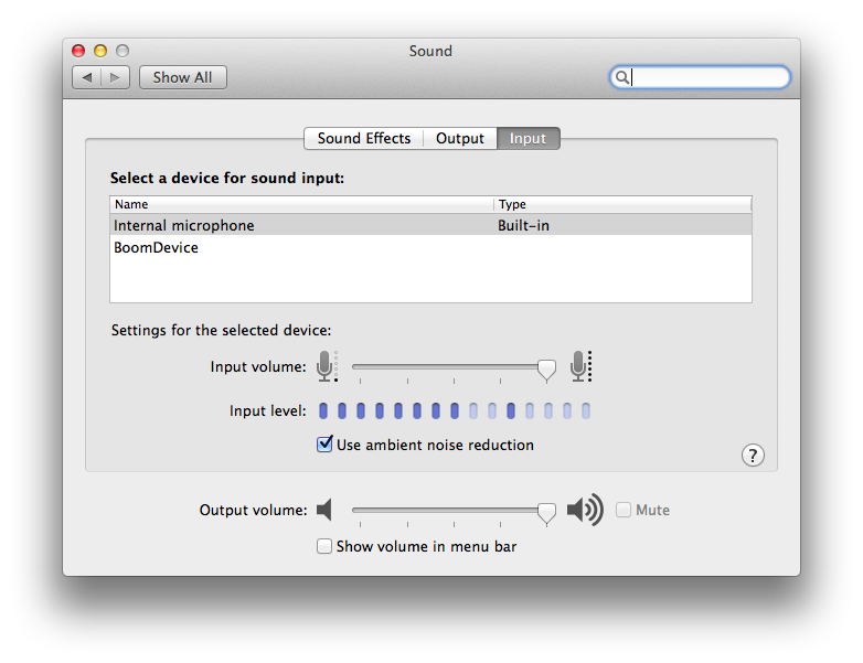

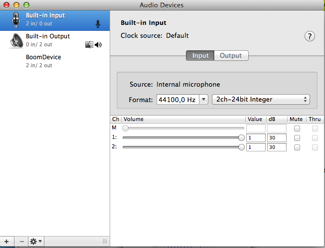

Allan Posted December 2, 2015 Share Posted December 2, 2015 That's strange because here, my settings are the same like you: MIDI: Microphone - I made some noise (hissing), and we can see the bar moving... Link to comment Share on other sites More sharing options...

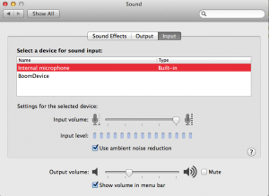

kosakgroove Posted December 2, 2015 Author Share Posted December 2, 2015 That's strange because here, my settings are the same like you: MIDI: Screen Shot 2015-12-02 at 5.21.30 PM.png Microphone - I made some noise (hissing), and we can see the bar moving... Screen Shot 2015-12-02 at 5.21.17 PM.png if theres anything i can do to debug the issue id loveto help. Here itsme screaming to the mic: Link to comment Share on other sites More sharing options...

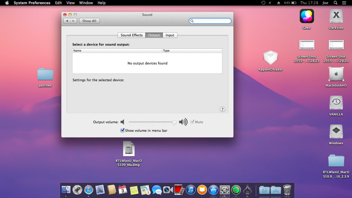

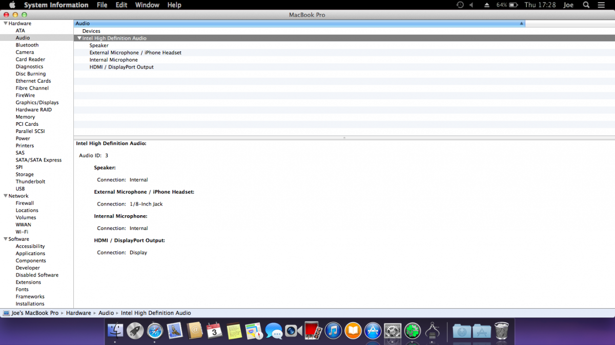

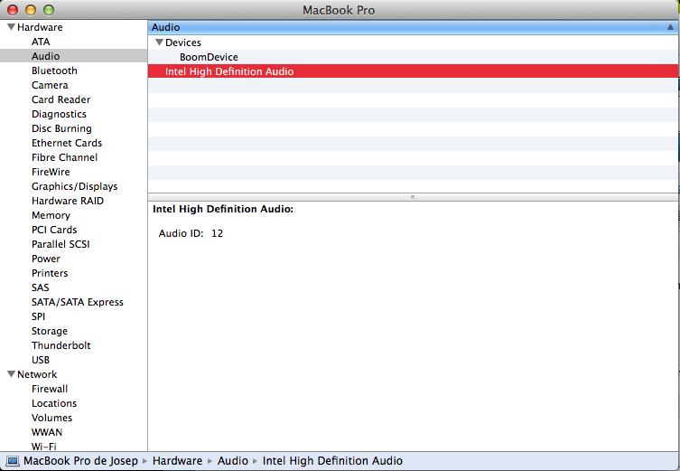

kosakgroove Posted December 3, 2015 Author Share Posted December 3, 2015 Ok. Here: Archive.zip Install your vanilla AppleHDA (remove the patched first) and install DummyHDA. Use the modified config.plist, and repair the disk permission, btw use the commands that i've sent to you before. Ok man! Using everything you said, it gets detected different than before, but now there is no sound whatsoever, and in sound preferences 0 choices. In system report though something new comes up, and it describes my hardware better.. I think we are much closer to solving this.. Do you know why my audio doesnt work now? After removing patched AppleHDA, putting the vanilla one and the dummy kext, cleaned nvram, rebuilt cache, changed to the config plist you gave me... Any help? Ok man! Using everything you said, it gets detected different than before, but now there is no sound whatsoever, and in sound preferences 0 choices. In system report though something new comes up, and it describes my hardware better.. I think we are much closer to solving this.. Do you know why my audio doesnt work now? After removing patched AppleHDA, putting the vanilla one and the dummy kext, cleaned nvram, rebuilt cache, changed to the config plist you gave me... Any help? This is system info in my other install of mavericks, where sound works with mirone's patch applehda You can notice a big difference in terms of naming.. The pics with the black menubar and black dock are mavericks as well,where i have been trying all your suggestions, and where it detects iphone headset, and sound doesnt work at all with the dummy kext.. Maybe thats the issue.. i really dont know In the black mavericks install, all the components are detected the way they should, but sound doesnt work at all.. In the other install, it's detected with mistakes related to my hardware, but it works (with exception of microphone of course) What's your suggestion? Link to comment Share on other sites More sharing options...
