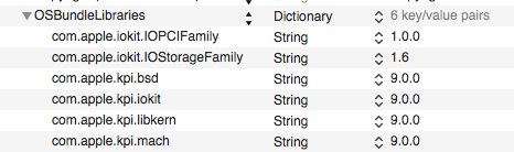

irenabyss Posted December 22, 2015 Share Posted December 22, 2015 maybe thats because of the requirements of the bundle libraries inside the driver? (not sure if thats actually a problem..) have you tried to run the cli: ./nvme-cli list to see if your device gets detected via the driver? Thanks. When I run this I get: nvme-list: libudev not detected, install and rebuild. Any thoughts on where to from here - is it an el capitan vs yosemite issue or something else? Link to comment Share on other sites More sharing options...

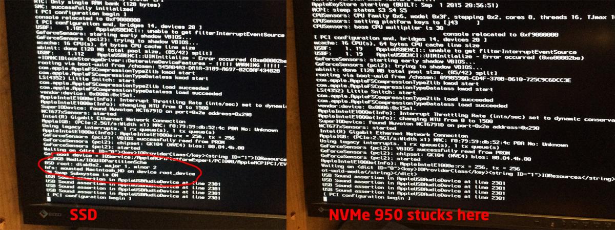

Smallersen Posted January 14, 2016 Share Posted January 14, 2016 Hi Jan, my impression is that a lot of people still have problems to boot from NVMe, specially unreliable booting. See several threads here and at Tony. People already sell their 950 Pro to get a AHCI 951. You can be lucky if everything works at your system. I myself could only boot once from my 950 Pro NVMe on Yosemite, never again. Cant investigate further in the moment (my X99 is in service). As I figured out, the disks were not mounted when booting from NVMe, very late during boot, see attached screenshots compared to a working boot process. "BSD root: ... + hfs: mounted (system disk)" is missing. Link to comment Share on other sites More sharing options...
jan-munich Posted January 14, 2016 Author Share Posted January 14, 2016 Hey Sammlersen, that clarifies it, well I also had problems with NVMe Boot which originated from my bios @ gigabyte Z170. So after a little back and forth chatting with their support they pushed 2 beta versions and the second now works fine (Fast Boot + Skylake APCI Register fix included in the bios) But well im running skylake with on-board m.2. Maybe the X99 have some more problems.. :/ To quickly state the problems I had before the bios fix: 1. No boot if I disabled other sata devices in bios. 2. Usually using my wrong boot device (sata) to boot. 3. Could randomly find my UEFI boot on NVMe (So thats why i contacted gigabyte, to tell them their UEFI boot on NVMe is corrupted..) In the meantime i came with an itermediate solution until gigabyte fixed the bios : Installing clover onto a sata boot device boot clover from there and then select my nvme device in clover.. this worked fine and 100%. Finally i got rid of this workaround as the bios provided fixed it for me. - Kudos to gigabyte support even if they told me not officially supporting hackintoshes they helped me out. (Well it was UEFI boot issue anyway..) Regards Jan Link to comment Share on other sites More sharing options...
Smallersen Posted January 14, 2016 Share Posted January 14, 2016 I have added some information to my former post. I´ve already tried most of the thing on your list, specially to load EFI from a normal SSD and switch to NVMe system in Clover - no success. I did not try to enable all volumes in BIOS. This normally stops successful booting. Link to comment Share on other sites More sharing options...
jan-munich Posted January 14, 2016 Author Share Posted January 14, 2016 But you installed the NvmeGeneric.kext to kexts/Other on your SSD right? What if you boot the osx installer with the kext in place do you see the drive? From your screenshot I can't see the driver is loading. Have you verified there is a log output and the nvme driver gets loaded properly? Link to comment Share on other sites More sharing options...
Smallersen Posted January 14, 2016 Share Posted January 14, 2016 Only the NVMe disk was installed, the clover screen appeared, everything looked pretty much the same as the normal SSD boot until the very end and mount process. But I´ve no idea whether the driver was loaded. I had the driver installed in S/L/E and later in S/L/E and Clover folder. Other user reported to have still problems when the driver was only installed in Clover folder. Link to comment Share on other sites More sharing options...
jan-munich Posted January 14, 2016 Author Share Posted January 14, 2016 you should see this in your debug.log / system.log or clover boot log: 14/01/16 14:34:14,000 kernel[0]: NVMeGeneric: com_MinnowStor_NVMeDisk::start 14/01/16 14:34:14,000 kernel[0]: NVMeGeneric: This driver must be licensed for commercial use. 14/01/16 14:34:14,000 kernel[0]: NVMeGeneric: This driver may not be posted, distributed, bundled, shared, or sold without the written consent of MinnowStor.com 14/01/16 14:34:14,000 kernel[0]: NVMeGeneric: This driver is free for personal, non-commercial use. 14/01/16 14:34:14,000 kernel[0]: NVMeGeneric: No guarantee of performance, suitibility, or warranty expressed or implied. Use at your own risk. 14/01/16 14:34:14,000 kernel[0]: NVMeGeneric: Copyright 2015 MinnowStor, all rights reserved. 14/01/16 14:34:14,000 kernel[0]: NVMeGeneric: devid a802144d subdev a801 14/01/16 14:34:14,000 kernel[0]: NVMeGeneric: desc SM951 512 GB SSD [m.2] 14/01/16 14:34:14,000 kernel[0]: NVMeGeneric: unable to map BAR4 resources 14/01/16 14:34:14,000 kernel[0]: NVMeGeneric: MSICAP: 86 14/01/16 14:34:14,000 kernel[0]: NVMeGeneric: DATA: 4077 14/01/16 14:34:14,000 kernel[0]: NVMeGeneric: Using INTX interrupts 14/01/16 14:34:14,000 kernel[0]: Got boot device = IOService:/AppleACPIPlatformExpert/PCI0@0/AppleACPIPCI/RP09@1D/IOPP/PXSX@0/com_MinnowStor_NVMeDisk/com_MinnowStor_NVMeDiskStorageDevice/IOBlockStorageDriver/MinnowStor Samsung SSD 950 PRO 512GB Media/IOGUIDPartitionScheme/Untitled@2 If not the driver is not loaded properly. There is no need to copy the driver to S/L/E but just in clover / kexts/others. at least for me. Make sure you have the appropriate folder structure in clover either kexts/other or 10.x folders by setting the proper OS in the clover boot menu / config. I think its the easiest way to test by creating an USB stick with the OS installer and appropriate kext files. Boot into setup see if drive is detected as a starter. Link to comment Share on other sites More sharing options...
