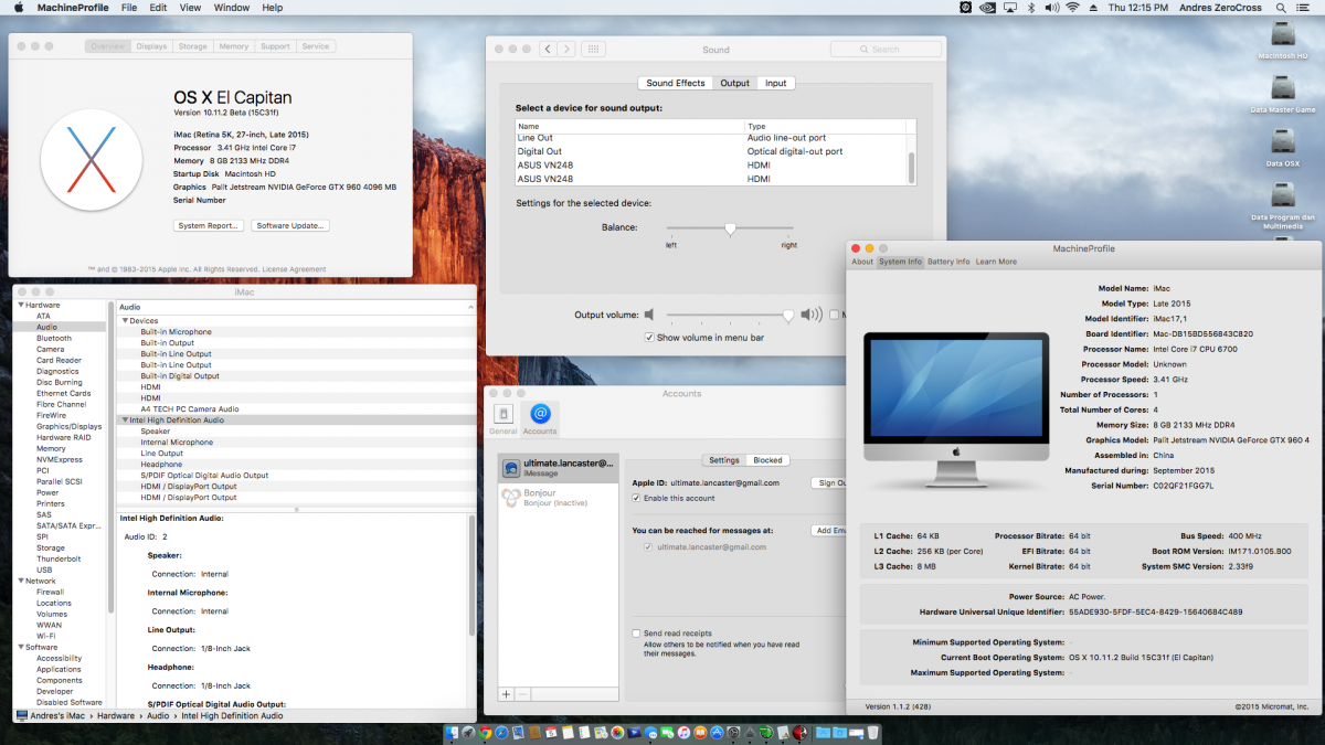

Success - El Capitan Build 15B30a on SkyLake i7 6700 with some Bugs

Have you tried to
1. use non-UEFI Clover booting with BiosBlocksIO boot to fix issues with onboard SATA
2. use NullCPUPowerManagement.kext
3. make USB 3.0 alive with GenericUSBxHCI.kext
4. set old FakeCPUID with old MacPro model, for example 0x010676 (Penryn) + MacPro3,1
for now it's working with Asus Maximus VIII Gene with proper bios version. Pike is working on solution for everybody.
Amazing news! Perhaps this is the board i will buy now then... Nvidia working on it too?
The main problem is located and appears to be related to the IO/APIC Redirection Table Entries (RTE21 - RTE 119) which can be found in the Intel® 100 Series Chipset Family Platform Controller Hub (PCH) datasheet (see page 1035 332691.pdf)
