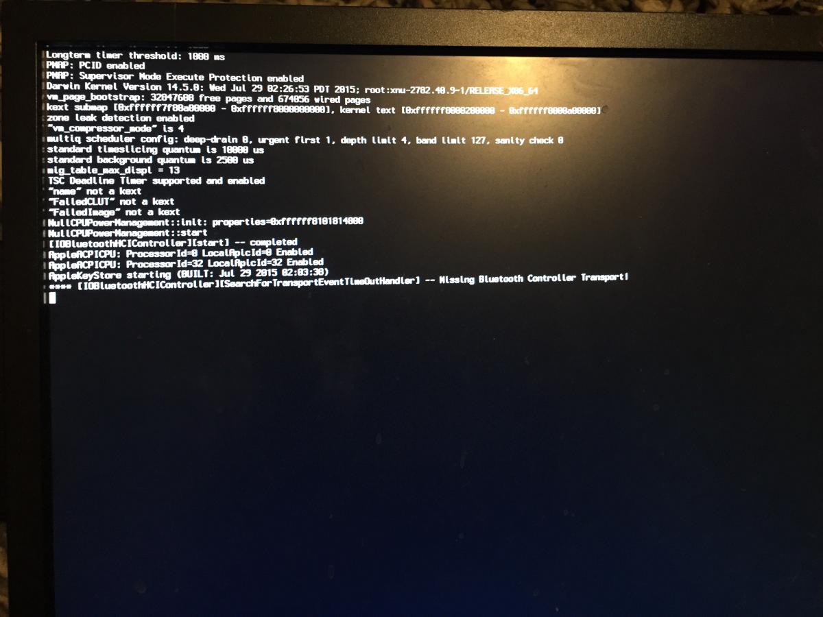

DonDonnelly Posted October 1, 2015 Author Share Posted October 1, 2015 Unfortunately I still get the same KP. I managed to get to the attached screen by limiting the CPU count in the BIOS to 1 (2 total). Not a kernel panic but it does hang here. Link to comment Share on other sites More sharing options...

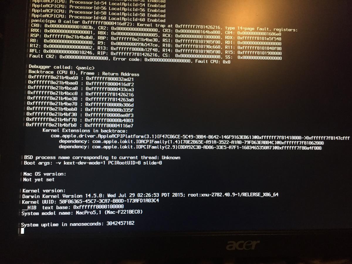

DonDonnelly Posted October 27, 2015 Author Share Posted October 27, 2015 UPDATE: After a few more days of trial and error, I've managed to extract my ACPI tables via Ubuntu. I've removed all errors and warnings, however I don't know which patches to apply as I can't find anything related to this configuration. Attached are my cleaned .dsl, PCI Reg, and a screenshot of where the system hangs/reboots. Archive.zip Link to comment Share on other sites More sharing options...
