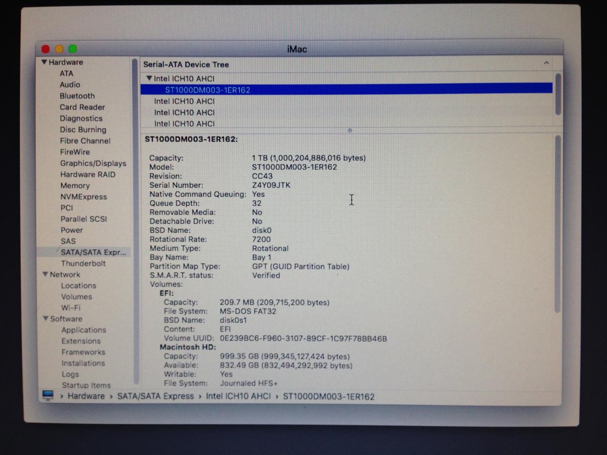

Thanks, i did all that was suggested :) :
- used Chris's Installer
- used your DSDT and config.plist (with CsrActiveConfig 0x3)
- Clover v3270 instead v3259
- and i injected nVidia for QE/CI
Everything booted and worked fine (except for 2 USBs, of course, and i didn't test seep/wake and stby).
But as soon as i tried to delete CPU info (and later change SMbios) from config.plist i got panics, waiting for root, or reboot loop.
Given that with your DSDT i don't have to use any other fixes for SATA operation, i can put it, finally, to AHCI and it mounts HDD right away,
is anyone willing to patch/compile my DSDT for that AHCI fix? I think that it is simple ICH9 to ICH10 thing...? :blush:
I have extracted DSDT and all six SSDT's (with Linux Live CD), but as soon as i start fixing errors and compiling i get kernel panics. From ML, through Mav and Yose to El Capt.
So obviously i still don't know how to do that. Anyone interested in helping with that?
