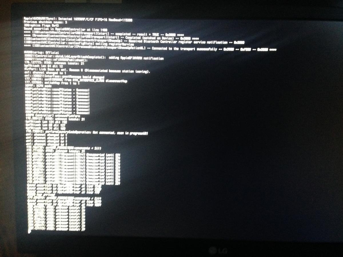

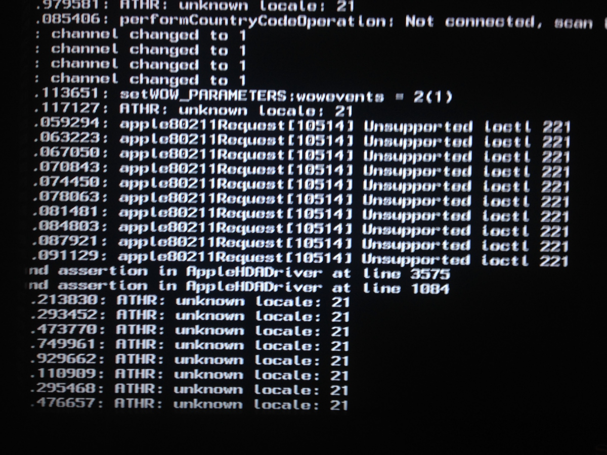

blackswan22 Posted August 12, 2015 Author Share Posted August 12, 2015 Ok I was able to get into verbose mode. Not sure what the very last error that came up was, it flashes away pretty fast, but the last one I recall seeing a couple of times was an HDAdriver? Here is a screenshot but it will but slightly cut off cuz I am booting on an hdtv so the sides are cut off a bit. Have any idea what this means? Link to comment Share on other sites More sharing options...
mendietinha Posted August 12, 2015 Share Posted August 12, 2015 i cant tell if its a video problem... a fakesmc problem... not the best pic, mate. 1 Link to comment Share on other sites More sharing options...

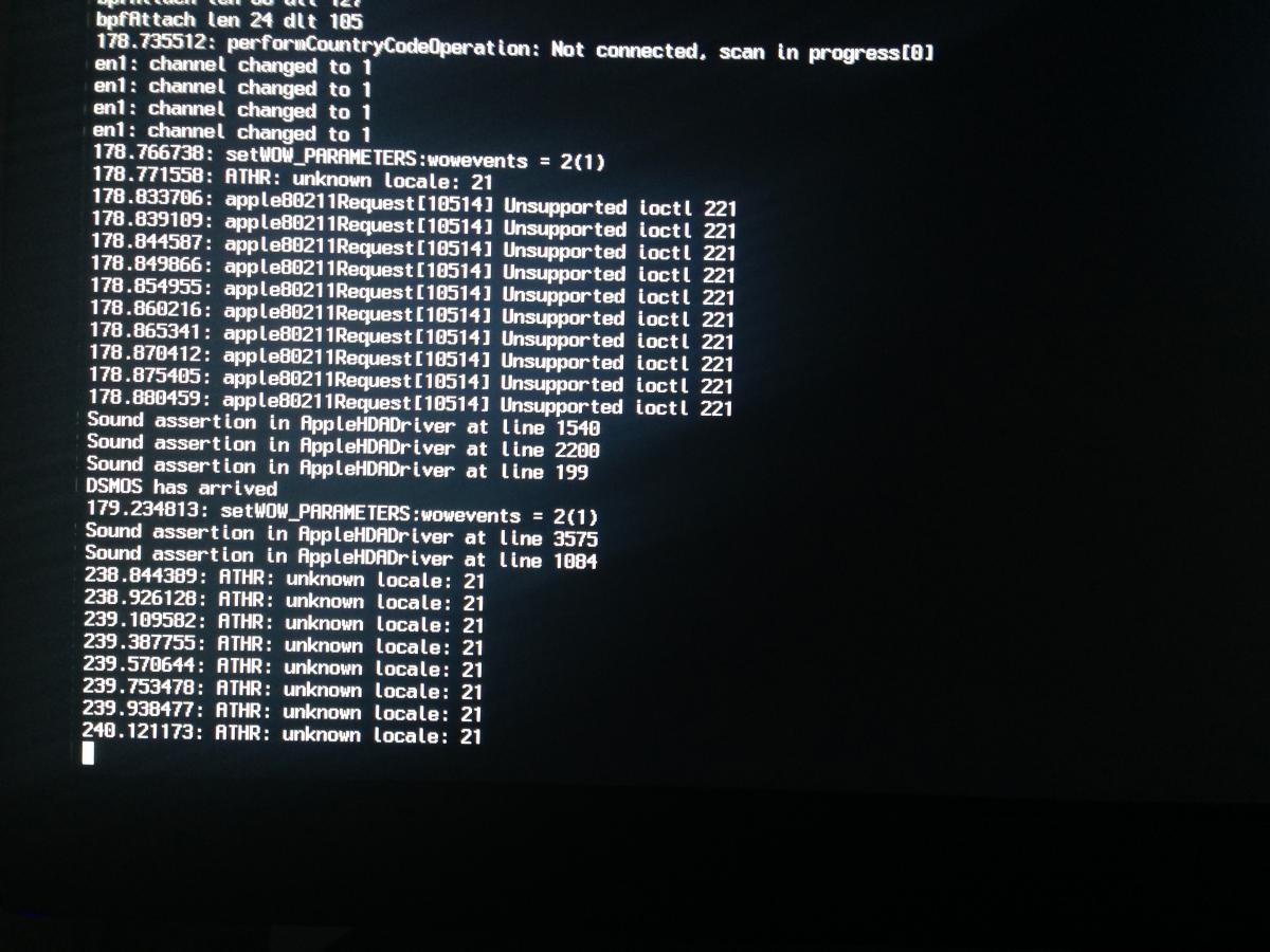

blackswan22 Posted August 16, 2015 Author Share Posted August 16, 2015 Ok here are some new pics from a computer screen of where I get stuck on my build when it is in verbose mode. It does not go any further than this point and then the clover install usb just shuts down and reboots. Any ideas on what this is? Link to comment Share on other sites More sharing options...
mendietinha Posted August 16, 2015 Share Posted August 16, 2015 looks like a video problem 1 Link to comment Share on other sites More sharing options...
blackswan22 Posted August 16, 2015 Author Share Posted August 16, 2015 ok, thanks. so what would i try to correct that? Link to comment Share on other sites More sharing options...
TheRacerMaster Posted August 16, 2015 Share Posted August 16, 2015 Are you using nv_disable=1? 1 Link to comment Share on other sites More sharing options...
blackswan22 Posted August 16, 2015 Author Share Posted August 16, 2015 Probably not because I don't know what I'm doing. Is that what I use? Do I use that by typing that into the bootloader arg section and then try to start the computer up again? Link to comment Share on other sites More sharing options...
TheRacerMaster Posted August 16, 2015 Share Posted August 16, 2015 Yes, you need to type that in the boot args section, since the GTX 960 doesn't have native OS X support (the default OS X drivers won't work with your card, which is why you need to download the Web Drivers after you install OS X). 1 Link to comment Share on other sites More sharing options...
blackswan22 Posted August 16, 2015 Author Share Posted August 16, 2015 Wow, thanks! I'm in. It's at least installing OS X to my SSD now. I will let you know if I need any more help, I'm sure there's some other stuff I'll still have to troubleshoot but this looks promising! Link to comment Share on other sites More sharing options...

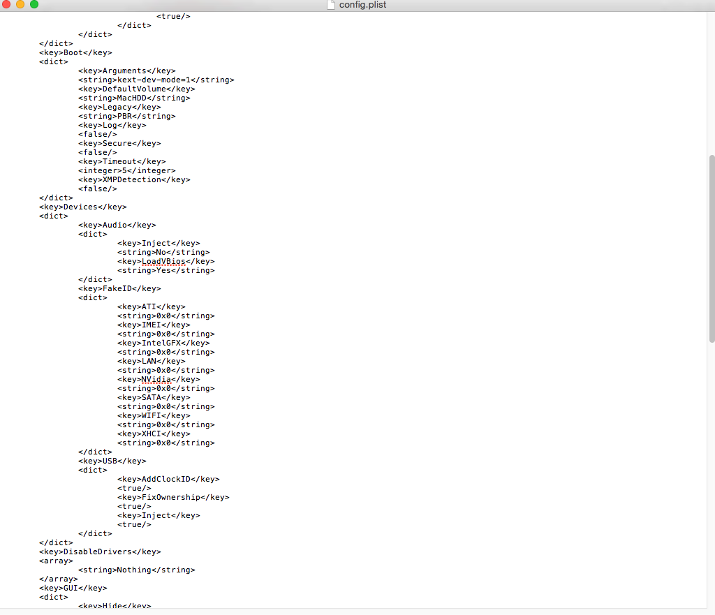

mac09hack Posted August 23, 2015 Share Posted August 23, 2015 Yes, you must boot into the loaded volume with the Clover selection using the USB. There you need to open the EFI partition of the SSD and load the same Clover boot loader there as you did onto the USB. That will make it bootable. You will need to boot up to the Clover boot loader screen and then select the boot volume to startup the disk once it has been installed to the EFI partition. This is how I normally get into either Mavericks or Yosemite. There is a way out there to force Clover to boot one volume after you start up the computer but it requires much Terminal knowledge. I would reserve that until you get other things resolved first. 1 Link to comment Share on other sites More sharing options...
TheRacerMaster Posted August 23, 2015 Share Posted August 23, 2015 Change DefaultVolume from MacHDD to whatever your OS X volume's name is. Also make sure that you add the Fast key (like this) to the Boot section. Here's an example of what this might look like: <key>Boot</key> <dict> <key>DefaultVolume</key> <string>Macintosh HD</string> <key>Fast</key> <true/> </dict> 1 Link to comment Share on other sites More sharing options...
blackswan22 Posted August 23, 2015 Author Share Posted August 23, 2015 Ok sounds good MacO9hack! Thanks for the guide, I've referenced it many times in this process. That was how I did want it to work, but you're probably right that I should double check that everything else works before doing that. I just wanted to make sure that I installed it correctly and not slightly off. Yosemite is now loading from the SSD and not the USB- it just goes to the clover screen first and then I select enter mac os x on ssd from there. so it seems like everything is working correctly now except for the Thunderbolt ports which for now is totally ok with me. Thanks Racermaster! My drive that is the mac startup disk is named SSD, so I will replace the Macintosh HD with that line and give it a try!!! Link to comment Share on other sites More sharing options...
blackswan22 Posted August 23, 2015 Author Share Posted August 23, 2015 Awesome tip, I inserted that into the config playlist and it worked on the very next startup! My new mac is now up and running like a monster!!! (I mean that in a good way, as in unbelievably fast haha!) Thanks to everyone who helped me on this build! I will post some pics once I get everything properly setup onto my desk. Link to comment Share on other sites More sharing options...
