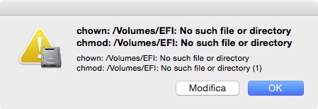

c.ozzy Posted July 23, 2015 Author Share Posted July 23, 2015 adesso non mi monta la partizione EFI della penna usb che ho creato per installare yosemite... Ciro82 adesso lo provo :-) @ciro82: mi restituisce questo errore: a cosa può essere dovuto? efi mounter non mi monta alcun file efi, mentre clover configurator mi monta due partizioni efi ma non quella della chiave usb per avviare l'installazione di oso Link to comment Share on other sites More sharing options...

WaldMeister Posted July 23, 2015 Share Posted July 23, 2015 Hi, Unplug USB devices. Open terminal and type: diskutil list Can you provide us the output here? 1 Link to comment Share on other sites More sharing options...

c.ozzy Posted July 23, 2015 Author Share Posted July 23, 2015 iMac-di-Steto:~ steto$ diskutil list /dev/disk0 #: TYPE NAME SIZE IDENTIFIER 0: GUID_partition_scheme *500.1 GB disk0 1: EFI EFI 209.7 MB disk0s1 2: Microsoft Basic Data Backup 1TB 499.9 GB disk0s2 /dev/disk1 #: TYPE NAME SIZE IDENTIFIER 0: GUID_partition_scheme *1.0 TB disk1 1: Microsoft Basic Data 1.0 TB disk1s1 /dev/disk2 #: TYPE NAME SIZE IDENTIFIER 0: GUID_partition_scheme *320.1 GB disk2 1: EFI EFI 209.7 MB disk2s1 2: Apple_HFS YOSEMITE 219.2 GB disk2s2 3: Apple_Boot Recovery HD 650.0 MB disk2s3 4: Apple_HFS Recover Yosemite 99.3 GB disk2s4 iMac-di-Steto:~ steto$ To format the EFI partition proceed as follows: Run the following commands in the terminal, replacing X by the number of HD. diskutil list sudo newfs_msdos -v EFI -F 32 /dev/diskXs1 i did the format and this is what terminal replied me: is it ok? iMac-di-Steto:~ steto$ sudo newfs_msdos -v EFI -F 32 /dev/disk2s1 Password: newfs_msdos: warning: /dev/disk2s1 is not a character device 512 bytes per physical sector /dev/disk2s1: 403266 sectors in 403266 FAT32 clusters (512 bytes/cluster) bps=512 spc=1 res=32 nft=2 mid=0xf8 spt=32 hds=32 hid=40 drv=0x80 bsec=409600 bspf=3151 rdcl=2 infs=1 bkbs=6 iMac-di-Steto:~ steto$ Link to comment Share on other sites More sharing options...
WaldMeister Posted July 23, 2015 Share Posted July 23, 2015 Like stated above, in Terminal: mkdir /Volumes/EFI sudo mount -t msdos /dev/disk2s1 /Volumes/EFI Does it mount or give an error? If it mounts, still no idea why Clover Configurator does not mount it... Link to comment Share on other sites More sharing options...
c.ozzy Posted July 23, 2015 Author Share Posted July 23, 2015 Like stated above, in Terminal: mkdir /Volumes/EFI sudo mount -t msdos /dev/disk2s1 /Volumes/EFI Does it mount or give an error? If it mounts, still no idea why Clover Configurator does not mount it... it mounts it, but Clover Configurato doesn't... Link to comment Share on other sites More sharing options...
