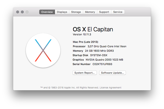

Wow amazing job Rockey :)  Can you please post the final kext and DSDT you are using so that audio works.  I have not yet had time to try resolving my ATI card not booting but I am sure it is something small.  Can you take pictures of the bios settings from z800 please because I am having issues there also I think.  I have disabled what you suggested but to no avail.  Do you boot with AHCI or IDE settings?
Thanks for your contribution and to Chris!
