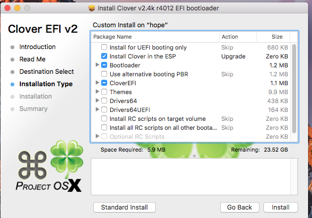

Hi friends, i need to update Clover,  That is, to install on the EFI partition(ESP) and not on the main partition. What is the process...When clover displays the "Where to install" options, the EFI partition does not appear.

What do you mean by the main partition, is that where you have OS X installed?  Install Clover to the partition where you have OS X. In Clover only choose whatever the name of that partition is. Install using defaults only. It will install to the EFI.       See screenshot.
Yes... updated... Thanks Jaymack...
This is correct...Clover mount the EFI partition auto, create backup in the macOS partition and update EFI..

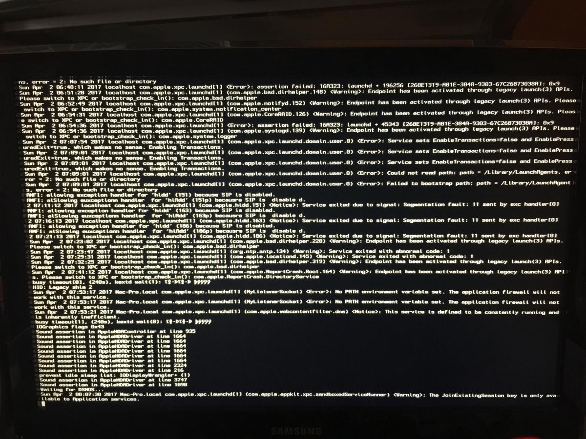

Good Evening Rockey, and everyone. I hope I can get some help with what is turning out to be a very arduous weeklong endeavor of trying to get Sierra to even install on my Z800. I have so far managed to get the BIOS settings to be exactly as Rockey has them, and have the USB bootable with clover and necessary kexts. The problem is that I end up getting a "(com.apple.appkit.xpc.sandboxServiceRunner) <Warning>: the JoinExistingSession key is only available to application services" error.
I have gotten my clover, kexts, DSDT, as well as the config.plist from a guide that is on here for the z800. I was wondering if there was something on there that is stopping it from going any further. I am adding them below for anyone to check and get back to me. I have spent many many hours trying to get this to install, but no luck. Any help will be appreciated

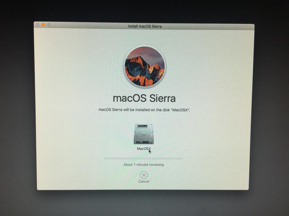

Good news so far. I have gotten much further than I have ever gotten before. I first decided to fully re-do the installation USB, and then add all of the files that you have posted for me to use. I am hoping no other problems pop up after install. I do assume that I will have to install some kexts and drivers correct?
Update: Sierra seems to have installed fine, but when I try to start it up through the clover screen it stops at "DSMOS has arrived" then says "prevent idle sleep list: IODisplayWrangler+ (1)".
Is this a graphics card issue at this point?
Update #2: looked online for fix. For anyone else who has this problem, I went back to my USB stick, and moved all of the kexts that were in the 10.12 folder, and moved them to a newly created "Other" folder. I deleted the 10.12 folder afterwards. It got me past the error.

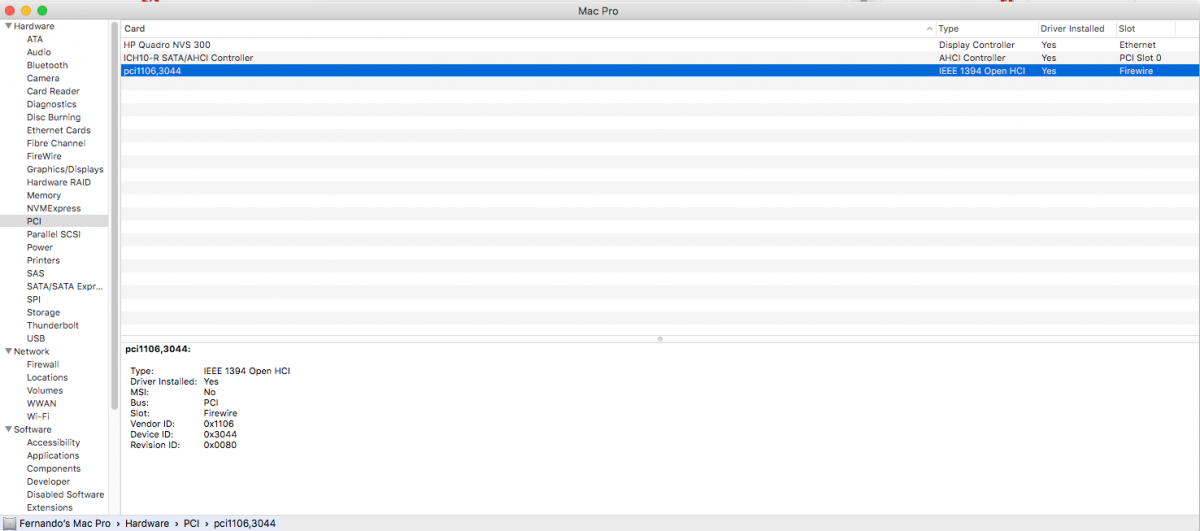

Firewire
I've tested your patch, but I had the same result. Although I've bought a PCI firewire, it didn't recognise my sound card by PCI firewire or built-in firewire...
Now I can see the new PCI in hardware list:
That's the files that I have now working.
I don't know what more I can change to fix firewire connection.
