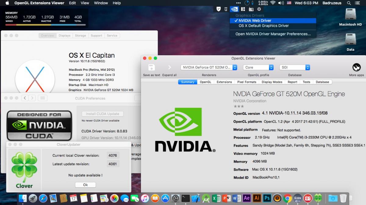

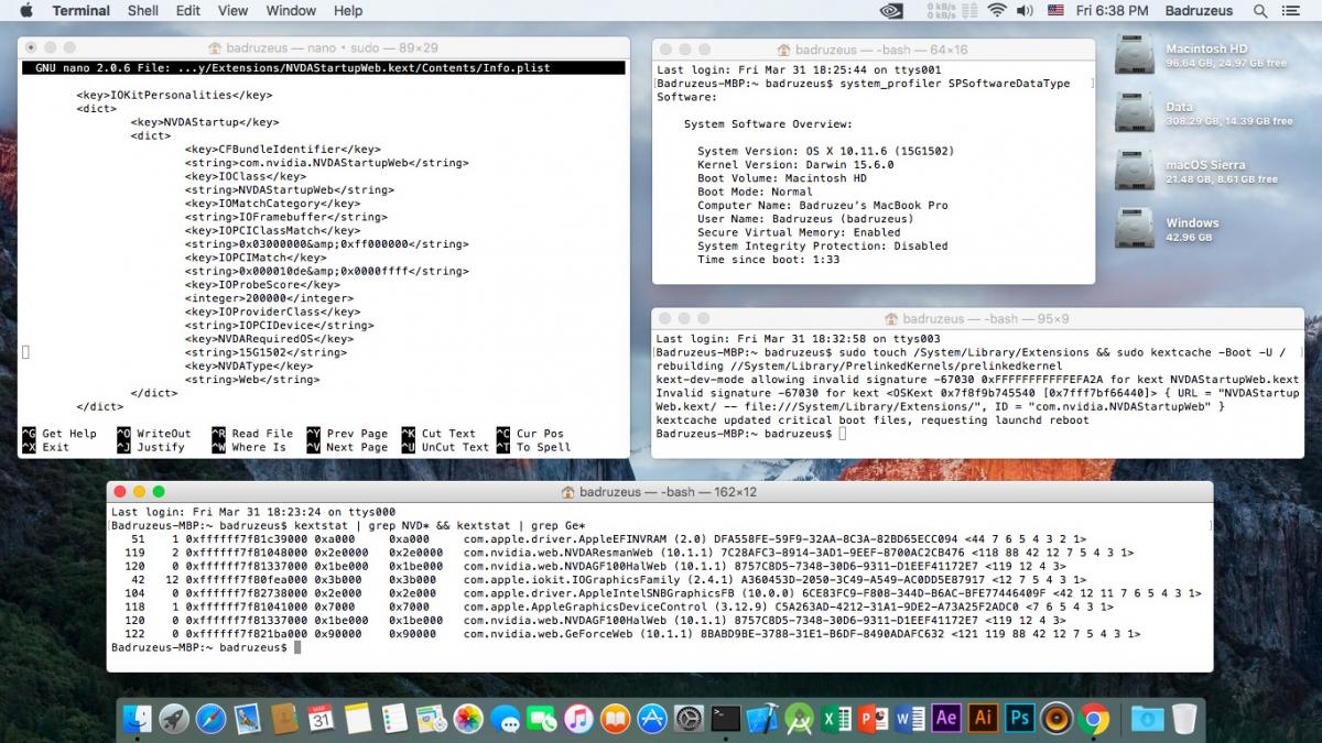

Web Driver - 346.03.10f01 works fine on 10.11.6 after editing NVDAStartupWeb.kext to 15G :
I left the hackintosh scene for a while, can you explain me how you bypassed version check in the .pkg installer please?
