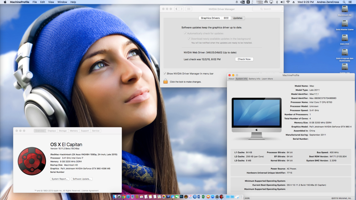

Installed Beta 5 on 4,1 PowerMac w GTX680, only way out of boot looping was to plug in Apple keyboard and zap PRAM. Booting into Recovery and running Disk Utility multiple times (no errors found, wow) still would lead to boot loops upon restarting. After zapping PRAM I was prompted to choose a language then it booted regularly and is running fine with beta NVIDIA drivers.

After installing the newest beta, the web driver just decided to work. Not sure what happened there.
Oddly, the update tool (before installing the web driver pkg) informed me there were no updates for my system. -shrug-
