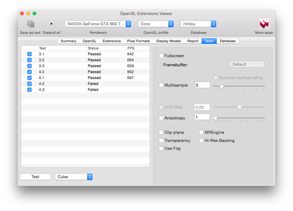

Has anyone noticed stuttering with 346.03.03f02? I have a GTX 970. It is very noticeable using the OpenGL Extension Viewer test. The rotating cube stutters quite a bit. I also notice a lot of stuttering in Diablo III just running around.

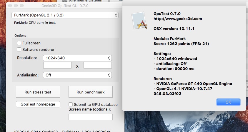

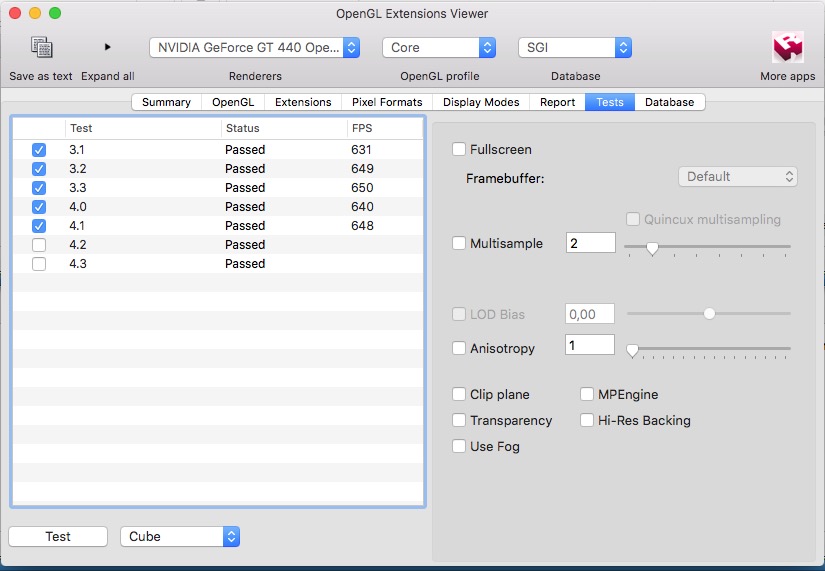

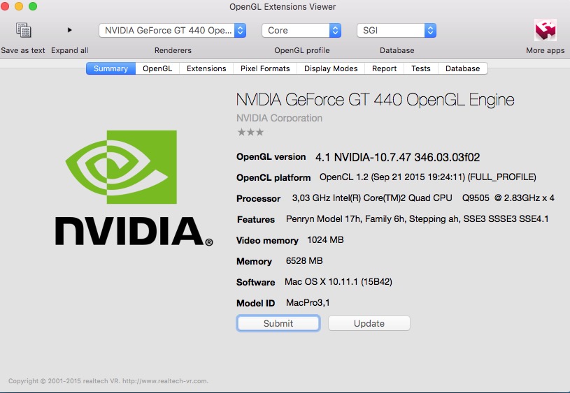

Here no such stuttering with GT 440, MacPro3,1 ! I think thats mostly if the GPU didnt run in full speed and stays at idle GHz which is only 1/4-1/3 of the max. speed. AGPM Probs (by wrong MacModell id)?
Wait: GT440 getting about the same FPS as my GTX 970??? WOW

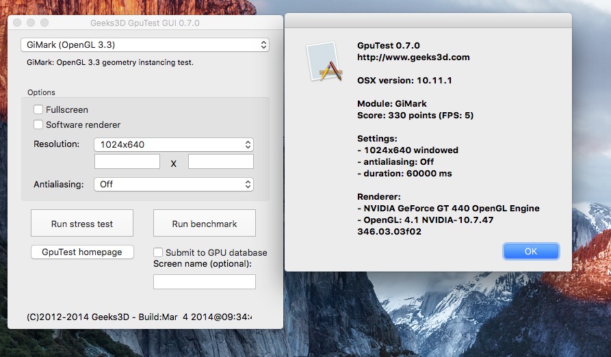

THAT "Test" isnt good to bench GPUs. Much less to complex = less differences between gpus. Mostly CPU bound, not GPU bound.

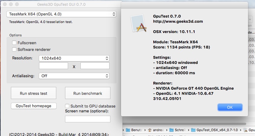

I would use GPUTEST 0.7 for example which put much load on the gpu.
http://www.geeks3d.com/gputest/download/ ( LInk to Homepage Main Page http://www.geeks3d.com/gputest/ )
Furmark  and GiMark GT 440  - i am sure the GTX card will be up to 8 times faster!
Good point! Can you do GPUTEST on the TessMark X64? :) Thanks
