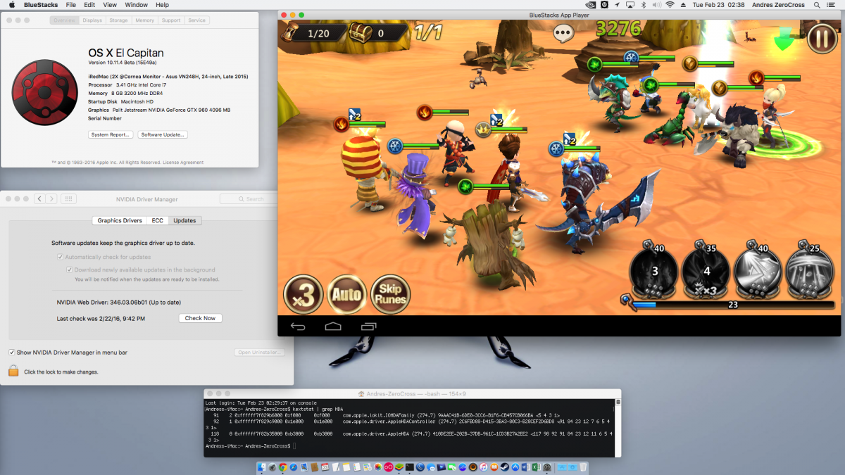

For me, FCPX works very well
I have also done the test BryceX, 17.3 seconds
Everything is fine, I'm fine

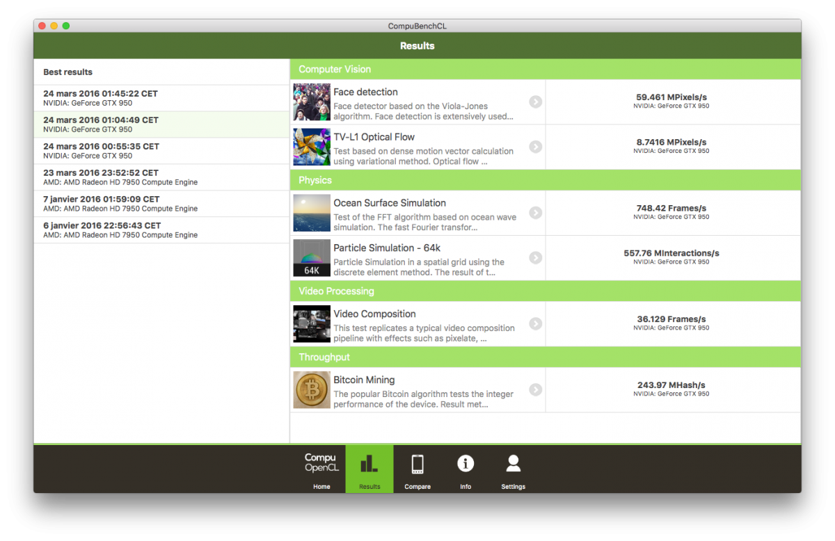

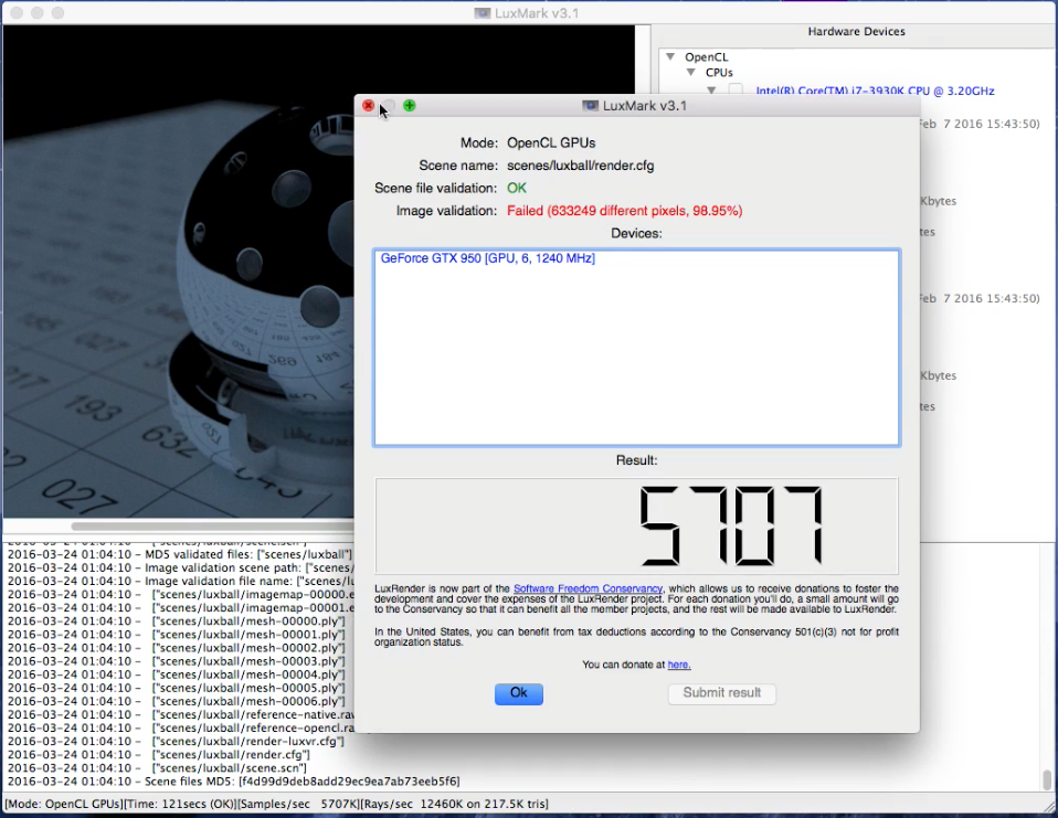

GTX 950 works 10.11.4 but bad result opencl/gl , no works with smbios Macpro 6,1 , works with iMac 14,2  :mad: , very bad GC nV  :sick:
very good HD 7950 !  :thumbsup_anim:
Do you have specific numbers for your "bad result opencl/gl"?  I'm pretty sure it's expected that the MacPro6,1 won't work correctly unless you have hardware that matches that config (i.e. Xeons with an X79 chipset).  I'm using a TITAN X as an iMac14,2 because I have the same CPU/chipset as those real Macs.
GTX 950 opengl = 62 fps
https://youtu.be/V-0Eep2ykDA
