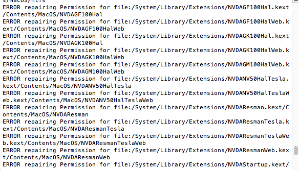

Yep, can reach desktop. I think it's using the default 10.11.2 kext's.  I get a bunch of repair errors:
You guys are amazing. Disabling SIP, repairing, leaving SIP disabled and installing drivers worked. Now I can use CUDA in After Effects and Premiere :D

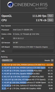

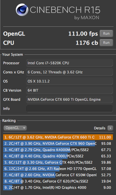

BTW these drivers are awesome and glad nVidia still updates. I get almost twice the performance in CUDA on this measly 750m on certain applications. AMD never has any custom drivers and even on Windows their drivers are subpar at best.
