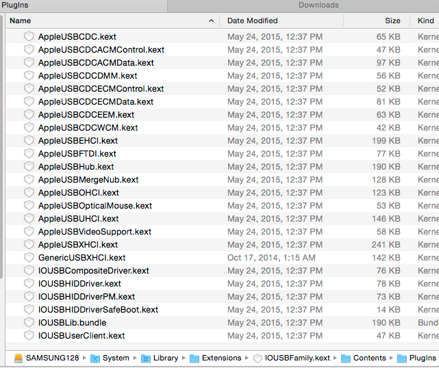

I have tried to copy the AppleUSBXHCI.kext into S/L/E IOUSBFamily's plugin folder, then rebuild cache. This gave no result and I tried to use Clover's patching tool.

So, to make sure I understand correctly (your link is referring to my post) - I downloaded RehabMan's Generic USB3 plugin from here.
Then I copied GenericUSBXHCI.kext into /System/Library/Extensions/IOUSBFamily.kext/Contents/PlugIns. Rebuilt cache, fixed permissions, reboot withUSB3 - freezed at same place.

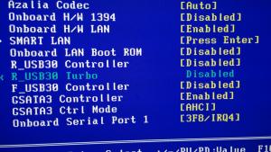

Turned off USB3 from BIOS, booted, opened IOReg, exported data and attached here.
By the way I removed XhciDxe-64.efi.
Do I get it right, that if I disable USB3 from BIOS, we will never see XHCI doing its job? If true, then even AppleUSBXHCI.kext didn't have chance to work.

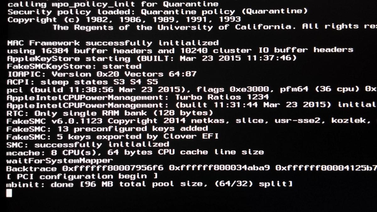

Installed in /S/L/E. Rebooting with USB3 on - same result, hanging on boot.

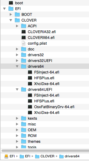

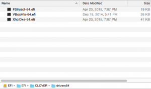

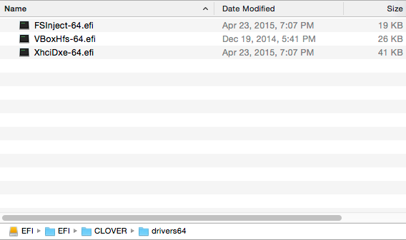

While trying to understand why XhciDxe-64.efi doesn't load, I figured out only drivers from drivers64UEFI are loaded. So I just copied driver from drivers64 to drivers64UEFI.
Now they look like this and according to bootlog it's loading:
Could you please tell me at which point it is decided whether to use drivers64UEFI or drivers64 folder?

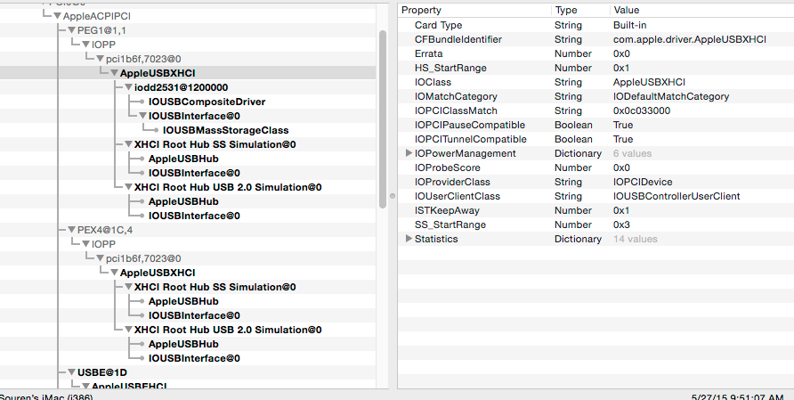

Just in case, attaching IOReg, after at least GenericUSB loads.
----------------- update
The result of using AppleUSBXHCI /patching through Clover/ are following.
devices are recognized on USB3 ports and seems working properly.
However, in IOReg I still see GenericUSBXHCI, not sure if this is the way it has to be... Looks like I wasn't able to completely remove it? Deleted from /S/L/E, rebuilt cache, fixed permissions (using Kext Wizard).

Looks like IOReg was not showing me up to date data after reboot. Restarted and now it shows AppleUSBXHCI.
So on GA-Z68X-UD3H-B3 F12, USB3 works perfectly fine! What I have done with help of Allan:
1. Installed XhciDxe-64.efi into drivers64UEFI (still wondering when each of those folders are engaged. I am using non UEFI BIOS).
2. Used Clover to patch original AppleUSBXHCI
Thanks Allan.
