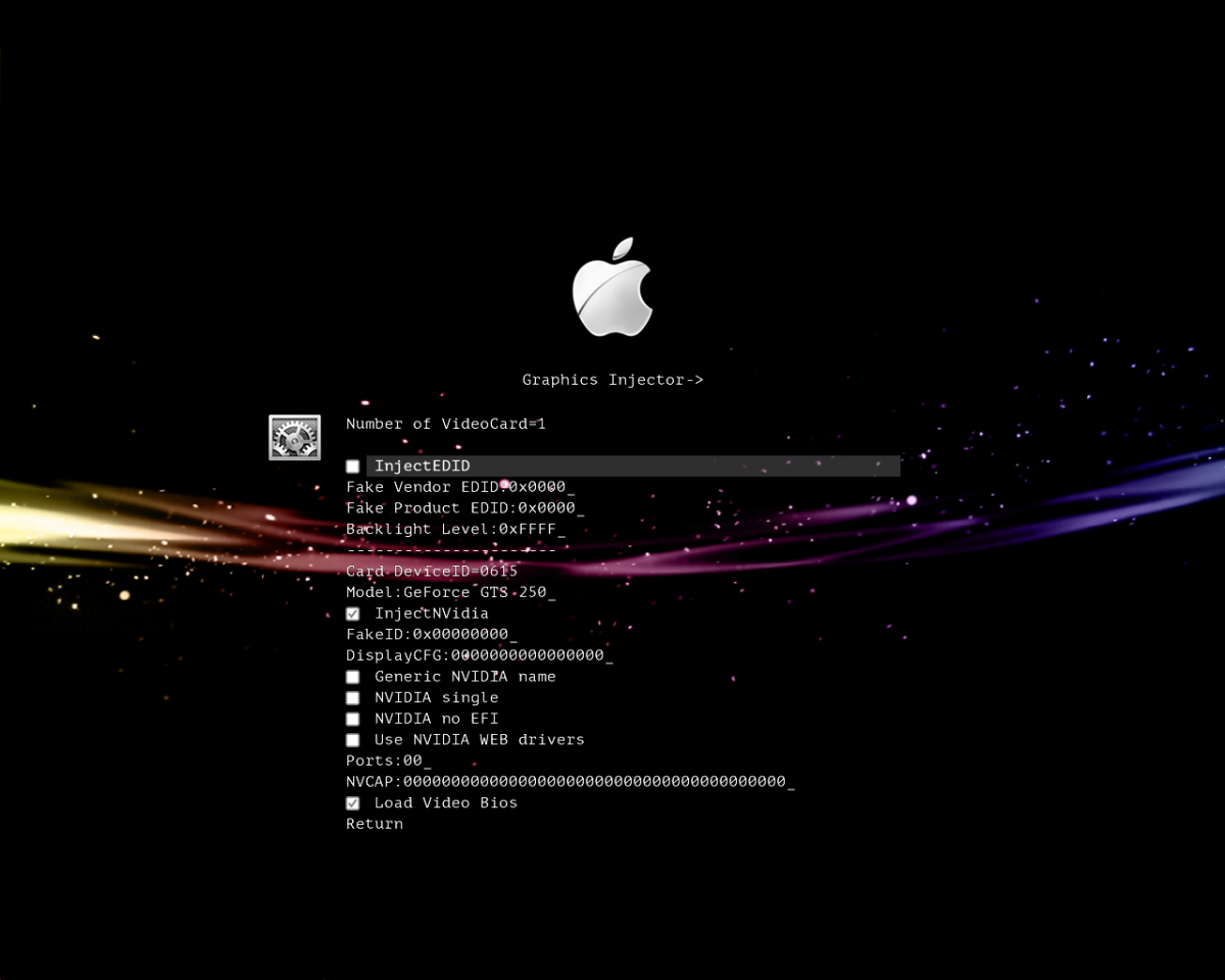

nvidiaNoEFI and nvidiaSingle
within the Clover GUI

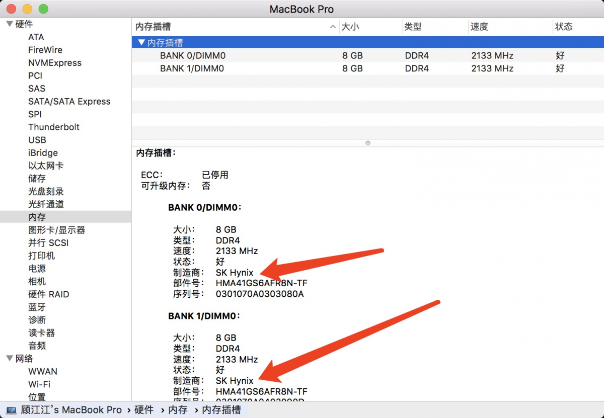

As reported by @gujiangjiang in the the General discussion thread, Clover doesn't detect the SPD vendor for SK Hynix DDR4 DIMMs. Adding the proper bank/code IDs to memvendors.h should fix that:
Platform/memvendors: Add SK Hynix DDR4 vendor bank/code IDs
However, it appears that there are only a few bank/code IDs for DDR4 DIMMs in memvendors.h, so it might make sense to use the SMBIOS vendor if the SPD vendor isn't detected ("NoName" returned by getVendorName in spd.c). The following patch should do this (but only if the SMBIOS is trusted):
Platform/smbios: Use SMBIOS RAM vendor if SPD RAM vendor is unknown
  • Like 4
Very thanks for this fix and i test it works well.
However the SerialNumber are still wrong.Can we fix the SerialNumber?

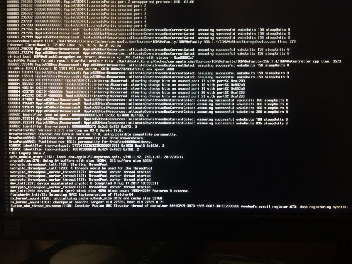

I have problem with every clover version above 4128. If I update clover, patch for fo IONVMeFamily won't work.
<dict>
				<key>Comment</key>
				<string>IONVMeFamily Preferred Block Size 0x10 -> 0x01 (c) Pike R. Alpha</string>
				<key>Disabled</key>
				<false/>
				<key>Find</key>
				<data>
				9sEQD4VBAQAA
				</data>
				<key>Name</key>
				<string>IONVMeFamily</string>
				<key>Replace</key>
				<data>
				9sEBD4UcAQAA
				</data>
			</dict>
			<dict>
				<key>Comment</key>
				<string>external Icon</string>
				<key>Disabled</key>
				<false/>
				<key>Find</key>
				<data>
				SIXAdAc=
				</data>
				<key>Name</key>
				<key>Replace</key>
				<data>
				SIXAZpA=
				</data>
			</dict>
			<dict>
System wont boot and froze on this message: post-916820-0-64810100-1503389645_thumb.jpg
Last working version is Clover 4128. Im using HighSierra DP7
Yeah, the vendor bank needed updated for a while. Weird thing is that it used to use SMBIOS over SPD if SMBIOS/Trust=true (which it is by default unless your SMBIOS is detected to be totally screwed). So unsure what happened....
I test the smbios.h patch and find vendor correct but there is no "RAM" section in "About This Mac".
Does SMBIOS and SPD have 2 different infomation about ram?

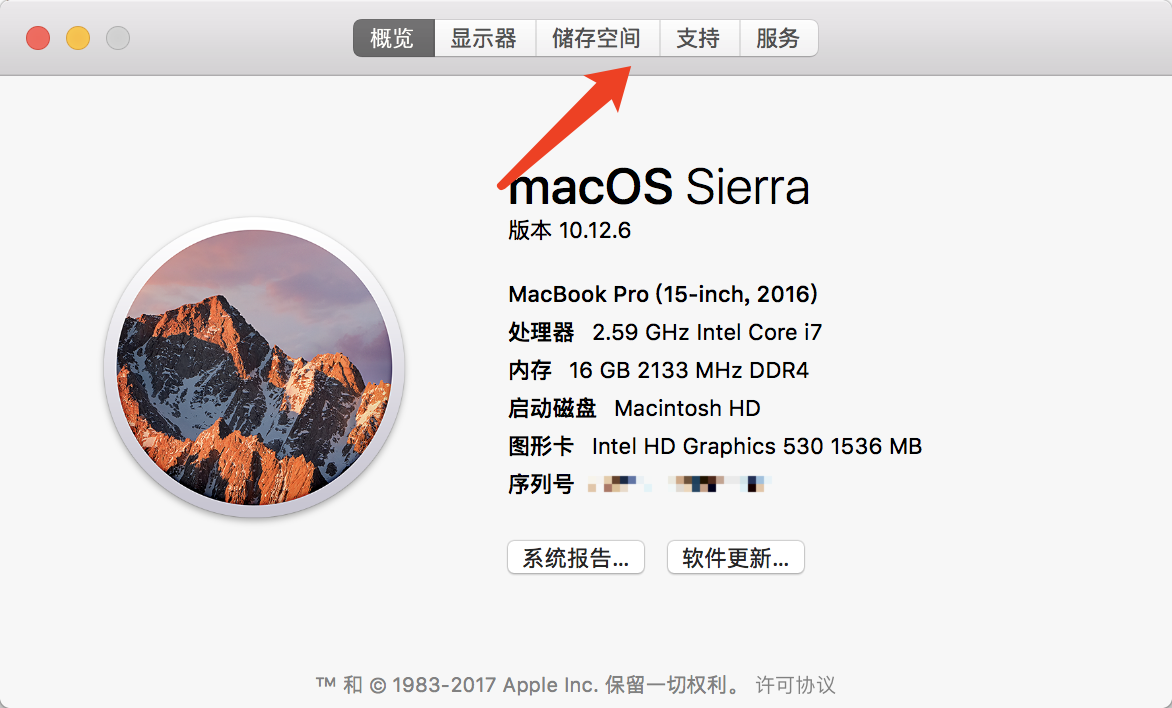

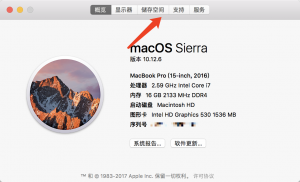

@TheRacerMaster @Sherlocks
I found the RAM disappeared is not related with the patch because i update Official Clover R4184 and ram vendor show unknow but still have no RAM in About This Mac.
So i think it maybe the platformdata or smbios error or FirmwareFeatures data error cause the RAM disappear.
Update:
Sorry for mistake.
Thanks to @syscl found the real MacBookPro2017 dont have RAM in About This Mac yet so the "NO RAM" is correct for MBP13x and MBP14x.
Thank you for the patches, committed to r4186.
@gujiangjiang @TheRacerMaster Actually no memory tab in "About This Mac" is not a bug on newer platforms, I checked Memory tab disappear on my MacBookPro(2017, Kabylake) and Dell Precision M3800(Haswell), they both miss the tab Memory on "About This Mac"
