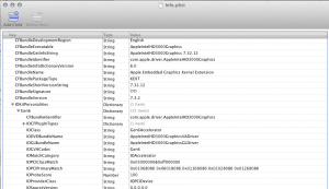

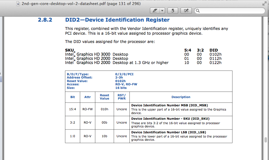

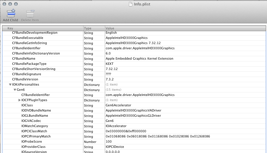

Clover has model string incorrect for 8086:0112.
8086:0112 is HD3000, not HD2000.
In gma.c, this:
  { 0x0112, "Intel HD Graphics 2000"  },
should be:
  { 0x0112, "Intel HD Graphics 3000"  },
It is cosmetic only and can be fixed by Devices/AddProperties (and Devices/NoDefaultProperites) or DSDT patch.

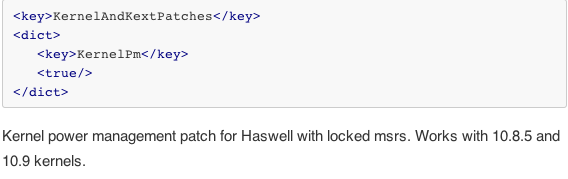

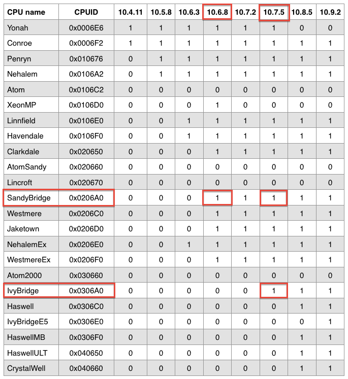

Hello.. Im fun of testing older builds of OSX in Clover (always latest). Here is what i found during my test using FakeCPUID feature.
CPU: i5-4460 Haswell
OS: SL & Lion
SL = 0x0206A0
32Bit = Instant reboot!
64Bit = Working
LION = 0x0306A0
32Bit = Working
64Bit = Instant Reboot!
I can send debug report if you can tell which to enable in config.plist
Thanks :)
In gma.c, this:
should be:
OS: SL & Lion
SL = 0x0206A0
64Bit = Working
LION = 0x0306A0
32Bit = Working
Thanks :)
May be the reboot with CPUPM?
Must be inaccurate. I helped someone with i5-2500k. Device-id was 8086:0112.
http://ark.intel.com/products/52210/Intel-Core-i5-2500K-Processor-6M-Cache-up-to-3_70-GHz
No biggie... easy to work around with _DSM inject or config.plist/Devices/NoDefaultProperties, config.plist/Devices/AddProperties.
From Chameleon gma.h:
#define GMA_SANDYBRIDGE_GT1        GFX_MODEL_CONSTRUCT(INTEL, 0x0102) // HD Graphics 2000
#define GMA_SANDYBRIDGE_GT2        GFX_MODEL_CONSTRUCT(INTEL, 0x0112) // HD Graphics 3000
Chameleon knows better then Intel!
Anyway what is the difference if System Profiler shows hd2000 or hd3000? Kexts attached to DeviceID not to Model name.
How to fix it then? I have removed applecpupm but still early reboot.
May be you should show something? debug.log for example?
Even Intel can make mistakes.
Cosmetic only.
OS X has no native support for HD3000 desktop (it was omitted from the Info.plist), because there are no Apple computers with this hardware.
My i7-2600k is 0122:8086. I use FakeID/IntelGFX=0x01268086.
You cannot rely on Apple's Info.plist as a reference for device-ids.
Any chance to make this work on 10.7
XCPM was introduced in 10.8.5.
This is correct, Apple never used desktop CPUs with HD 3000. 2011 iMacs had desktop CPUs with model numbers that end in S - these all have HD 2000. iMacs use the IGPU for AirPlay Mirroring (using QuickSync), which is why the HD 2000 device IDs are in the kext (same thing with HD 2500 IDs in the HD 4000 kexts).
