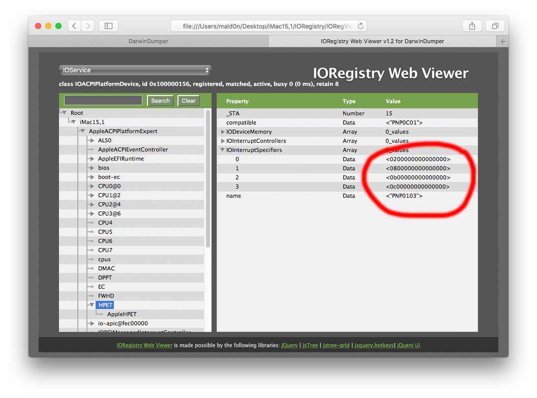

MaLd0n Posted March 25, 2017 Share Posted March 25, 2017 Many HP and DELL have these problems, is a sata conflict. In my case solve with IRQs edit. Remove irqs in devices RTC, PIC, TMR and add in HPET irqs 0,8 Link to comment Share on other sites More sharing options...
Whosondephone Posted March 25, 2017 Share Posted March 25, 2017 The patch does all of that except add HPET irqs 0,8. They must be added. My system won't boot without them. Looks something like this: Device (HPET) { Name (_HID, EisaId ("PNP0103") /* HPET System Timer */) // _HID: Hardware ID Method (_CRS, 0, NotSerialized) // _CRS: Current Resource Settings { Name (HBAB, ResourceTemplate () { IRQNoFlags () {0} IRQNoFlags () {8} I've always wondered how this works. It seems like... Ok we'll just remove things from here and add things to here. Does the boot loader discern between the differences of the patched dsdt and unpatched and adjust for the differences? Perhaps something entirely different is going on. The patch is supposedly for the T7500. Link to comment Share on other sites More sharing options...
MaLd0n Posted March 25, 2017 Share Posted March 25, 2017 the irqs patch is mandatory, all hacks need. Avoid conflicts in sata, usb, firewire, etc, etc i'm using it now, hack iMac15,1 Name (CRS0, ResourceTemplate () { IRQNoFlags () {2} IRQNoFlags () {8} IRQNoFlags () {11} IRQNoFlags () {12} Memory32Fixed (ReadWrite, 0xFED00000, // Address Base 0x00000400, // Address Length ) }) Check hpet in Real Macs(iMac15,1) 2,8,0b,0c 0b=11 0c=12 0,8 work for all, but in some cases u need more Clover use 0,8,11 Notebooks use 0,8,11,15 10 years +, many tests, many people, hard work Link to comment Share on other sites More sharing options...
