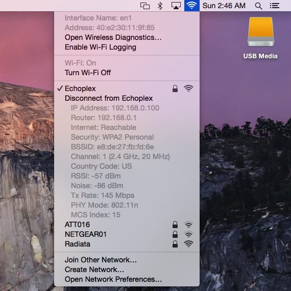

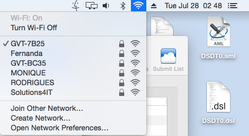

#McFly Posted July 28, 2015 Share Posted July 28, 2015 Hi Guys, I need some help. I have a Broadcom BCM94360CD (AX) Apple with adapter PCI-EX my device id is 43A0 and in the system appear 0x111, have a problem? Bluetooth connects to the notebook Windows but does not send and receive files. And do not appear information of router connection, below have two images, the my with no information and other with information. Why this? need Built-in on DPCIManager? it's not! i'm so sorry for my bad english. Link to comment Share on other sites More sharing options...

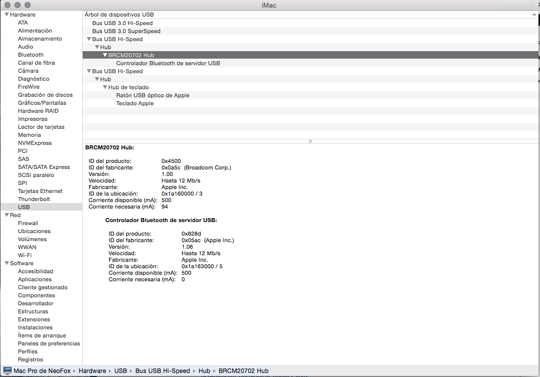

neo_fox33 Posted February 3, 2016 Share Posted February 3, 2016 Hi, i have the same adapter: Works on yosemite but on El capitan works wifi only. Image 1. I probe many solutions and nothing happens, turn off my system and the turn it on again the next day, the firmware upgrade. Image 2. now works on both systems. Sorry for my English I hope it helpful. Link to comment Share on other sites More sharing options...
