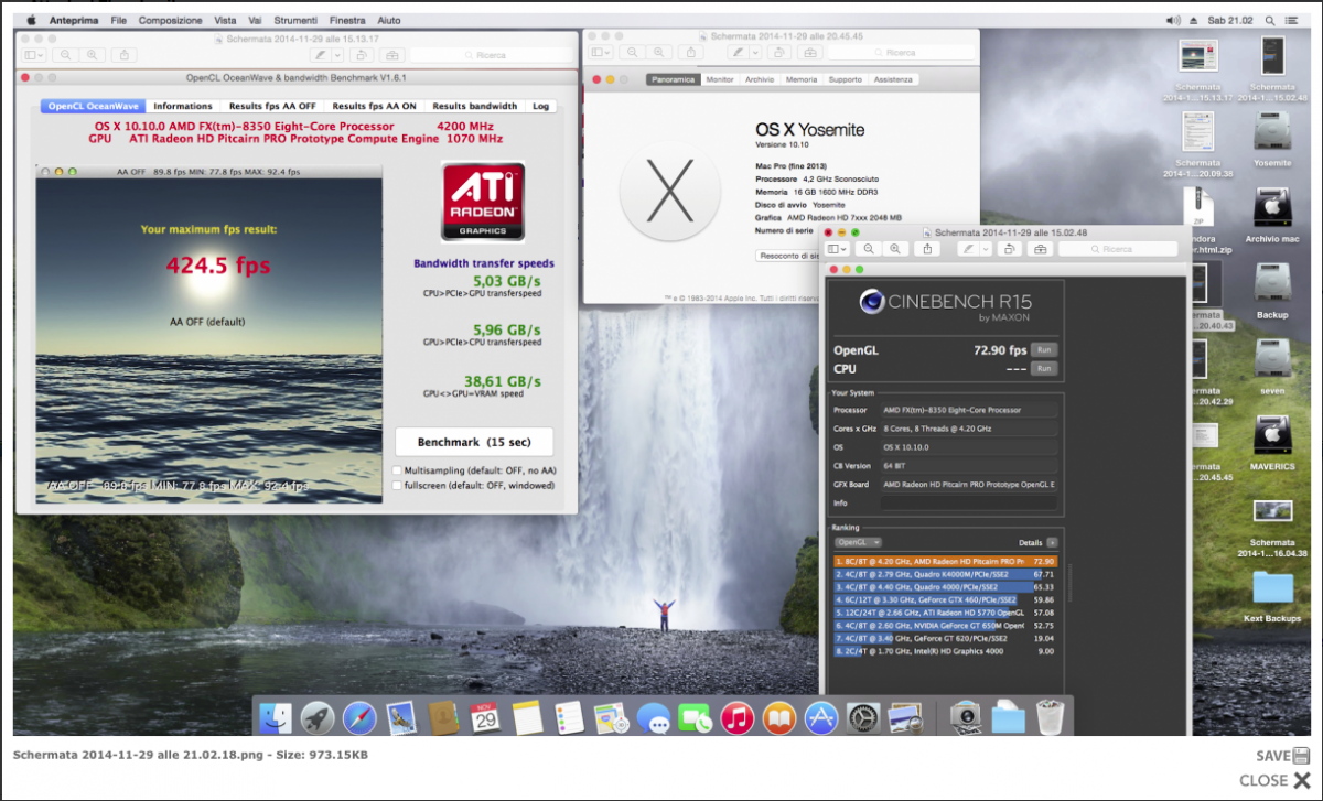

gils83 Posted February 2, 2015 Share Posted February 2, 2015 mine , no flag http://www.insanelymac.com/forum/topic/302506-cinebench-r15-opengl-yosemite-1010/?do=findComment&comment=2084993 http://www.hackintoshosx.com/topic/21968-show-your-cinebench-results/?do=findComment&comment=118675 R9 270x http://www.insanelymac.com/forum/topic/302506-cinebench-r15-opengl-yosemite-1010/?do=findComment&comment=2084264 whooo !!! GTX 580 !! http://www.hackintoshosx.com/topic/21968-show-your-cinebench-results/?do=findComment&comment=118081 1 Link to comment Share on other sites More sharing options...
