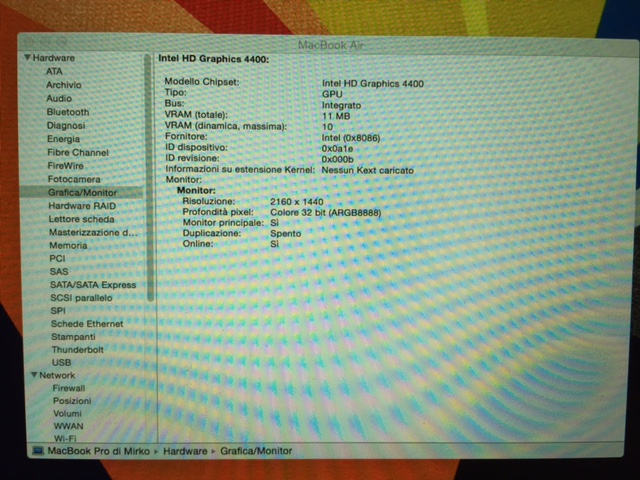

mirko84 Posted January 24, 2015 Author Share Posted January 24, 2015 Ho provato ad installare i kext, ora non va più così a scatti ma non ha comunque l'accelerazione. ti allego lo screen. Link to comment Share on other sites More sharing options...
carbo178 Posted January 24, 2015 Share Posted January 24, 2015 metti come framebuffer 0x08001e0a, altrimenti bisogna provare con un fake-id in Clover Link to comment Share on other sites More sharing options...
