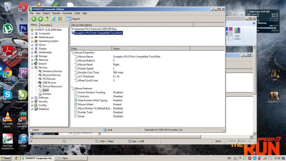

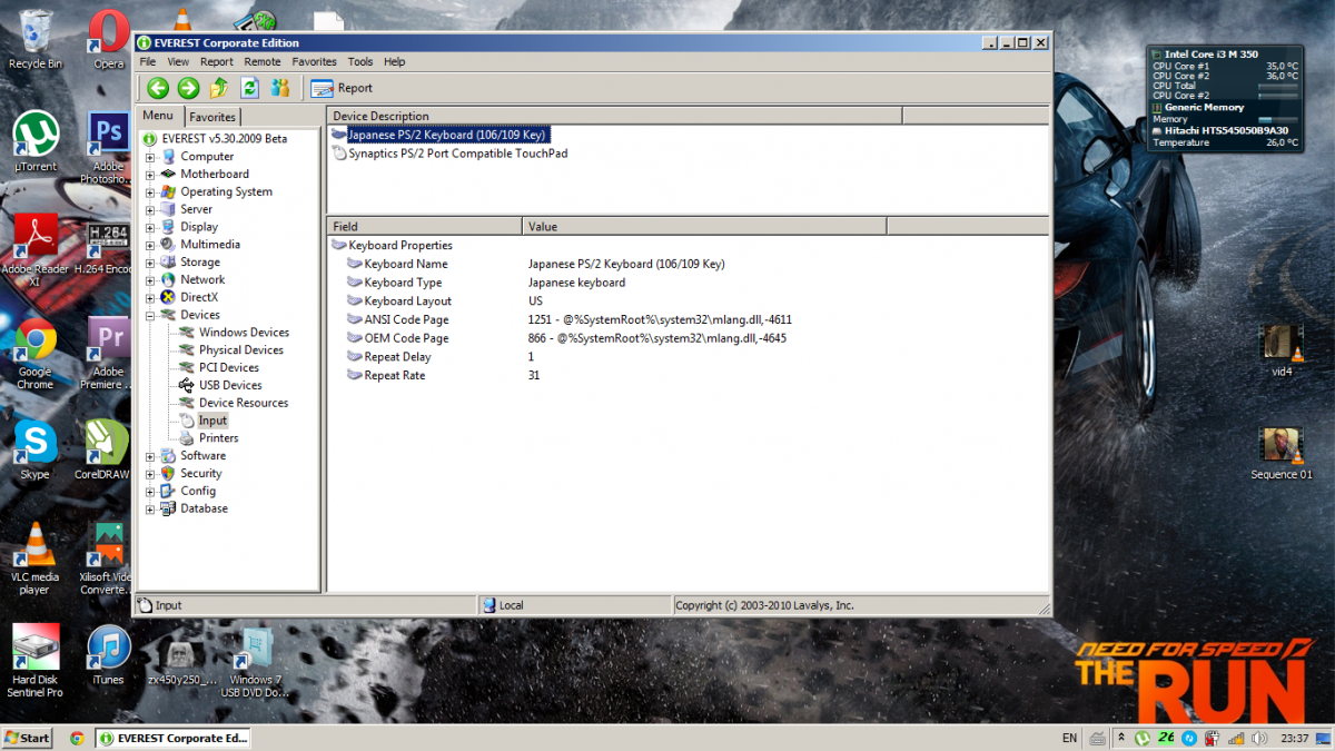

I'm installing OS X 10.8.5 on Fujitsu AH530. Here are the specs: boots up and load perfectly but when the language selection screen appears i can't move the cursor with the trackpad and also the keyboard is not working. When i plug in external usb mouse or keyboard they work fine. Do you know where is the problem? Do i have to install some kexts? I searched but i couldn't find any information about this laptop on the Internet so i'll appreciate any help!
I don't use the trackpad very often, because i use a mouse so it is not such a big deal if it's not working. But the keyboard is very important because i can't use usb keyboard with my laptop. Here are two screenshots from everest:
