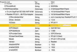

Thank you Andy for the really great work.
Please explain it out exactly where in which string I can change the MAC address.
where in the info.plist ?
Thank You
In the Info.plist mod the IOMACAddress key.
Change it to any MAC address you want ;)
By default it has an Apple MAC Address set.
Thank You
If one's not too lazy to search for a sec it's just some clicks. ^_^
IOKitPersonalities ➜ D-Link GigaFast... ➜ IOMACAddress
IOKitPersonalities ➜ Realtek RTL81111... ➜ IOMACAddress

Do you change here or where? in RealtekRTL8111.kext - Show Package Contents, and then click Content in info.plist
<string>RTL8111</string>
<key>IOMACAddress</key>
<data>
fH34KJ4j
</data>
I do not understand the correct MAC address of en0 I see in Sytemprofil is much longer and another as here.
<data>
fH34KJ4j
</data>
Use Xcode / PlistEdit Pro for editing.
The type is data so that mean base64 encoded.
