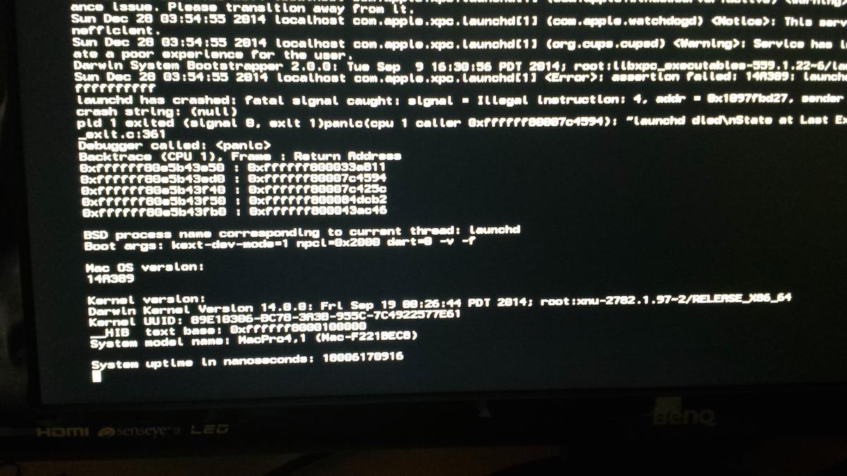

noxar Posted December 26, 2014 Share Posted December 26, 2014 Salve, ho fatto la procedura per installare yosermite su un hd usb, usando Chamaleon, l'installazione avviene con successo sull hd, nell'avvio del sistema va in errore, vi posto il mio smbios e ocb e vi allego la foto dell'errore, se qualcuno può darmi una dritta grazie. smbios <dict><key>SMbiosvendor</key> <string>AppleInc.</string> <key>SMbiosversion</key> <string>MP31.88Z.006C.B05.0802291410</string> <key>SMboardproduct</key> <string>Mac-F42C88C8</string> <key>SMfamily</key> <string>MacPro</string> <key>SMmanufacturer</key> <string>AppleInc.</string> <key>SMproductname</key> <string>MacPro3,1</string> <key>SMserial</key> <string>G8135543XYL</string> </dict> </plist> OCB <key>EthernetBuiltIn</key> <string>Yes</string> <key>GenerateCStates</key> <string>Yes</string> <key>GeneratePStates</key> <string>Yes</string> <key>Graphics Mode</key> <string>1920x1200x32</string> <key>GraphicsEnabler</key> <string>Yes</string> <key>Instant Menu</key> <string>Yes</string> <key>Kernel</key> <string>/System/Library/Kernels/kernel</string> <key>Kernel Flags</key <string>kext-dev-mode=1</string> <key>SMBIOS</key> <string>/Extra/smbios.plist</string> <key>SMBIOSdefaults</key> <string>Yes</string> <key>Theme</key> <string>LoginToLion</string> <key>USBBusFix</key> <string>Yes</string> <key>UseAtiROM</key> <string>Yes</string><key>device-properties</key> <string>450000000100000001000000390000000100000002010c00d041030a040000000101060000197fff0400160000006200750069006c0074002d0069006e0000000500000001</string> </dict> </plist> Link to comment Share on other sites More sharing options...

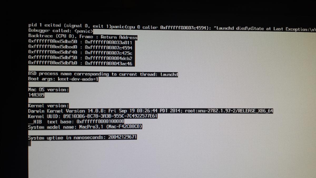

Fabio1971 Posted December 26, 2014 Share Posted December 26, 2014 Avvia con -v e posta una foto Fabio 1 Link to comment Share on other sites More sharing options...
noxar Posted December 26, 2014 Author Share Posted December 26, 2014 Ho allegato l'immagine Link to comment Share on other sites More sharing options...
carbo178 Posted December 26, 2014 Share Posted December 26, 2014 Se davvero usi smbios MacPro 3,1 prova ad eliminare le stringhe relative all'smbios in ocbp, perchè risulta caricare MacPro 6,1 Link to comment Share on other sites More sharing options...
noxar Posted December 26, 2014 Author Share Posted December 26, 2014 potrebbe essere solo un errore di smbios non corretto? Perchè stò provando vari smbios ma va in errore sempre allostesso punto Link to comment Share on other sites More sharing options...
carbo178 Posted December 26, 2014 Share Posted December 26, 2014 Elimina: SMBIOS/Extra/smbios.plistSMBIOSdefaultsYes Le specifiche del sistema non sono quelle in firma, vero? Link to comment Share on other sites More sharing options...

carlo_67 Posted December 26, 2014 Share Posted December 26, 2014 se fai boot dalla usb parte? se parte prendi Extra della usb e mettila nella root del sistema prima prova un avvio con queste flag -v -f UseKernelCache=No PS: se ci dici l'Hardware sarebbe anche meglio Link to comment Share on other sites More sharing options...

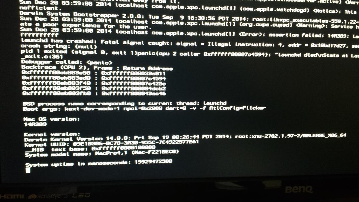

carlo_67 Posted December 27, 2014 Share Posted December 27, 2014 metti questa Extra nella root (decomprimila prima) poi istalla ultima versione di Chamaleon senza selezionare nulla istalla questi con kext wizard e fai anche manutenzione avvia con flag -v -f se non va prova flag -v -f AtiConfig=Flicker rispetta spazi e maiuscole Extra.zip cartella senza titolo 2.zip Link to comment Share on other sites More sharing options...

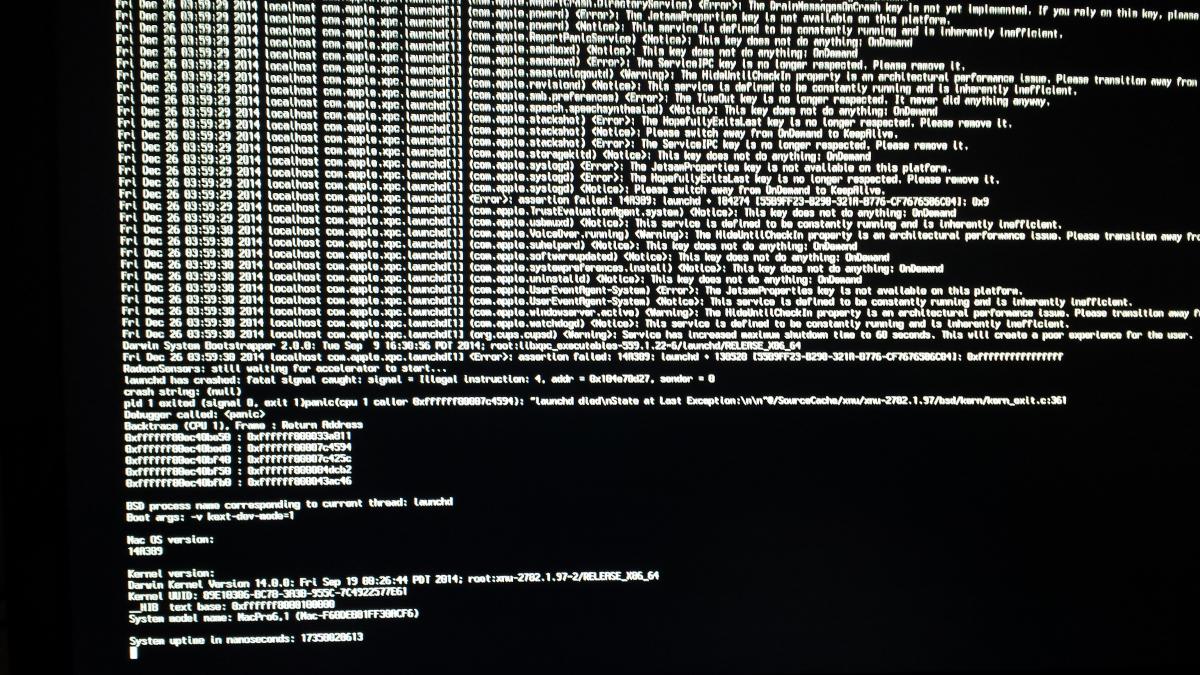

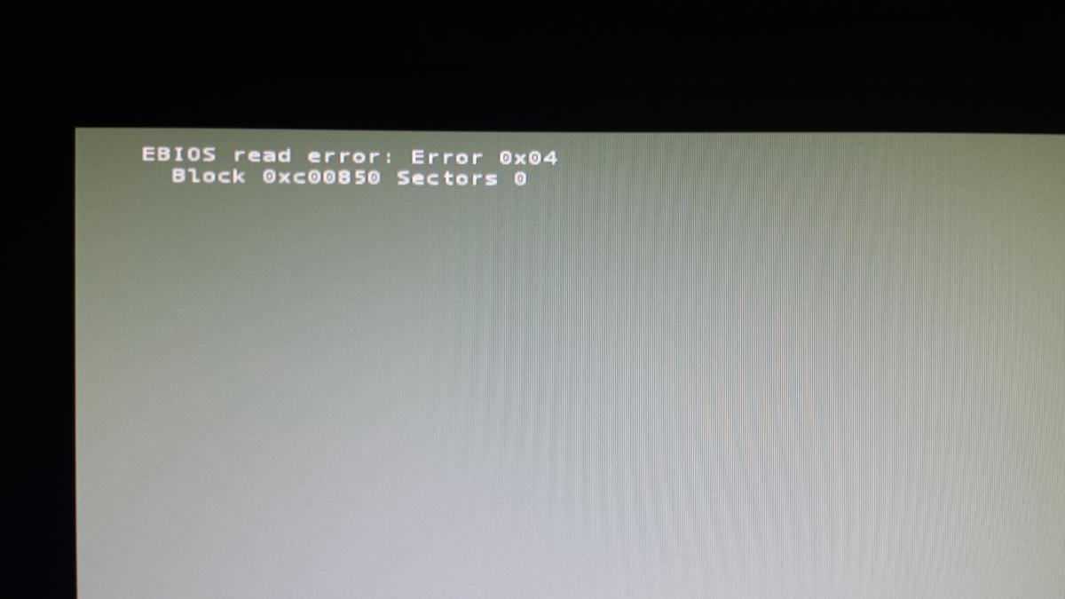

noxar Posted December 28, 2014 Author Share Posted December 28, 2014 niente da fare si blocca sempre ti allego le immagini, se tento di far partire con -x esce l'errore dell'immagine 3 Link to comment Share on other sites More sharing options...

JahStories Posted December 28, 2014 Share Posted December 28, 2014 Ciao Noxar, prova a scollegare tutto tranne il drive con installato Yosemite, con tutto intendo anche scollegare i vari device usb oltre che dischi non utilizzati.... se così non dovesse andare, il drive che usi potrebbe essere danneggiato e dovresti provare con un altro. questo dettato dal fatto che ti da' l' EBIOS read error Good Luck! P.s. puoi anche provare a cambiare la porta sata Link to comment Share on other sites More sharing options...
noxar Posted December 28, 2014 Author Share Posted December 28, 2014 il disco in questione e un usb drive, non credo che sia un errore hw, sicuramente il problema e solo a livello configuartivo Link to comment Share on other sites More sharing options...
